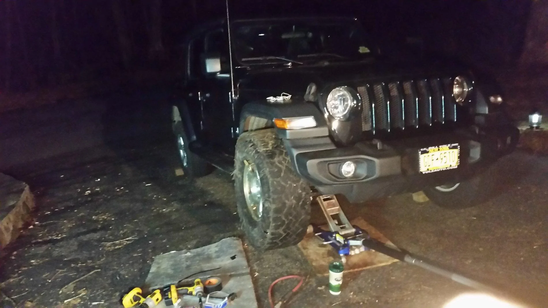

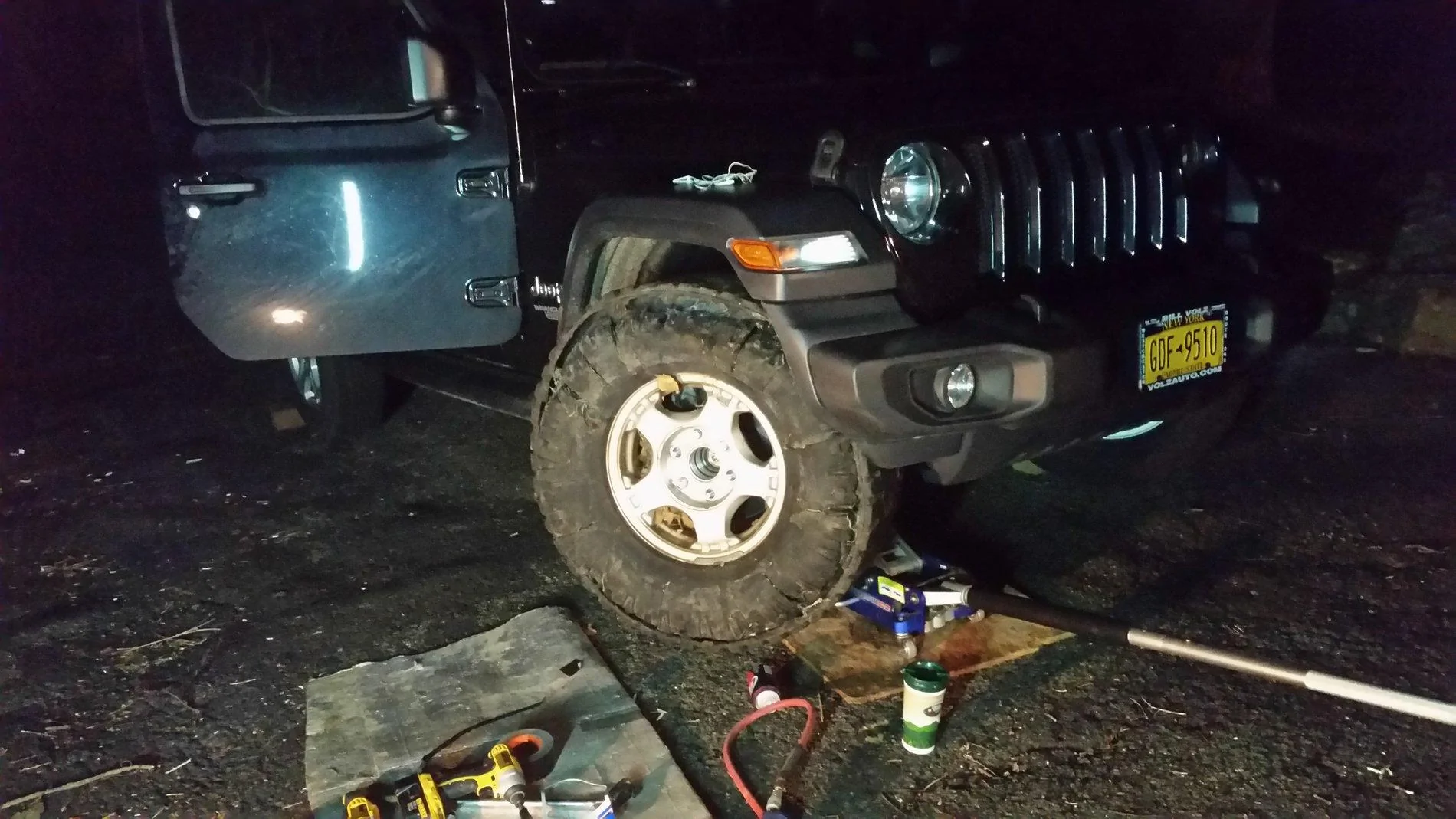

Yup. I did a test fit in my driveway of a wheel and tire (same size but factory rim with blown tire). They will stick out but I'm fine with how much. I'm going to go with aftermarket flat fenders. Clearance will be good all around.
