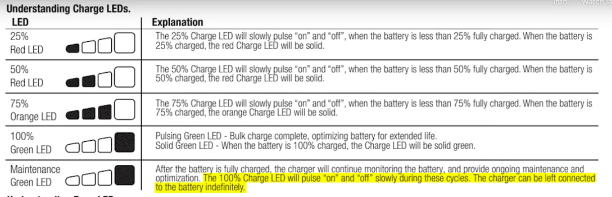

The pulsing green light indicates that a float/maintenance charge is being applied. It should be perfectly fine sitting a couple months like that.
