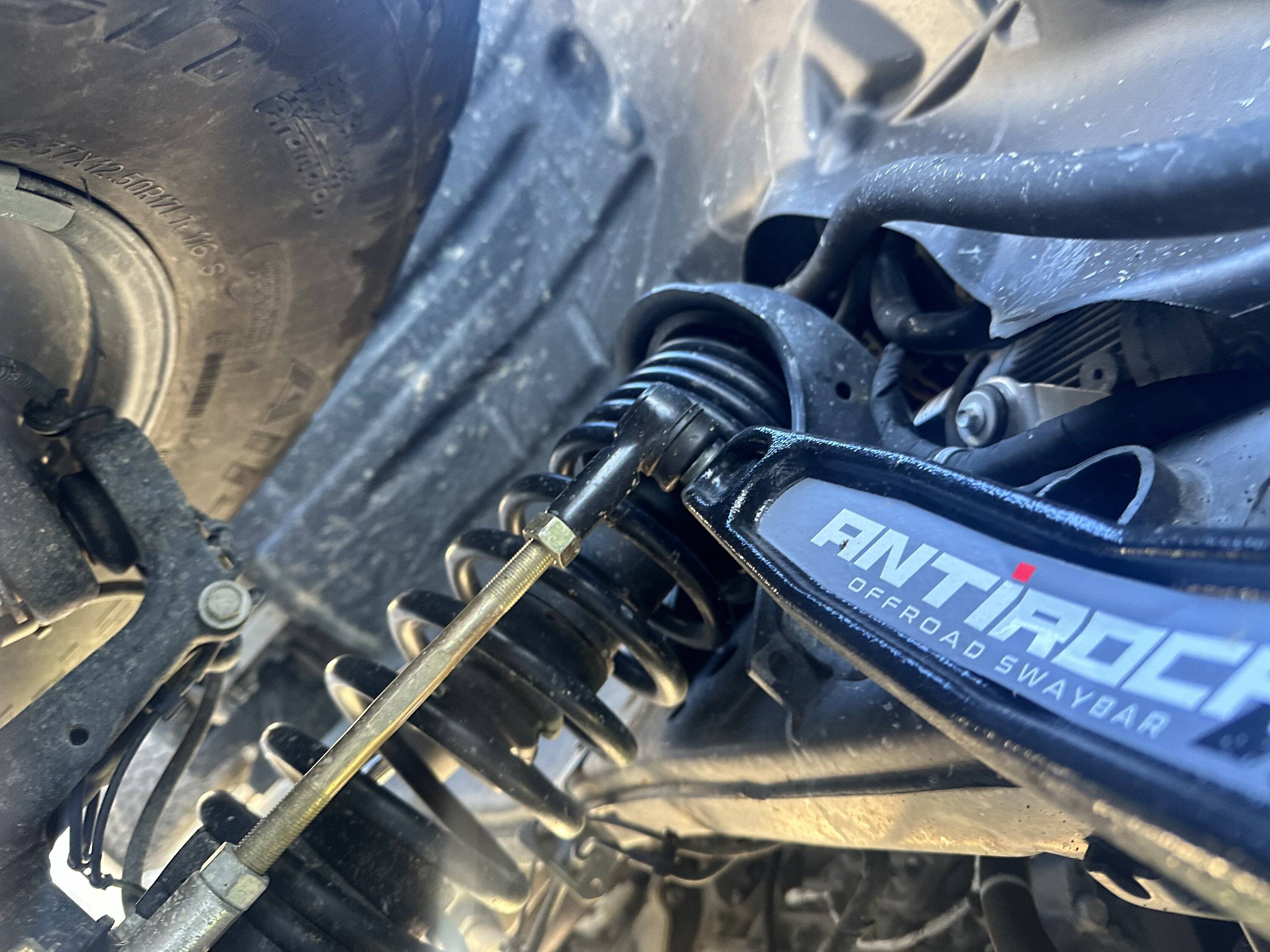

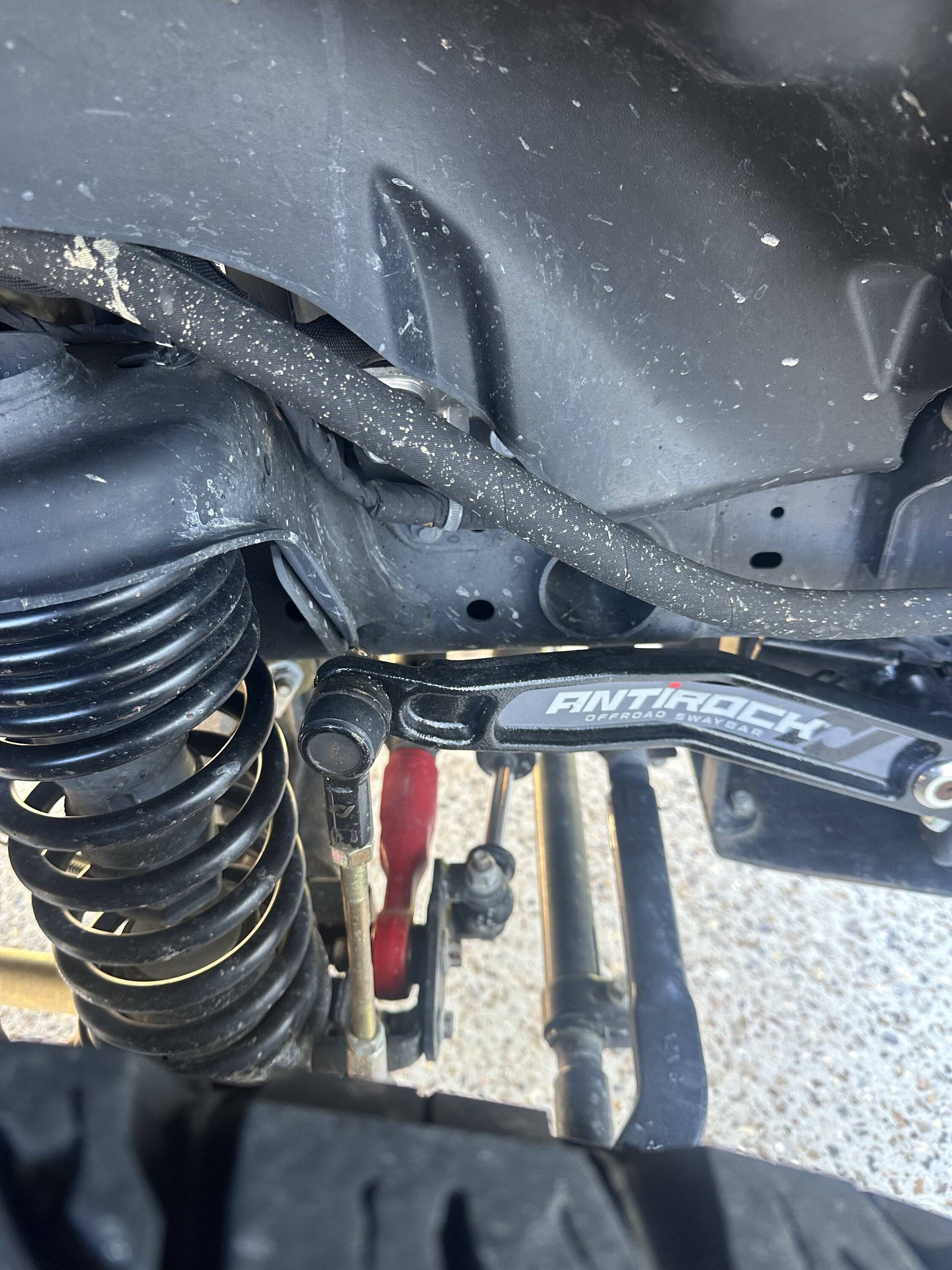

How long are your antirocks links on the front? Do they interfere with the 2.5 hoses at full squish?
What length shocks do you have?

Whatever length they come. I havent noticed any hitting. I did Alpine loop, poughkeepsie, imogene, ophir with no issues. Could be touching at full flex. Idk. Shock are the fox 4-6 inch. 30.5” extended i believe.
Jeep Wrangler JL SDI eclik vs. FOX 2.5 IMG_6127
Jeep Wrangler JL SDI eclik vs. FOX 2.5 IMG_6128

Awesome. Really appreciate the pics and time! Excited to get mine on!
