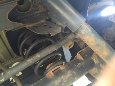

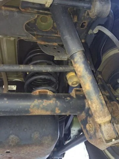

I'm currently hellbent on keeping my inner frame clean on my '17 JK. Glad to hear yours held up great with proper upkeep. Did you ever try coating the inner frame on your JK?
Years ago I bought a used 7yr old Rubicon. It being my 2nd ever Jeep purchase, I didn't realize rust was such an issue on Jeeps (as my first was clean) so I didn't check the undercarriage. It was soo shot, looked like a 25 year old vehicle, but the body was fine. I eventually sold it and made sure all my following Jeeps were rust free.
I'm a complete psycho when it comes to road salt + mud. Love to wheel, always wash it immediately after wheeling. I lay in my icy driveway cleaning my undercarriage if I get salt on my Jeeps. Neighbors probably think I'm pathetic. I do preventative upkeep every spring. The first year of owning my current JK I still had my old Jeep as well, so I never exposed the JK to winter conditions since it was brand new. I plan to keep the JK forever, so I'd love to know your experience on what areas seemed to need the most attention keeping clean&coated year after year. Thanks :beer: :flag:When I eventually buy a JL i'll be the same, but the build quality of JLs is so much better than the JK, I bet it'll hold up better to mud and winters.
The inside of my frame looks great. All I've done to it is religiously wash it out through the vent holes, sometimes with soapy water, sometimes just plain water.
