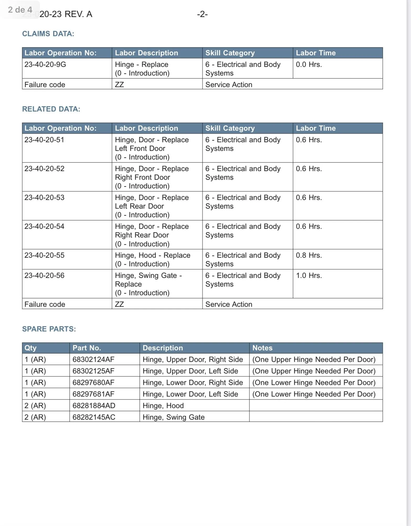

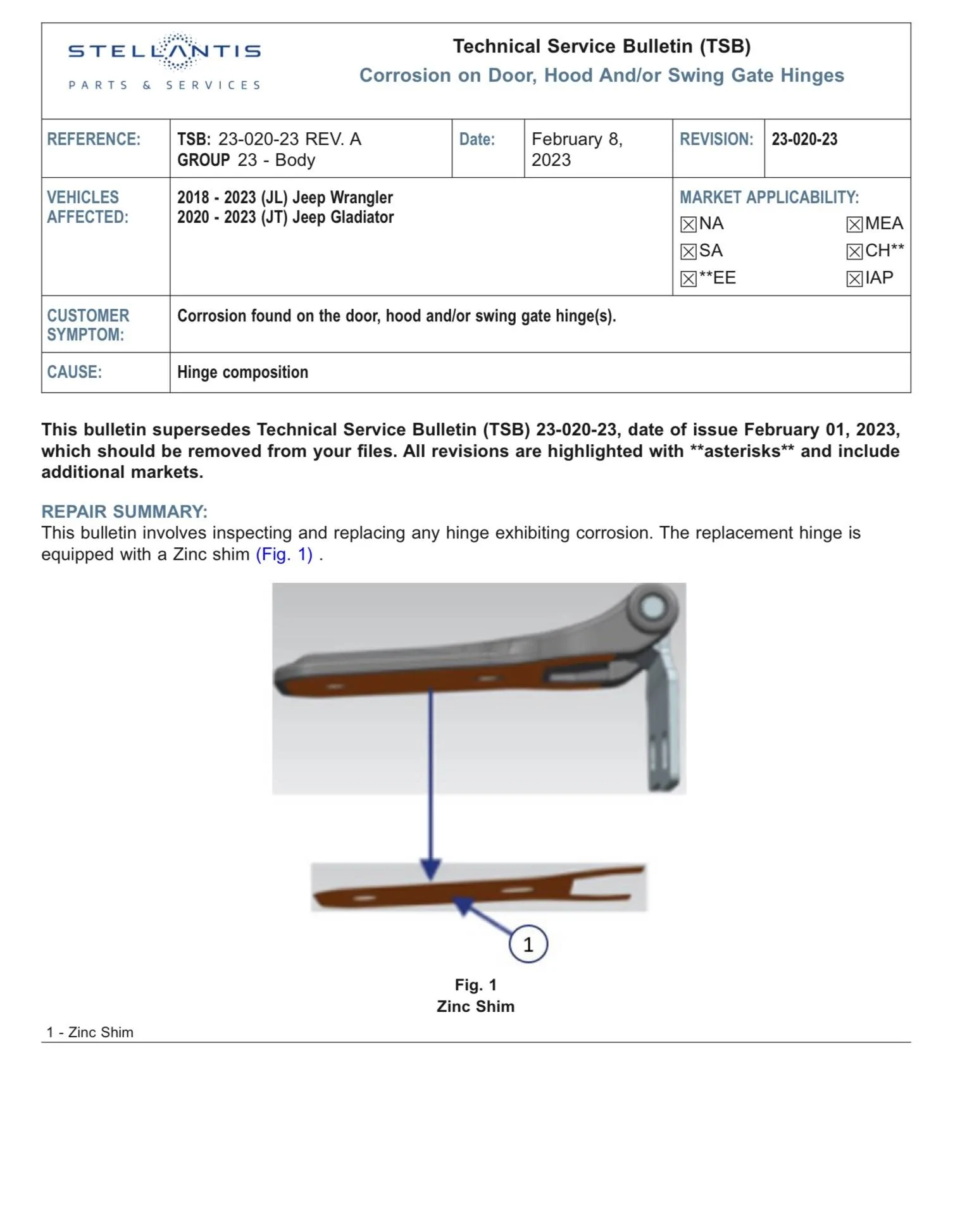

Hello, has no one in Europe had rust problems on the door hinges?

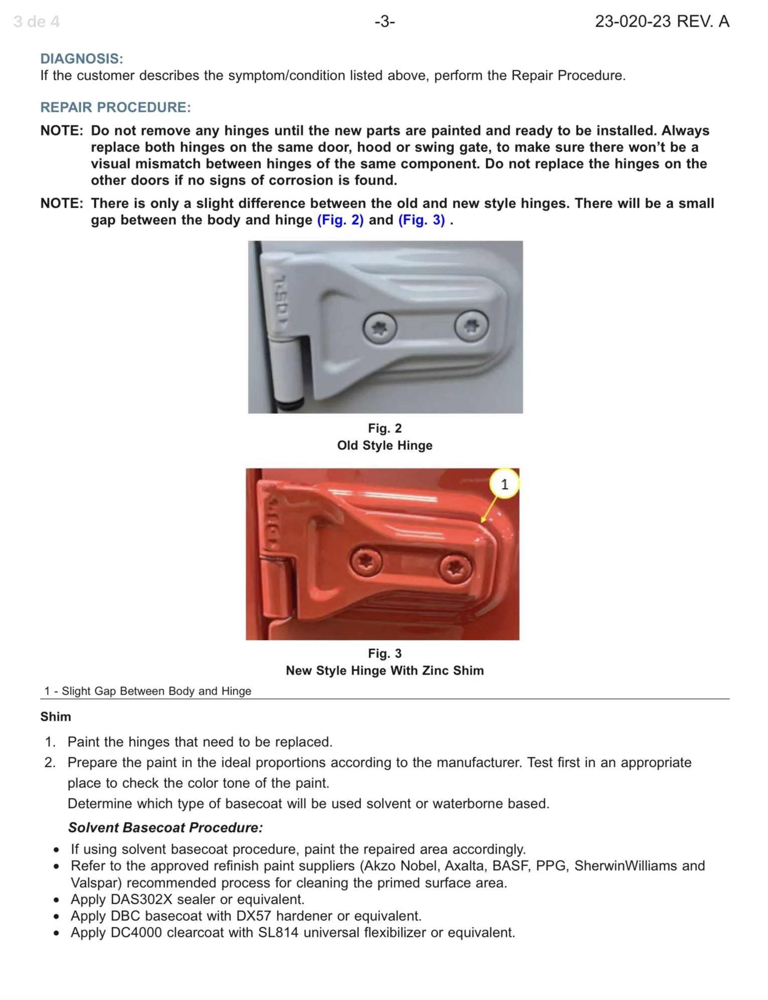

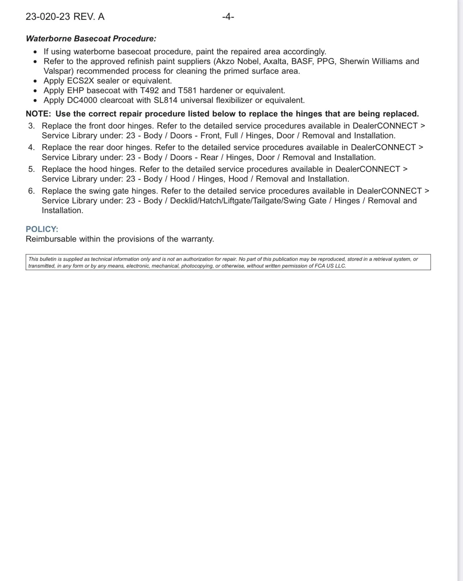

Yes, my 2019 JL just had 2 new doors, new hinges with upgraded shims. Total 7k under warranty, but I had to fight with Jeep care, all sorts of threats about small claims court. My hinges had bubbling, and some minor bubbling on the bottom inber door hem flange.
