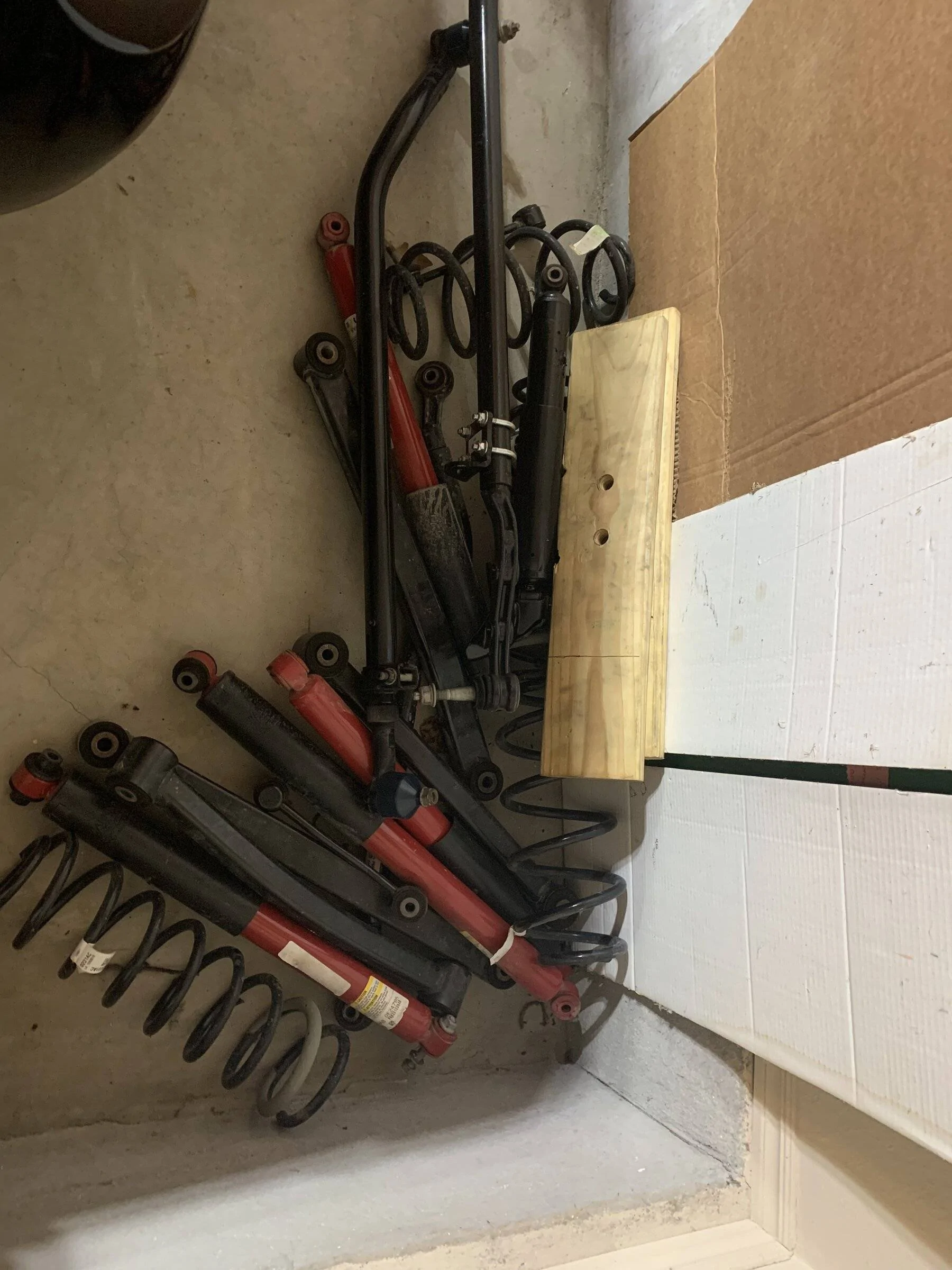

Hey Nyles, cover the freight and you can have some of my lift take-offs. They saw maybe 1,000 miles at best before I lifted. Call me a hoarder but I kept the springs, shocks and linkages for no real reason other than to help a fellow Jeepster out if need be. They’re in the corner of my garage so it’s not like they’re in my way. As others have said, springs and shocks will do the trick.

I am still trying to make sure the springs and the front shocks I got are going to actually help me out. I would hate to pay to have them all installed and it really be basically the same stuff I have on already!
In hindsight I see that I overpaid for the parts and should've remembered the "Buy once, Cry once" motto!
I might hang on to the shocks and springs and try to sell the other parts or just give them to someone who needs or will use them.
