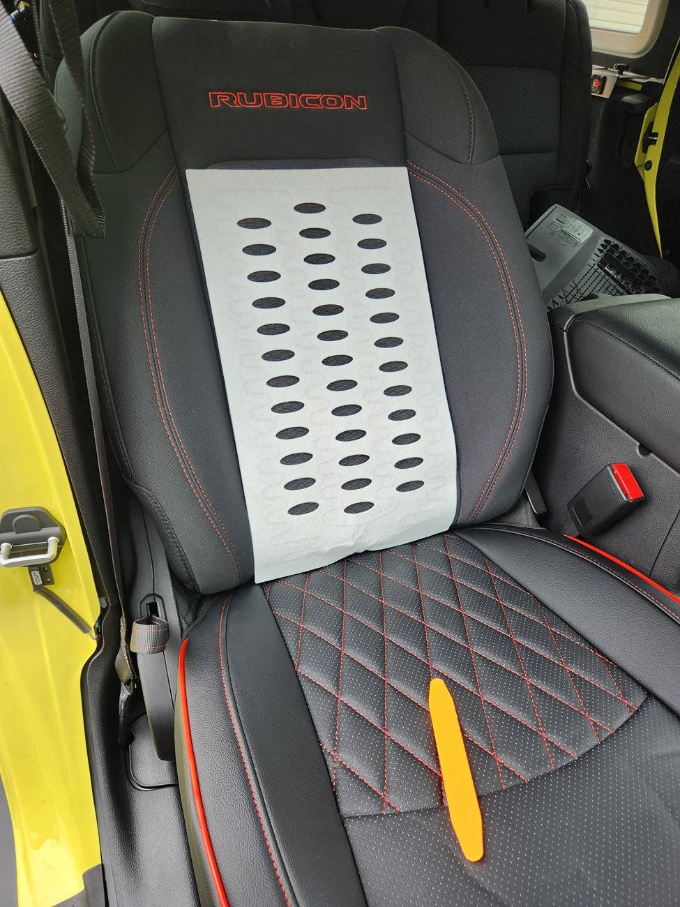

I ordered and installed seat covers from Auto Seat Zone for my new 2023 4dr Rubicon. I upgraded to have "Rubicon " on the front seat backs like my factory cloth seats. Before I installed them this was a perfect time to add heated seat pads I purchased on ebay for about $35.
I used AUX 2 (40amp) for the seats as each seat comes with a 15 amp fuse. I installed the two 20mm round switches on the front of the center console and ran the wires through a hole I drilled in the bottom corner. The seat covers look Great and fit tight. I think they look like the upgraded factory ones. Took a little over 2 hrs to install the covers. The rear 60/40 take more time than the front. The heated seats have a hi/low setting and work great.
