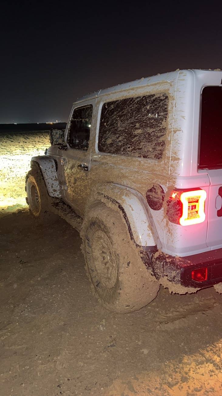

So I have 35” tires on my 2 door Sahara and I experience rubbing or at times even banging on the rear fenders when off-roading at moderate speed. I even once broke a couple of clips as you can see from the attached photos. I’m planning on getting a 2.5” teraflex lift kit with falcon SP2 2.1 shocks. Would that be good enough to stop the issue? If not are there any rear fenders with an OEM look that give more clearance?

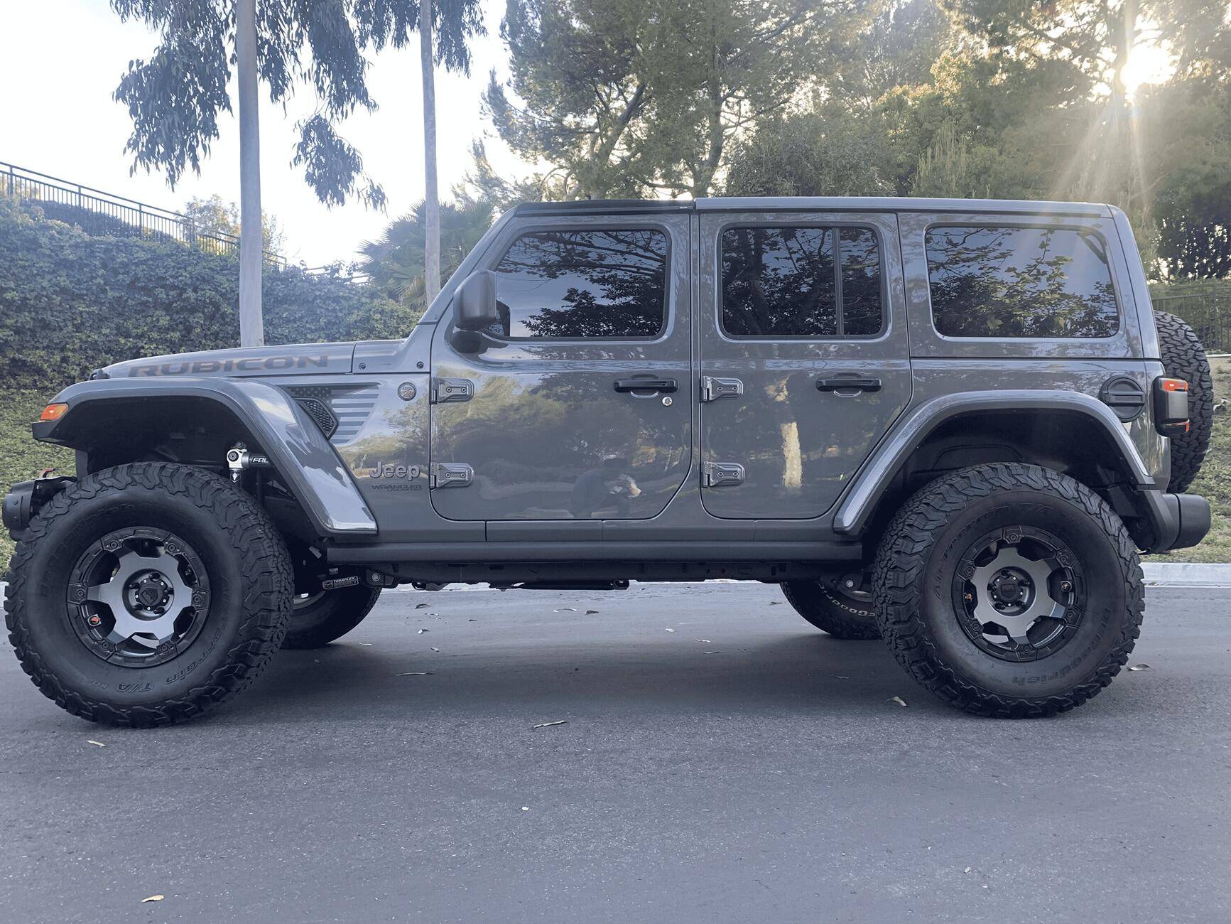

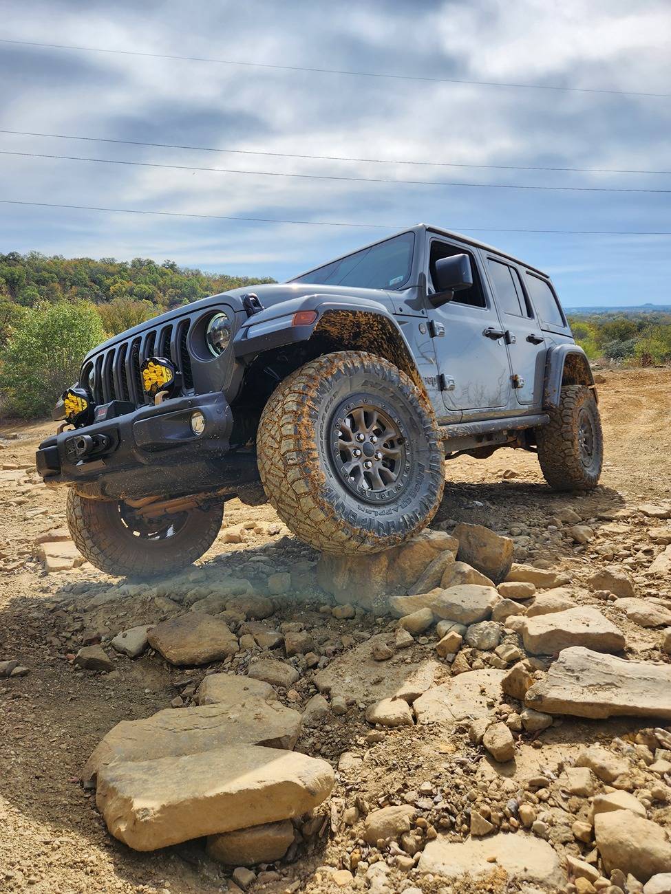

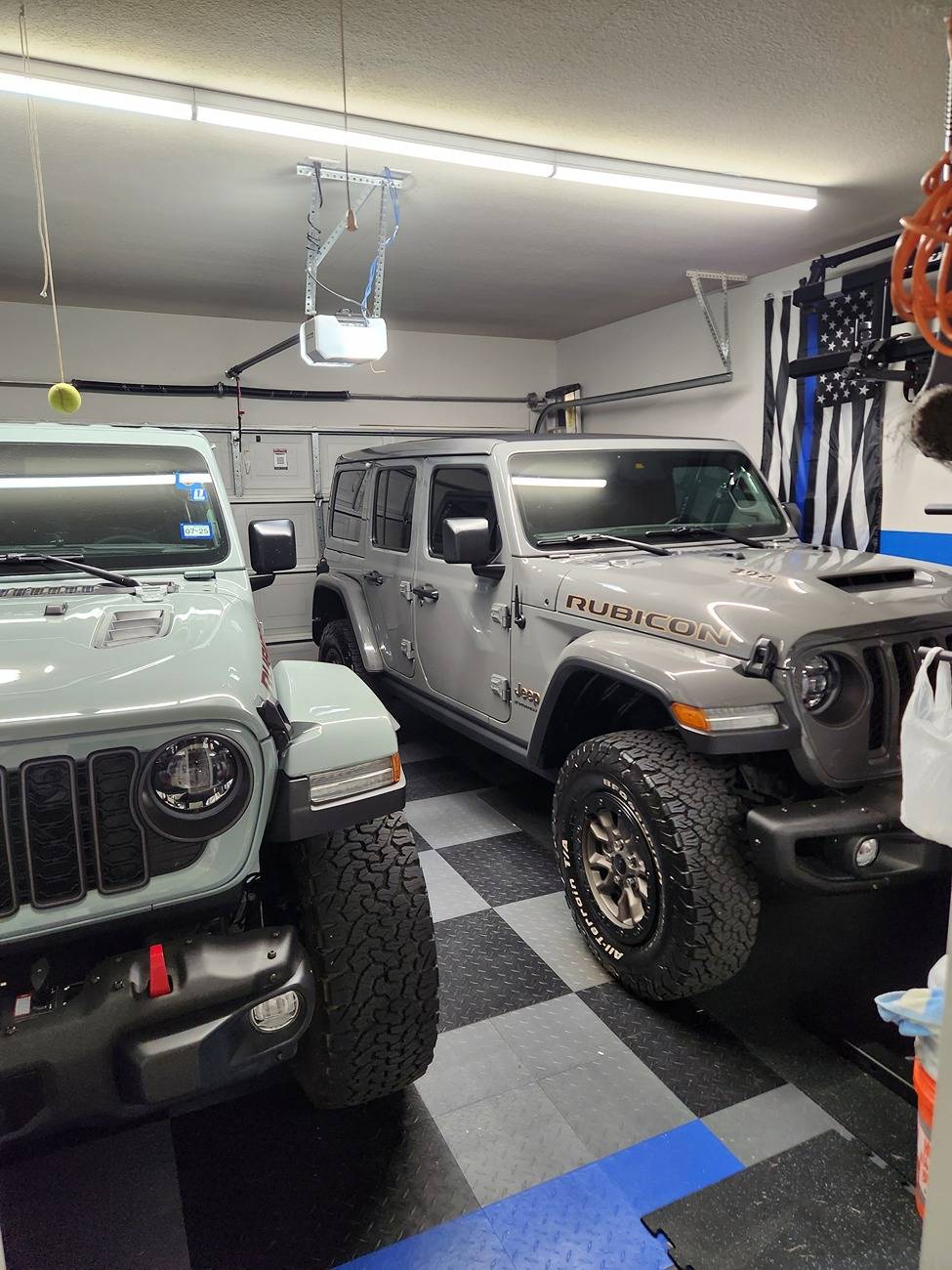

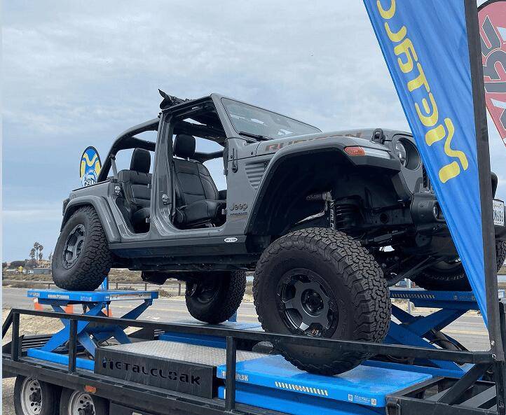

Here is mine with a TeraFlex ST2 and 37s:
Jeep Wrangler JL Rubbing/hitting rear fender with 35s 1726348943006-q4
Jeep Wrangler JL Rubbing/hitting rear fender with 35s 1726348960653-rd
