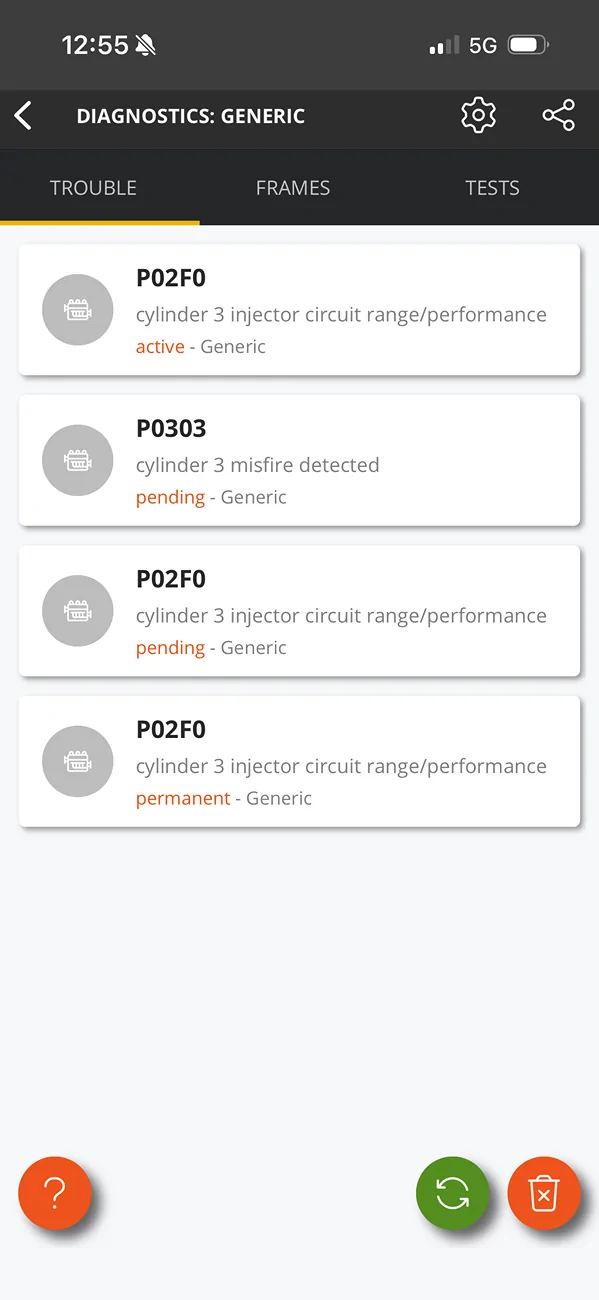

Good morning dear folks, happy New Year,
My big guy (2.0) runs relatively rough at idle when cold. I initially blamed it on the E85 in the tank (it’s been converted for that). When it’s cold, it doesn’t like it much. Sometimes I also get a yellow warning light, but that usually disappears after a few kilometers at the latest once there’s fresh E5/E10 in the tank.
This time, though, it didn’t — despite good fuel. So I fired up JScan and voilà: misfire on cylinder 3 and fuel injector circuit range/performance.
It still drives, but every now and then you notice a bit of hesitation. It never lasts long, just a few seconds, and once it’s warm there’s nothing anymore. Overall it runs a bit more “diesel-like” than you’d expect from the 2.0.
Spark plugs look good.
Any advice, or should I go ahead and order injectors already?

thanks for the reply. It was the pre-owner who spent close to 600 USD here in France for the flex fuel conversion at a specialized company. Although it ran smooth and normal, I didn’t use e85 much, just every now and then in summer (In winter I always questioned the cold start performance).
I didn’t know it’s that rare (in the US). I’ll probably check the injectors next. As I said: spark plugs looked good. Exhaust is good. When the engine is warm it runs smooth as always. Just when there was a cold start and I’m putting it too soon into “Drive” the engine sometimes stutters a bit and I give it another 5 seconds. But that’s also not on a regular base.
if anyone has an advice other than “you probably did a wrong conversion” I’m all open ears.

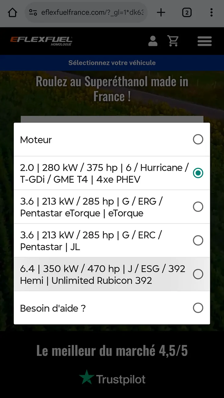

https://eflexfuelfrance.com/?_gl=1*dk63o7*_gcl_au*Nzg1MDk5MzA2LjE3Njc1MjY3MjQ.
This one is Eflexfuel on their French page, and as you can see they don't even offer this conversion for a 2.0T.

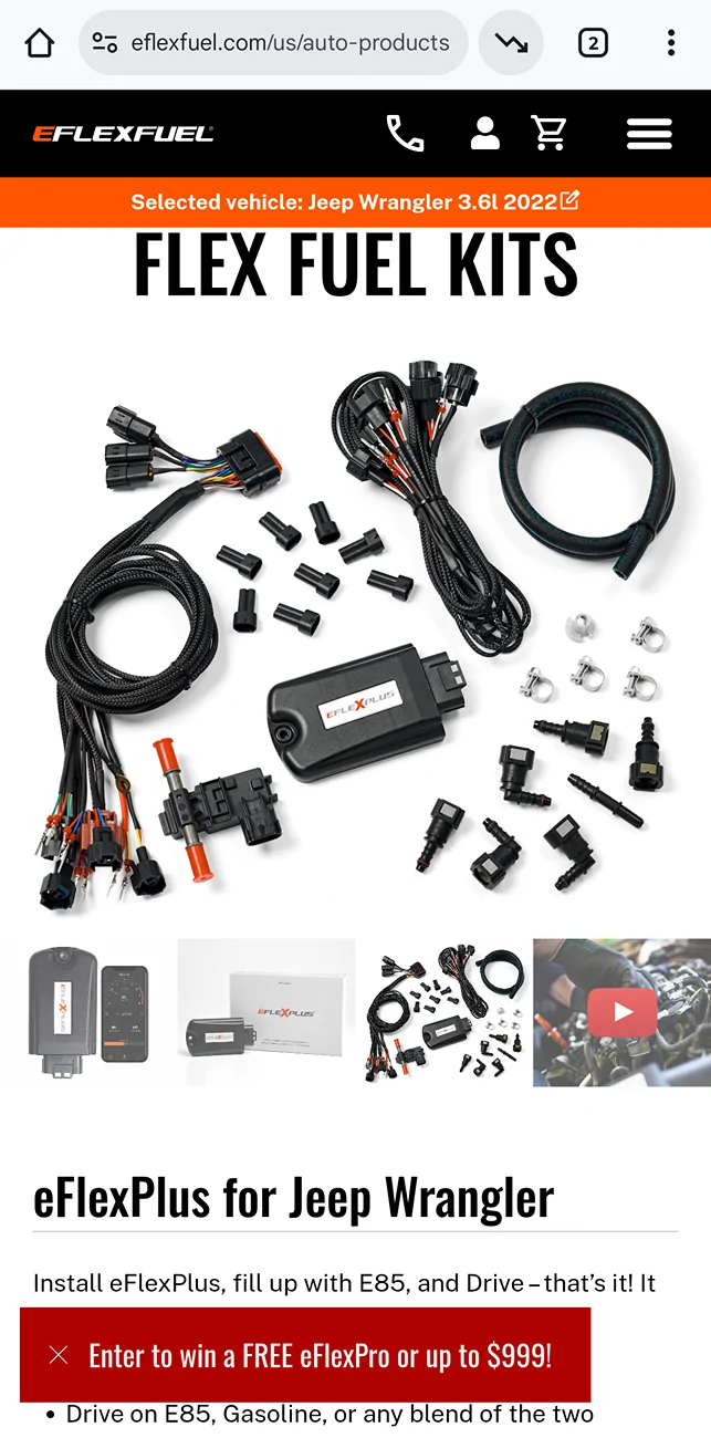

Jeep Wrangler JL Rough Idle P02F0 1000016856
This picture below is what a decent kit should look like, in this case it's the same Eflexfuel, but for the 3.6L engine, and again they don't make one for the 2.0T.
Jeep Wrangler JL Rough Idle P02F0 1000016857

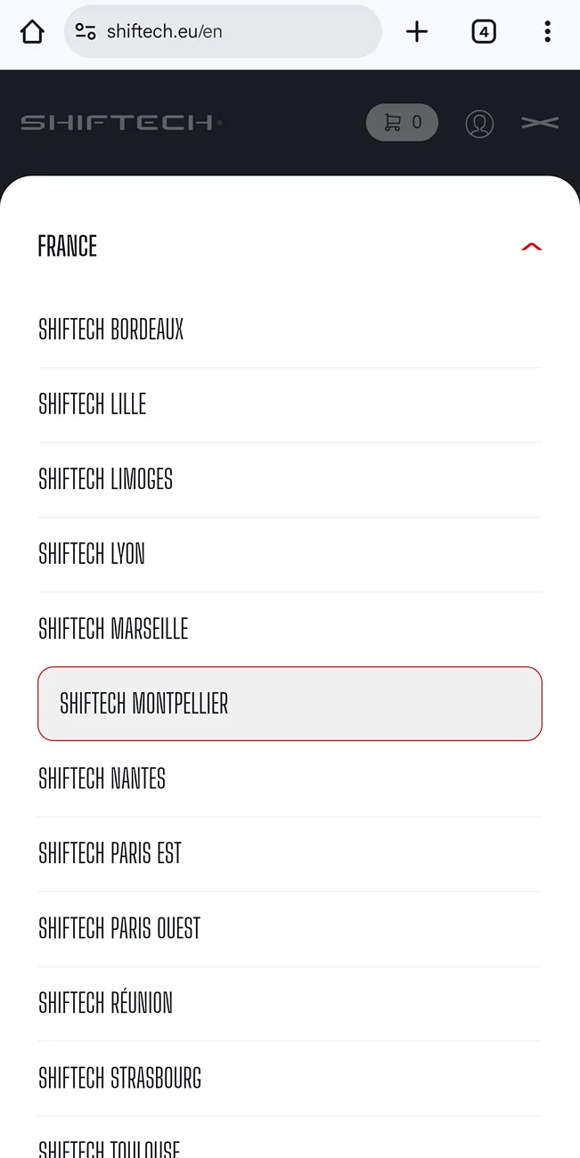

I will say as an added thought, that if you don't get the help you're looking for here, I would recommend going to a shop that specializes in these conversions. You may end up spending a boatload more money in the long run, but at least you'll have someone looking at your engine who knows what they're doing in relation to an E85 conversion.
Jeep Wrangler JL Rough Idle P02F0 1000016859
Shiftech seems to have a bunch of shops in France and per their website they're clearly used to working with E85 vehicles, in case it doesn't work out for you here, that is a possible lead for you.

Wow ! Thanks for the detailed reply. Appreciate it. I’ll reach out to the guys who actually converted /enhanced the engine/chip/mapping… but yeah I assume it’s been only an expensive software upgrade.
I’ll go ahead and go on error search and look at the injectors. I got a total of 88k km/ 55k miles on it… spark plugs look good.
It all started just after I came back from a 2 months vacation. Maybe the hydrophilic e85 damaged the injector when it was standing that long. Hope nothing worse.
the jeep still drives great but yeah, symptoms are clear: rough idle when cold, higher fuel consumption, a little more diesel like sound…
