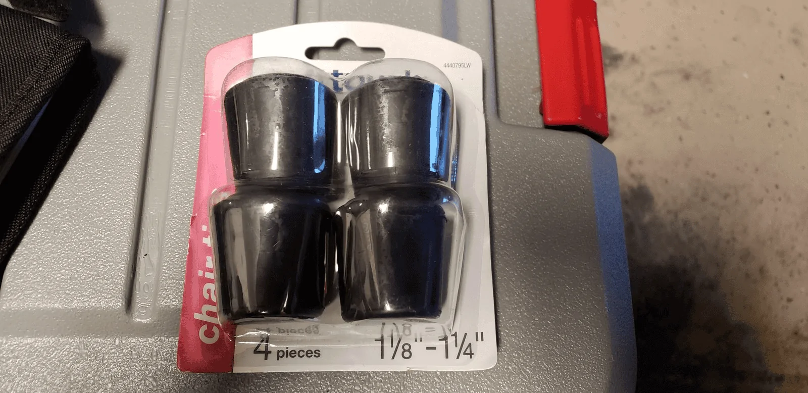

Good to hear. Im happy with mine so far. Only thing I need to address is tire is 1/2 inch from bump stop. Need to make some sort of spacer for a little more stability
Yep, had same deal. Another forum user shared these rubber chair feet below which I installed a few months ago. I was unsure at first but once installed they seem to fit perfect and solve the issue. Available at Lowes for very cheap!

I will have to check that out thanks
