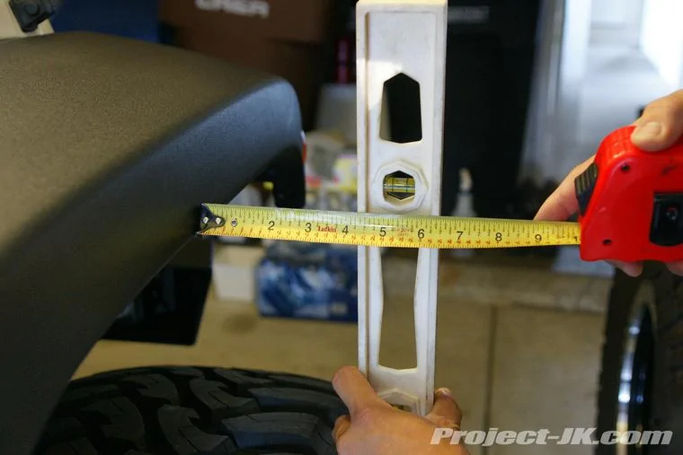

Hey Guys,
I just installed a Rough country adjustable track bar and i am having issues with the adjustment. If i measure from the face of the shock to the outside top of each tire my measurement is perfect, but if I measure from the face of the frame rail to the outside of each tire i am off by 3/4 to 1 inch. I also put a straight edge up on the face of each tire and measure the distance to the side of each fender and the measurement is perfect? am i doing something wrong?

Just put on the RC 3.5" lift on my wife's Jeep with adj. track bar and lower control arms. I could tell the axle was off center a bit, adjusted it while on the ground then tightened everything. I think it is pretty good but have an appointment Monday to get everything aligned. Rather take it to get an alignment than guess and "be close".

Use a level when measuring off the face of the wheel. I measured from the face to the fender.
