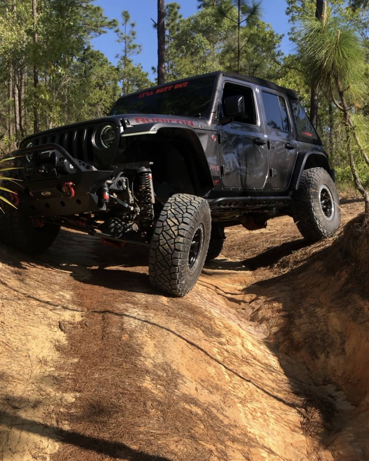

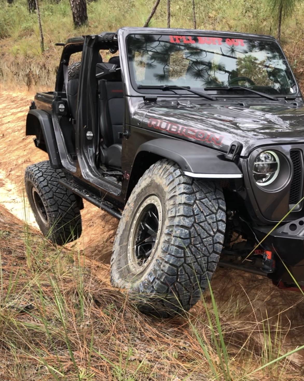

Sorry..... here’s the caffeine induced answer, lol......my answer is based on a few things.
@AccuTunedJL , is technically correct as always . But here’s my opinion......
Your post you said you were going from 2-3” to 3-4”, so that would mean you’ll loose about a 1/2” of up travel, but looking at the specs, it’ll be closer to an inch. Based on your location I assumed you wasn’t going to be bombing through the desert where more up travel is optimal. Ideally in a perfect world you’d like to stay in the middle of the stroke. But for highway driving and normal off-roading, climbing, crawling, off camber stuff, you’ll be fine with a little less up travel, imho.
Im running 4.5-6” lift fox resis with RK 3.5” springs, and I have almost 5” of up travel. That’s not great, but for what we do, droop is more important........
