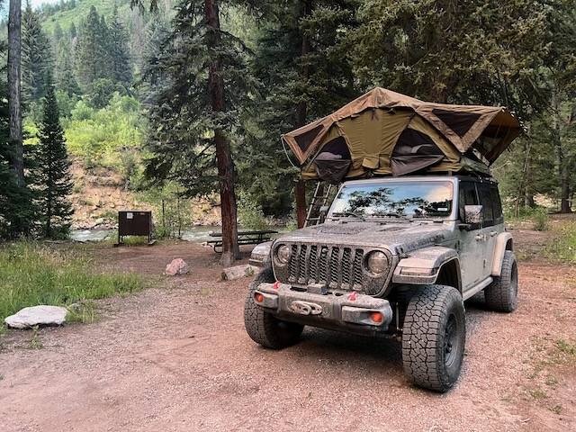

Don't run an RTT with just the bars on the rain gutter. You will definitely break it.
This is not a true statement 100%. I have been running Exposed Racks and a 147 lb. RTT and have had zero issues. You have to make sure you get the correct setup if you are doing it this way. Do my rain gutters look like they're broken?
