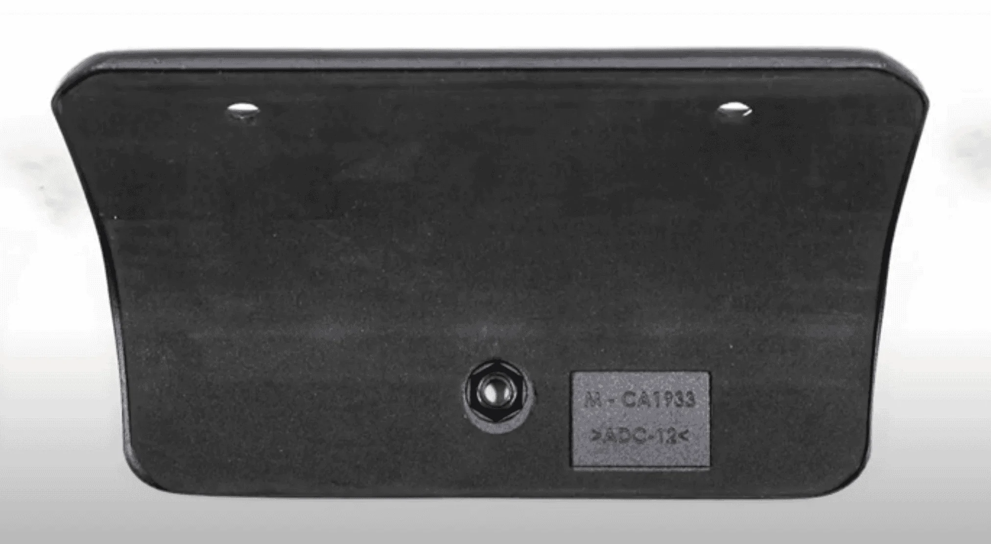

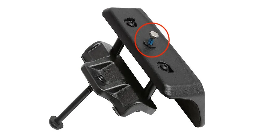

Screenshot from their video seems to show an embedded (?) nut. Hard to believe the nut would strip this way.

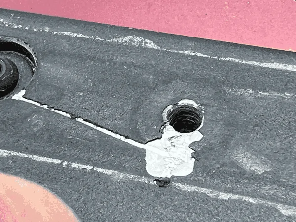

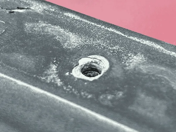

Some closups of the stripped holes, doesn't seem like there's a nut in there. Seems like the threads that got stripped are in the actual base.
Jeep Wrangler JL Rhino-Rack Backbone - stripped threads IMG_1605 600
Jeep Wrangler JL Rhino-Rack Backbone - stripped threads IMG_1606 600

If you look directly down through it, the threads are stripped all the way down?
I don’t thinkyou’ll be able to tap it - likely not enough meat plus the tap will run into the hard top before you get all the way through.
Seems like replacement bases might be in order.

Thanks I ordered the new replacement bases, they came in. I’ll have to get some butyl rubber paste for sealant then I’ll replace them
