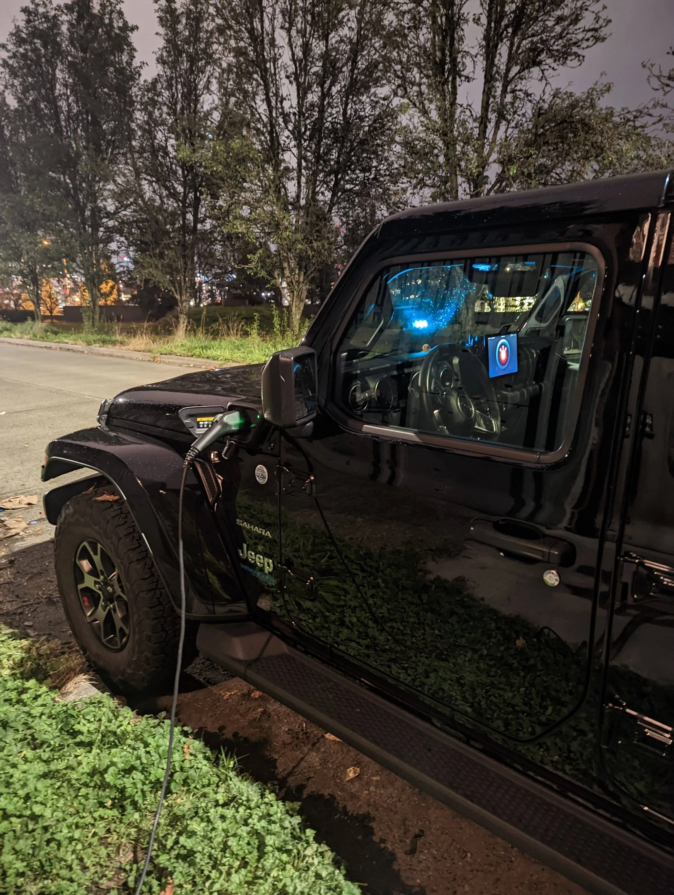

Nice. I just got my Pi talking to my 4xE earlier this past weekend. I am not connecting to the C network out of safety concerns for now, but I can read from the IHS network fine. If there was a way to physically disable transmit I might connect to both.
Mostly I just want to augment or replace UConnect since it's kinda shit and will never do all the things I want. Also actual security for the Jeep since the area isn't the safest. Currently Gnome wallpaper is my defense. Since my threat model is the chemically challenged that works, but it could be much better.
I am thinking I leave the doors unlocked but the stereo blasts at full volume if the doors are opened, and I am yards away. Better doors unlocked and someone scared away than a broken window. I had my Sahara less than a month before that happened the first time, and I had nothing but hand sanitizer inside. Was driving around in November with plastic over the window and glass everywhere.

Also, the charge controller seems to keep the 12V battery topped up, so knock yourself out when it's plugged in. You might want to confirm it with your own testing before a road trip or something, however.

Working on a small rust library to listen to and parse events. Right now only remote control events are implemented but the rest is just a matter of data entry. I'll publish it once it's a bit more useful. It has tests and a command line tool, but I'm writing a UI as well in a separate crate. Wireframing for that is in progress.
On a road trip RN and the "security system" has been super useful in less secure parking locations. People see "sentry mode" and avoid. Soon it won't be fake. Cameras, entry detection, and an alarm to make intruders reconsider their life decisions.
Added a hotspot as well. There's plenty of room behind the glove box for an old phone and a battery pack. F**k AT&T and Sirius XM Guardian. They won't see a dime from me. They want how much per GB? LOLno. Google Fi FTW. Unlimited data sims!
