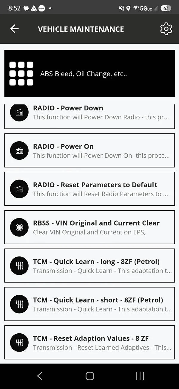

Just used jcan for grar ratio and tires.
Wanted to do a relearn of my tcm and wanted to confirm settings.
Tcm quicklearn long or short? I was thinking long.
6 gear relearn is just getting unto 6th and holding it there for 20 secs correct? Is this automatic after starting the learn process?
Is it just easier to disconnect battery for 30 mins and call it a day?
