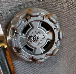

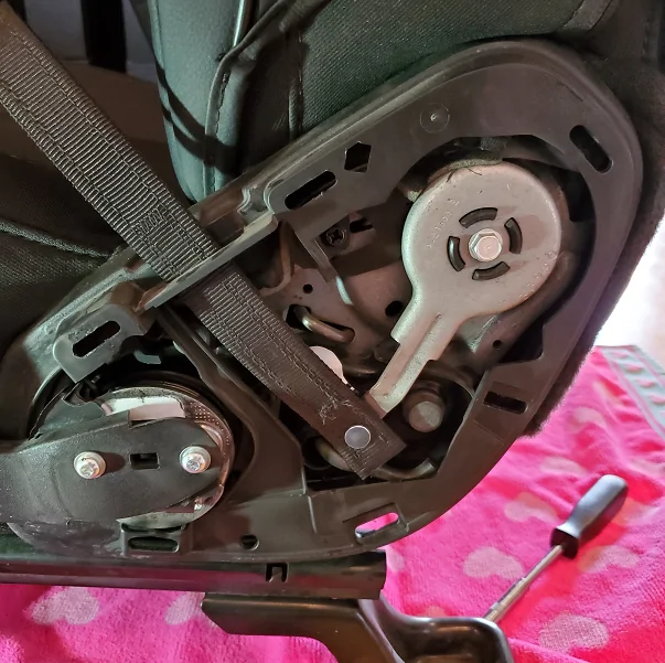

I’ll be replacing my driver seat cushion tomorrow. I have a manual control seat and I’m curious how to remove the knob and lever. It may be pretty obvious once I take the seat out. Thanks in advance for any help.

you can pop up the cap.
Jeep Wrangler JL Replacing driver seat cushion. 1760534737729-34
Jeep Wrangler JL Replacing driver seat cushion. 1760534753594-y8
As for the lever you need to remove the screw, two per side if I recall properly and there is some clip
Jeep Wrangler JL Replacing driver seat cushion. 1760534916245-ra

got it done your pics was all i needed. much more comfortable
