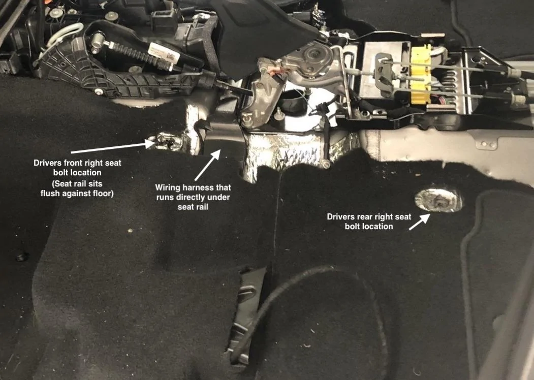

Haven't seen any lower brackets yet unfortunately. The holdup is that there is no elevation/bracket on the front right bolt location - the seat rail bolts directly to the floor/side if the transmission tunnel. Directly behind this is a wring harness that is a snug fit with the stock bracket location.
Hopefully someone comes up with a clever way to overcome this.
