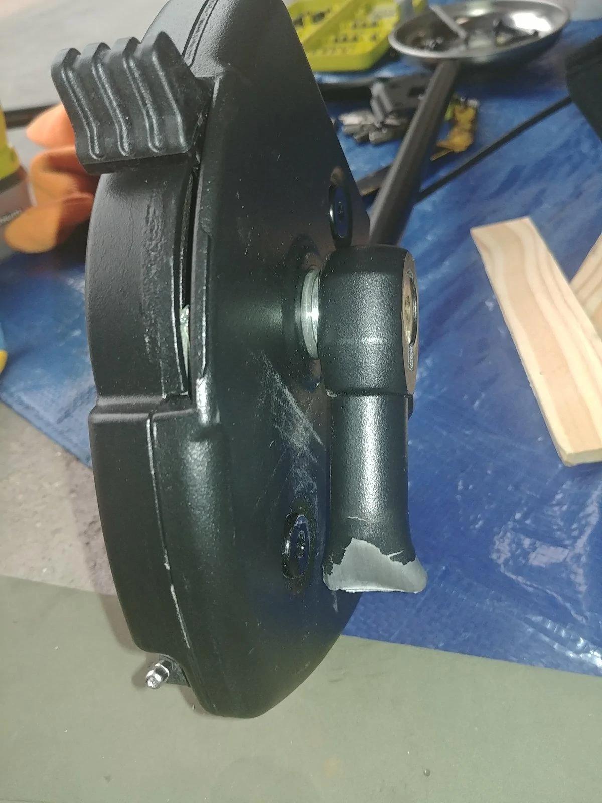

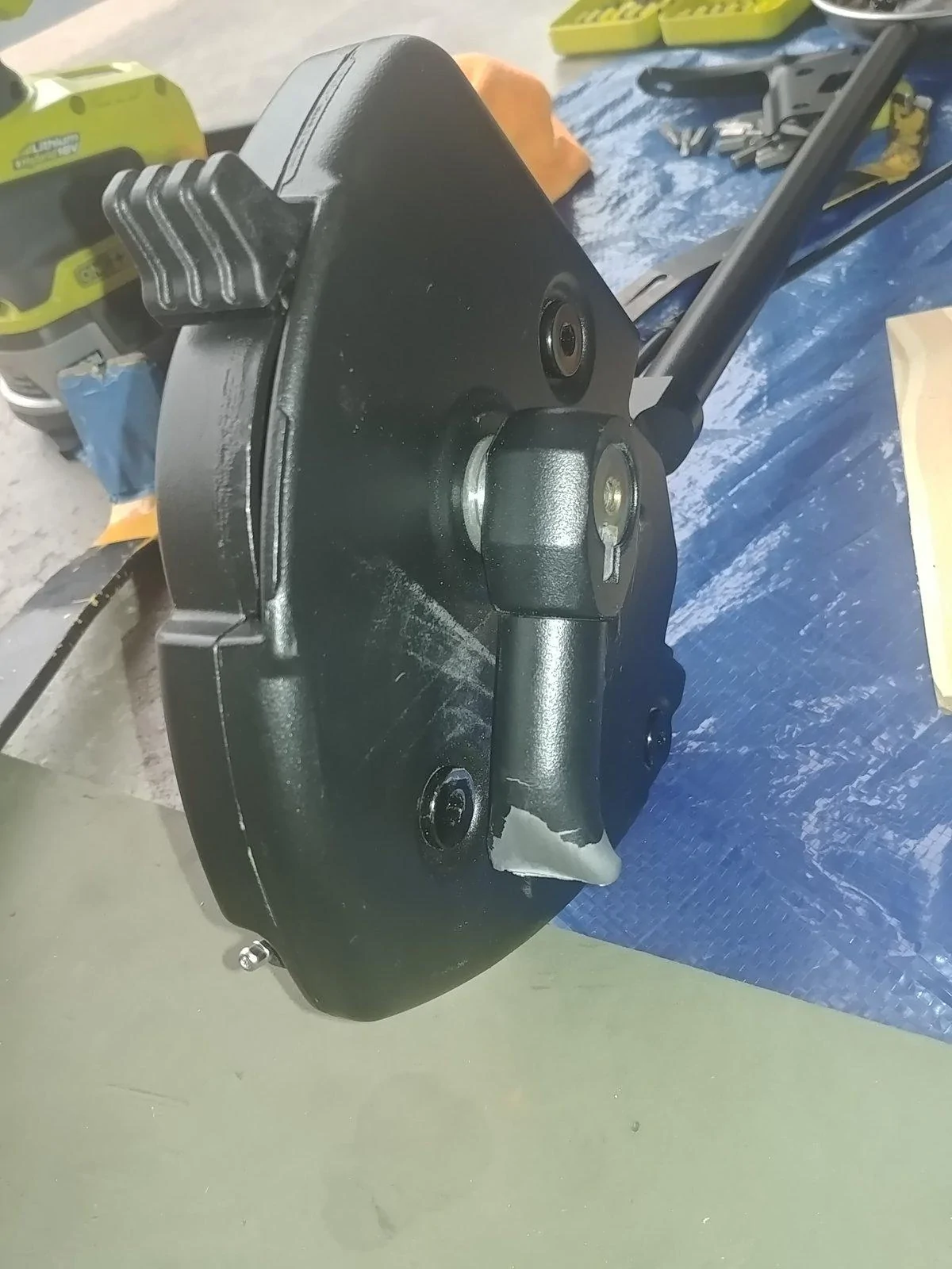

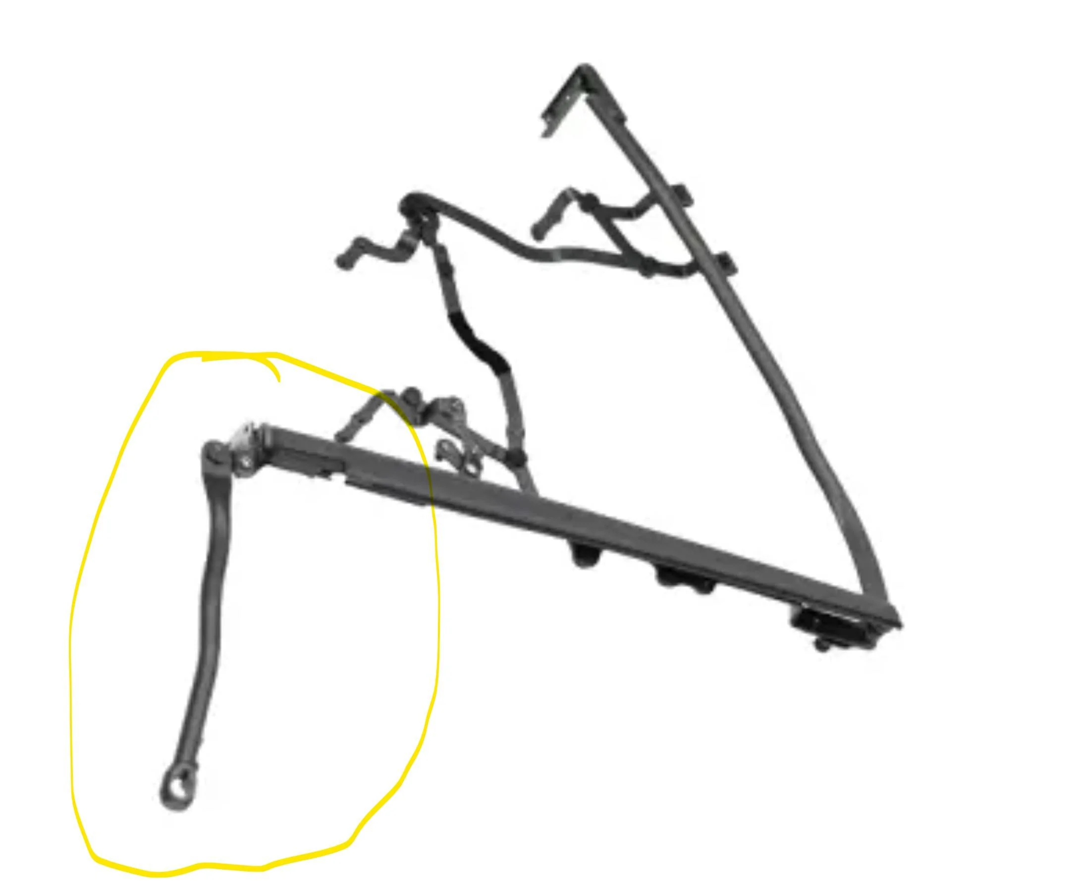

It was the correct part number for me and the pics that i posted and pics from prev posters. The part you have circled in your diagram looks like a different part. It doesnt look like the part i replaced.
how did you detach the other end? I get the need for a gear puller for one end of the part.

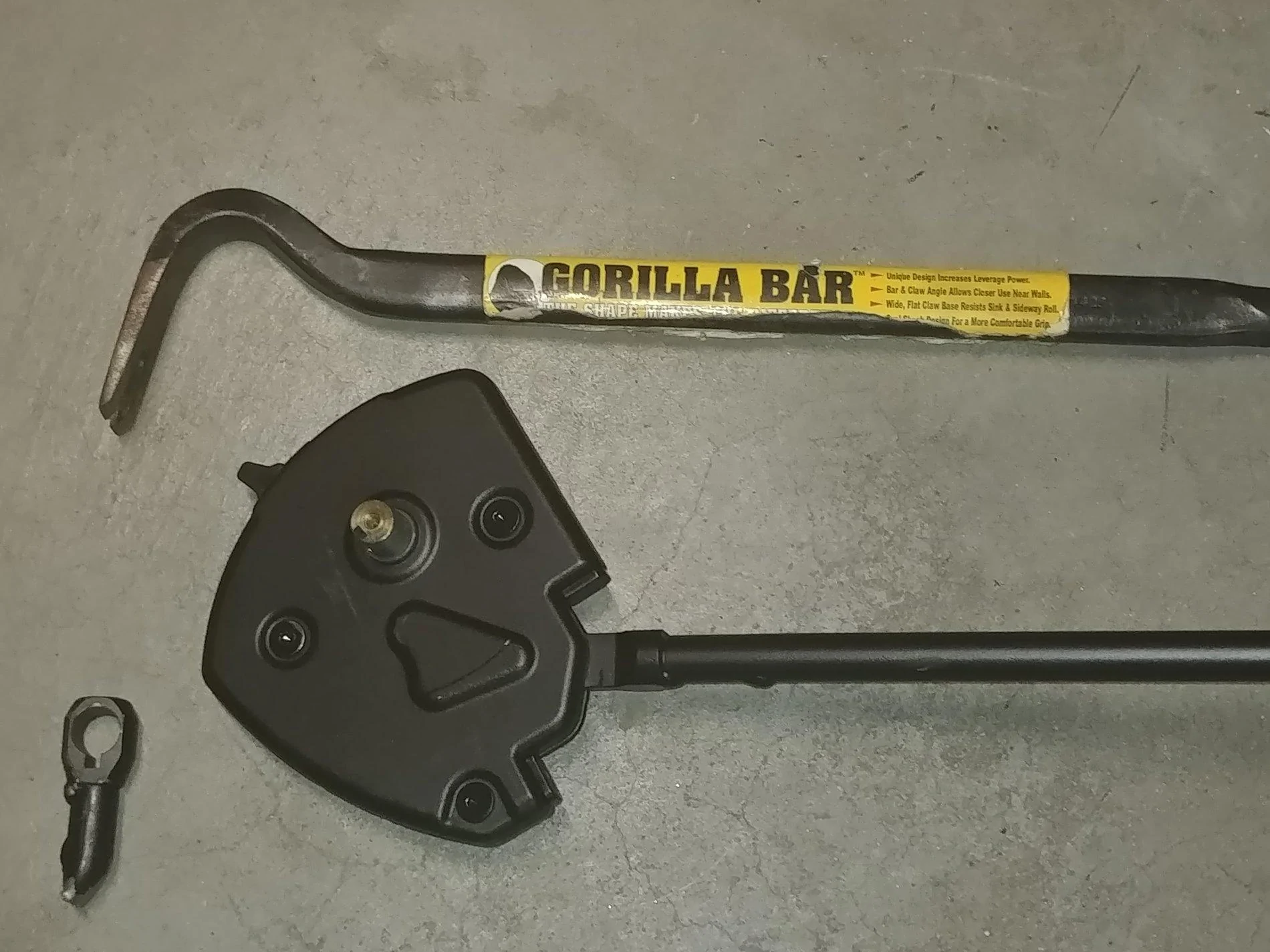

I dont know or remember. This was ~3.5yrs ago when i posted my pics of what i did. I used a crowbar to get them apart, but a gear puller would've been ideal--i just didnt have one, or easy access to one.

the top end of the bar is where I dont see a way to remove it. I may try to bend it forward a little
It wasnt easy, but i took the top off and laid it on the garage floor and worked on the frame that way, essentially upside down. It wasnt easy to get off, and was a PITA on my hands and knees, but no rollbar to get in the way. I had full 360* access to the part to get it apart.

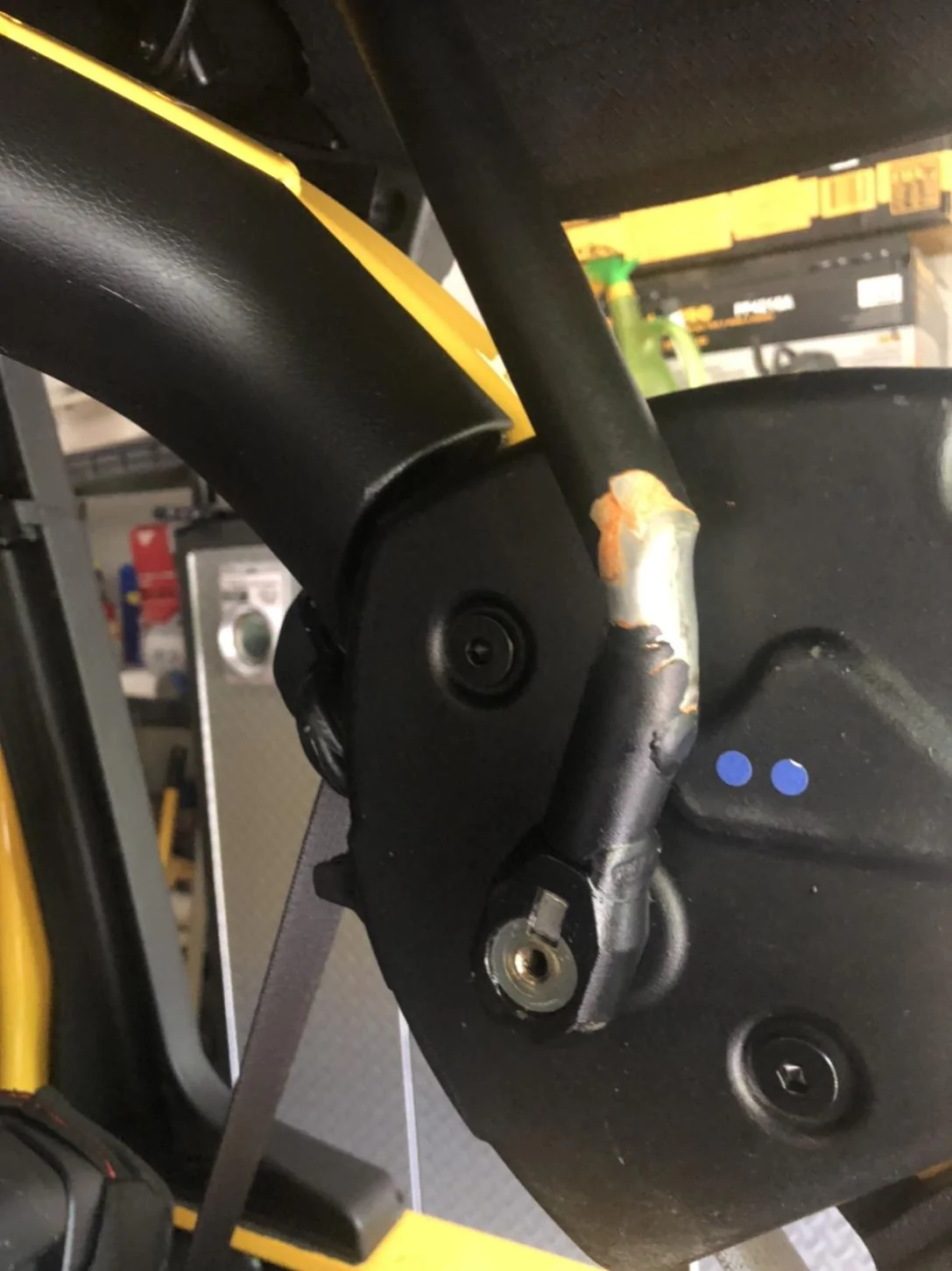

Getting the bolts in the passenger side seemed to be too much work. 5-10 minute struggle, but my first JLU, so I dismissed it as noob fumbling.
Then when it came time to filp it forward & buckle it down, something was clearly wrong. When comparing passenger arms to driver arms, I found it (see pics). It didn't help that the paint was flaking off... probably where someone was trying to bend it back too.
