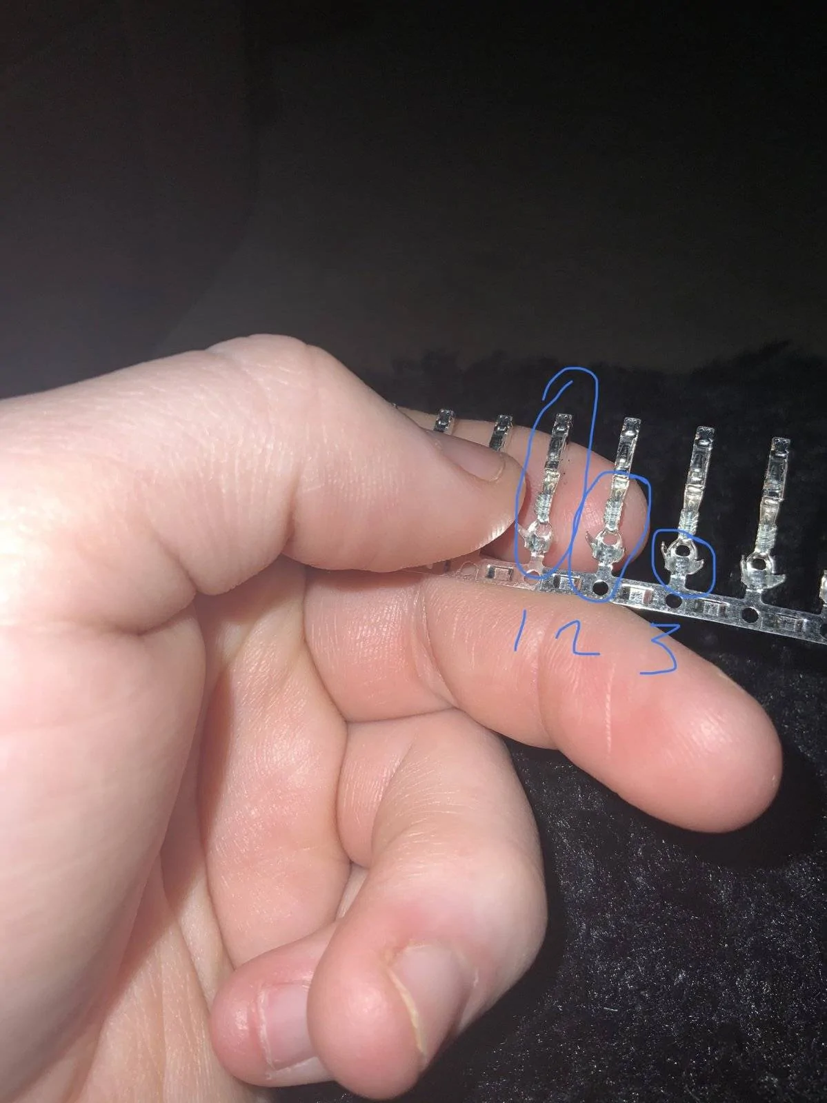

Alright i got a set of LED turn signals but the connector is not on them. I have the boot insulators and the pins as well as the connectors. How much wire should I strip off to re pin them?

Number three, you only need wire under the crimp section. If you leave it too long it will interfere with the insertion into the connector. the one closest to the strip is to be crimped around the seal and the stripped wire is crimped in the second one.

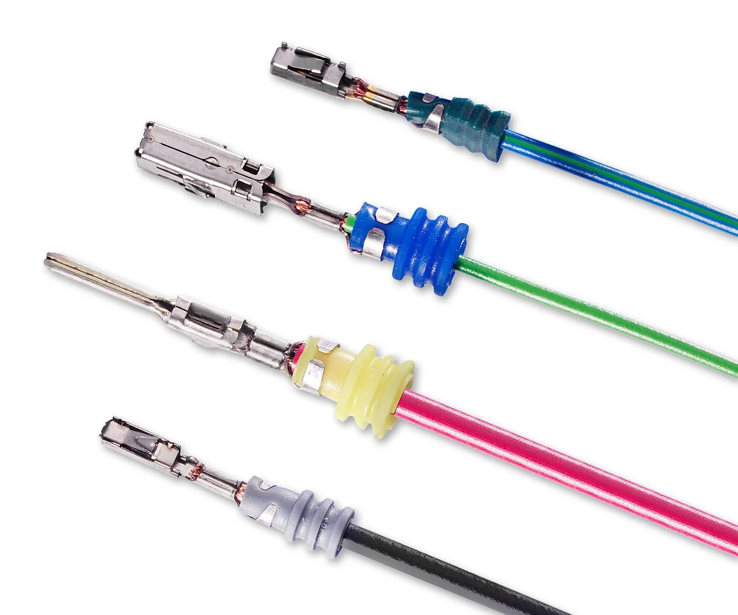

Jeep Wrangler JL Repining harness connectors Crimping-Machine-SSC1_Samples_2000x1667px
what they should look like when done.
