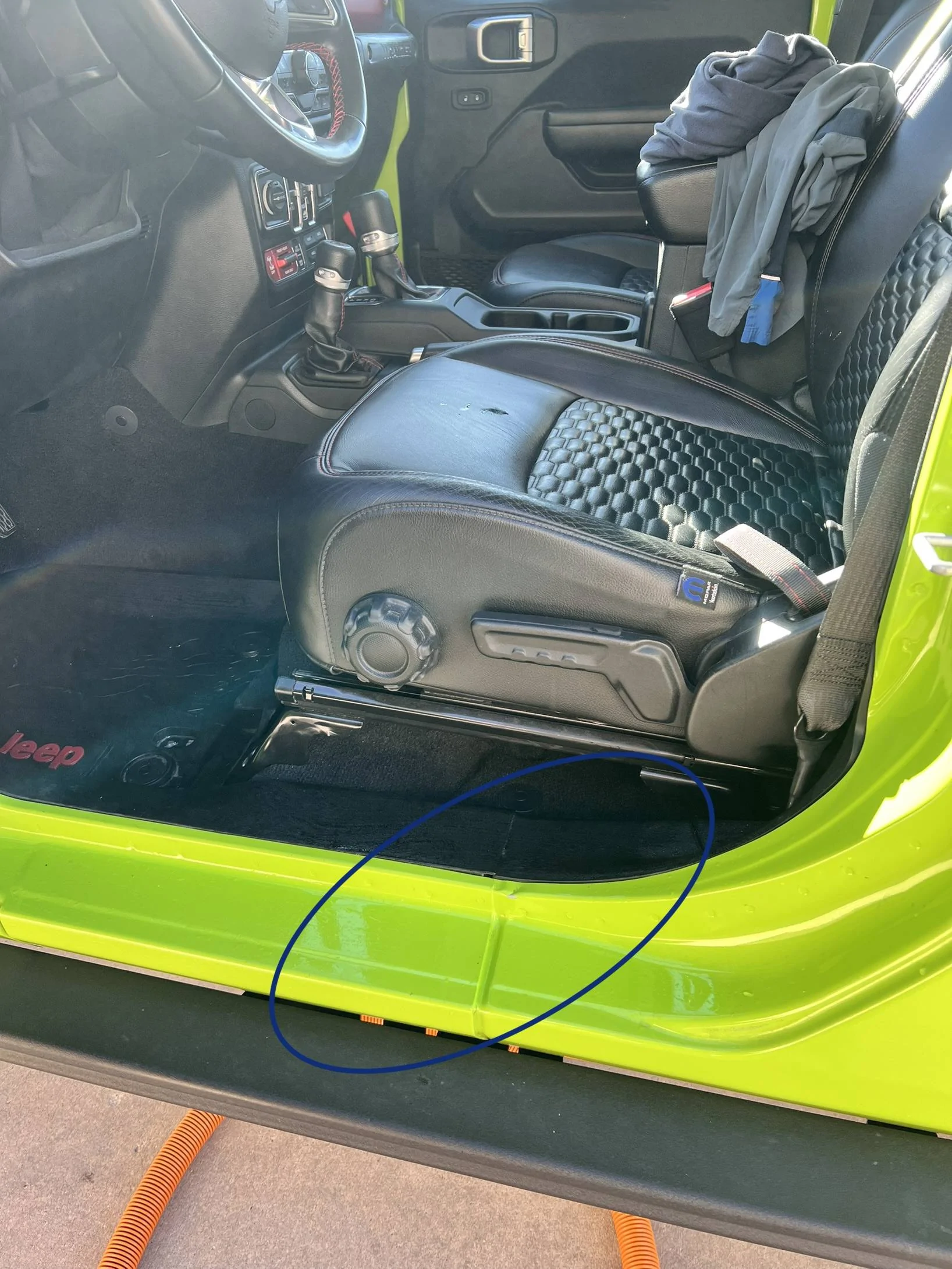

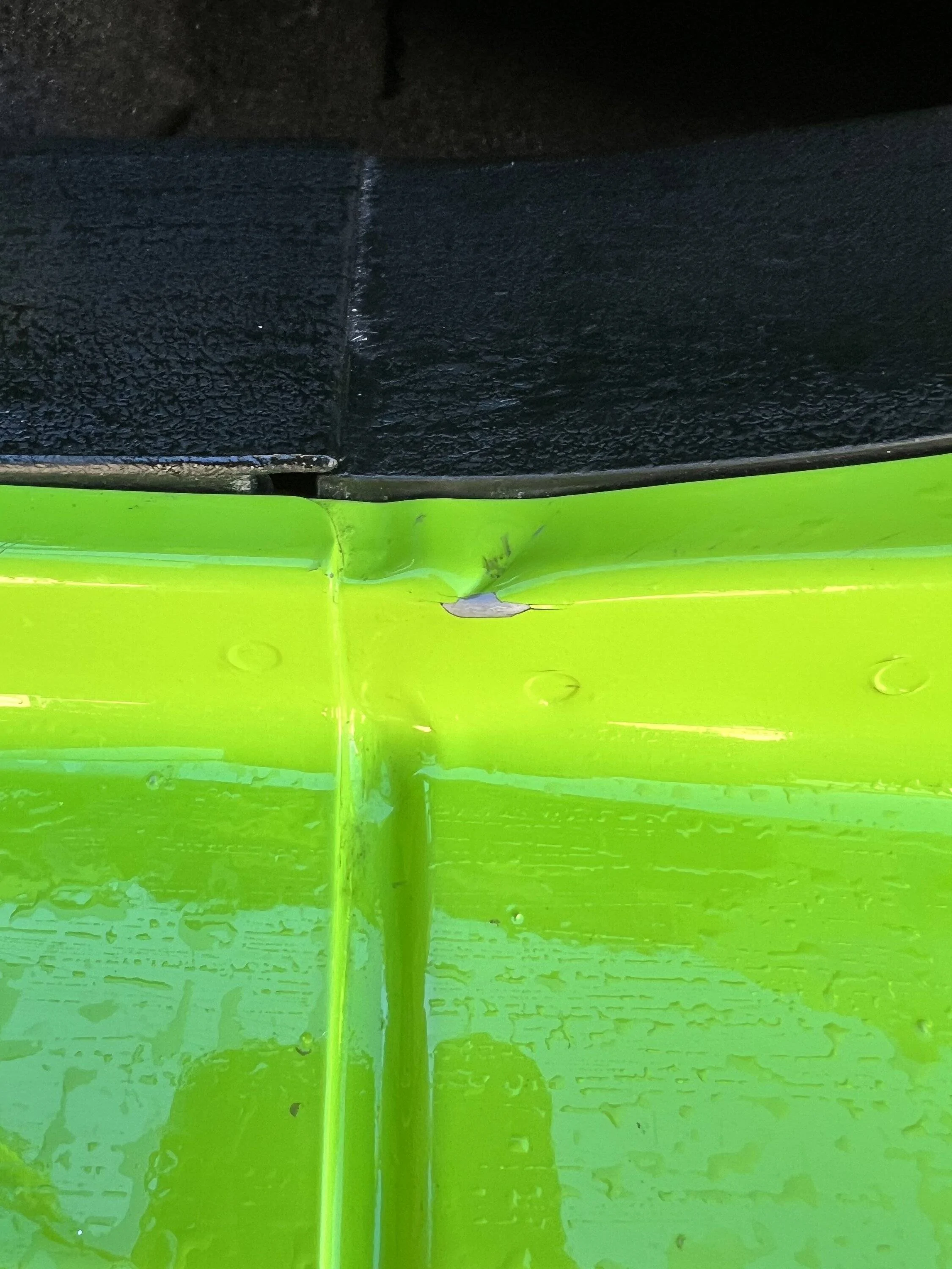

Found a small dent with paint chipped on the driver side entry. Any suggestions how to repair. Not as concerned of the dent as much as the paint chipping and getting worse/rust. 2021 gecko green JL. Thanks… No idea how this got there.

Why not just use the touchup paint color match from mopar and then use the Clear Coat Sealer? O.M.G. If I had a dent like that it would drive the OCD in me nutz!

Weird. That looks like something with an edge and some weight to it to make that crease. Yeah, MOPAR touch-up paint would probably be the way to go. Maybe some filler to keep water from collecting there...

Looks like the seat belt got shut in the door. Seen that before. Clamp and a flat panel hammer should straighten that out pretty easy. Add touch up and clear to finish it off
