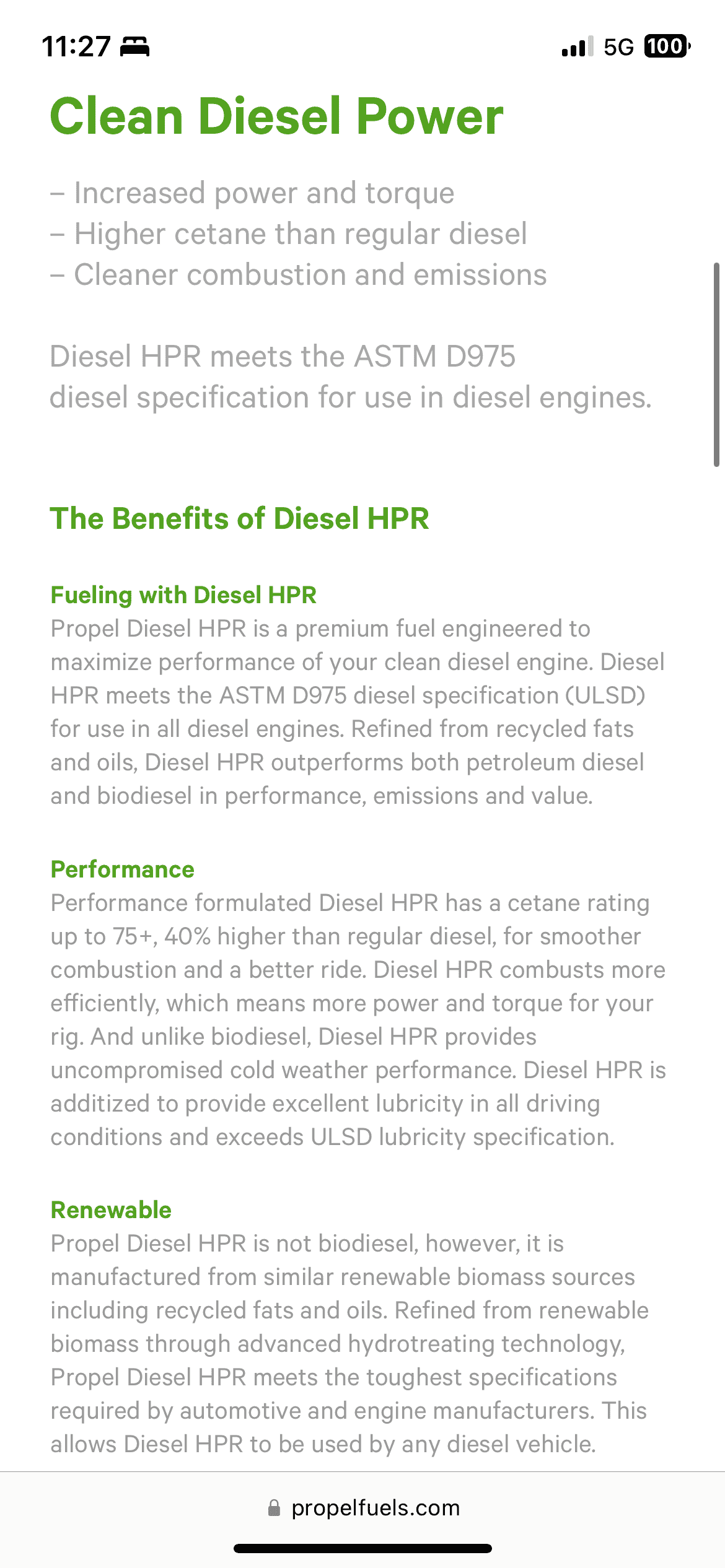

I’m going to bump this thread because I’ve been noticing more and more stations converting their diesel #2 pumps over to “Renewable Diesel”. They are typically B5-B20 blends, but 76 is the R99. It’s getting increasingly difficult to find regular #2, and I’ve had to run a couple tanks of B20 when out on the road and unable to find regular diesel. I think I’m going to keep my oil change intervals to lower mileage.
Has anyone else been using the R99 stuff with success? The 1500 forums seem to be full of people who do and they haven’t reported failures that seem to be anything outside of the CP4 failure.
Part of the problem I’m finding is the articles that are explaining the differences between biodiesel and renewable are written by the companies who make it. Obviously they are going to tout the benefits while claiming it’s totally fine for all modern applications. I’m hoping to find independent research that shows the R99 is safe to use and doesn’t gel or sludge the way biodiesel can.

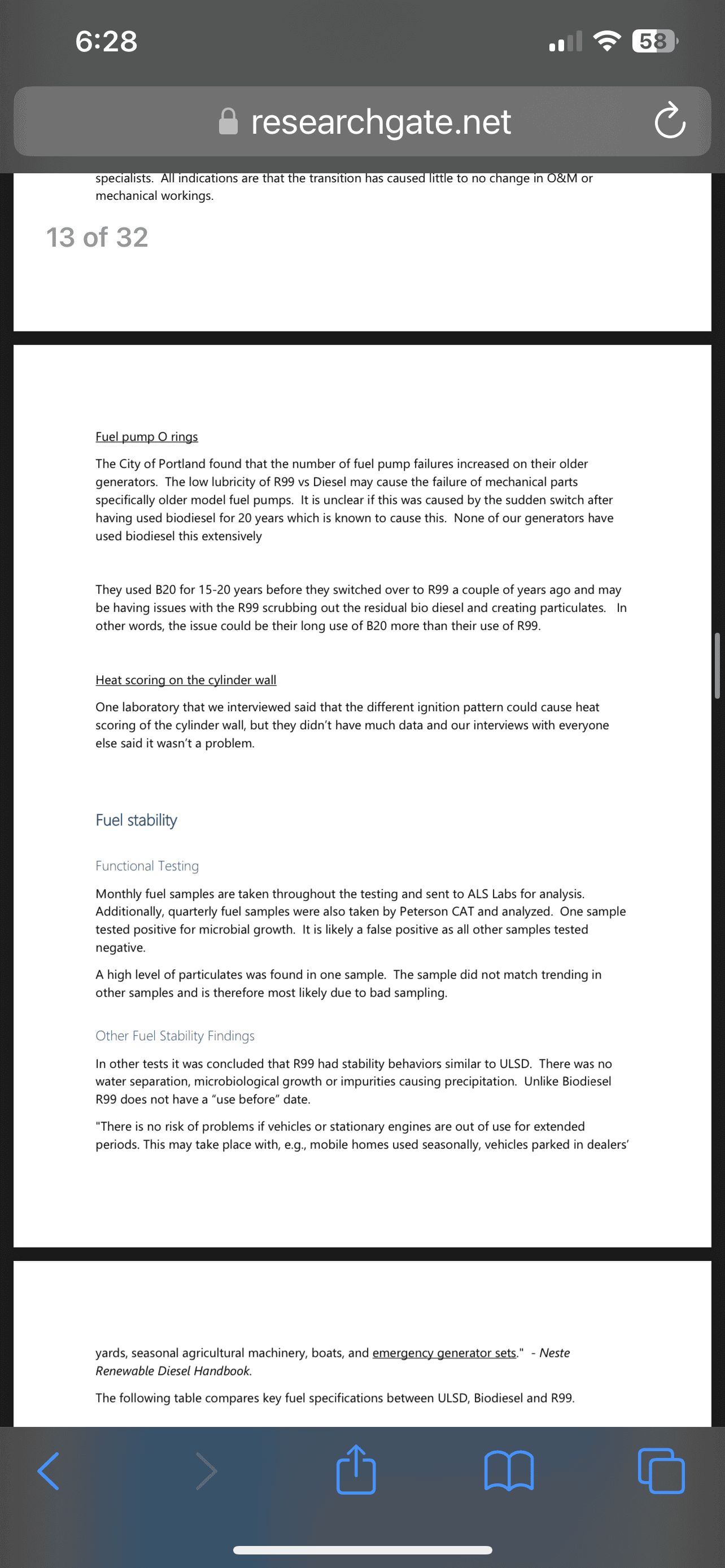

Pages 13 and 14 go over “Other mechanical findings” where they interviewed other R99 users for generator applications. The City of Portland’s generator O-rings started failing after switching to R99, HOWEVER those generators had been running on B20 for the past 20 years and the belief was the switch to the R99 may have resulted in the scrubbing of particulates causing the 20 year old o-rings to finally fail. They stated it was likely less of an R99 issue and more of a B20 issue. They did, however, state the R99 has a lower lubricity than B20.
My takeaway is use Hot Shots EDT or other lubricity additive with R99.

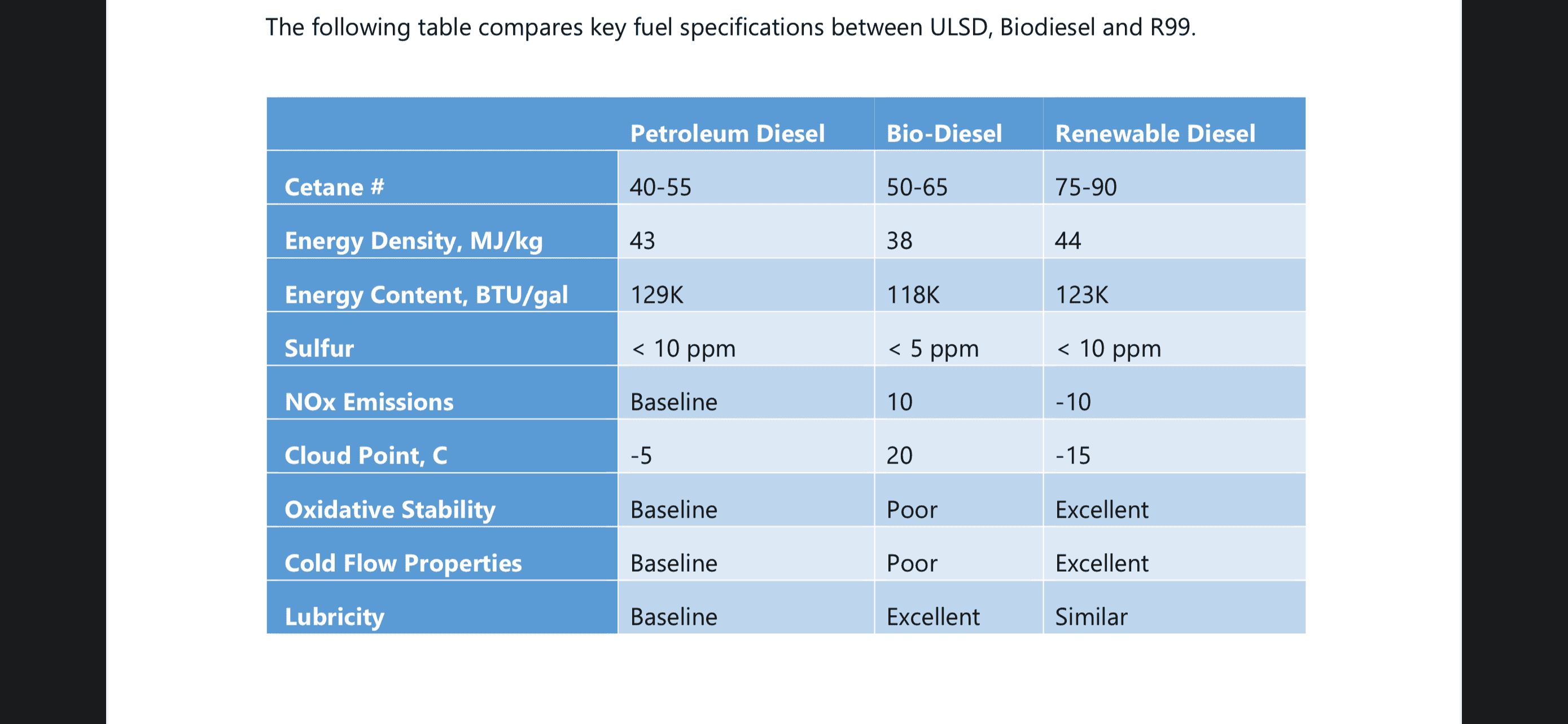

Another interesting part of the research paper:
Jeep Wrangler JL Renewable Diesel (R6-R99) Discussion Thread 10E0E373-B5C3-42CB-9A39-EBF6C0360F49
Jeep Wrangler JL Renewable Diesel (R6-R99) Discussion Thread C912FD84-B0C0-41CD-AA81-54752614CEEE

I realize that research paper focuses on the use of R99 in generators that do not have DPF systems, but an interesting benefit to the R99 is it has a much lower soot contamination which should result in less regens. I’d venture to guess that would make the DPF less likely to become clogged up over time. They also note the excellent cold weather performance of R99 compared to B20, as well as the lack of microbial growth, wax buildup and fuel separation. Considering diesel #2 is allowed to have up to 5% biodiesel in it without having to be labeled, I am wondering if using R99 over #2 would be advantageous in our 3.0’s considering all of these things.

PLEASE read the above info before responding. This is to discuss R99, NOT B20 or biodiesel. Literature states R99 is chemically indistinguishable from ULSD aside from a slightly lower fuel density. That means it will require a fuel additive for lubricity to protect your CP4 pump, just like #2.

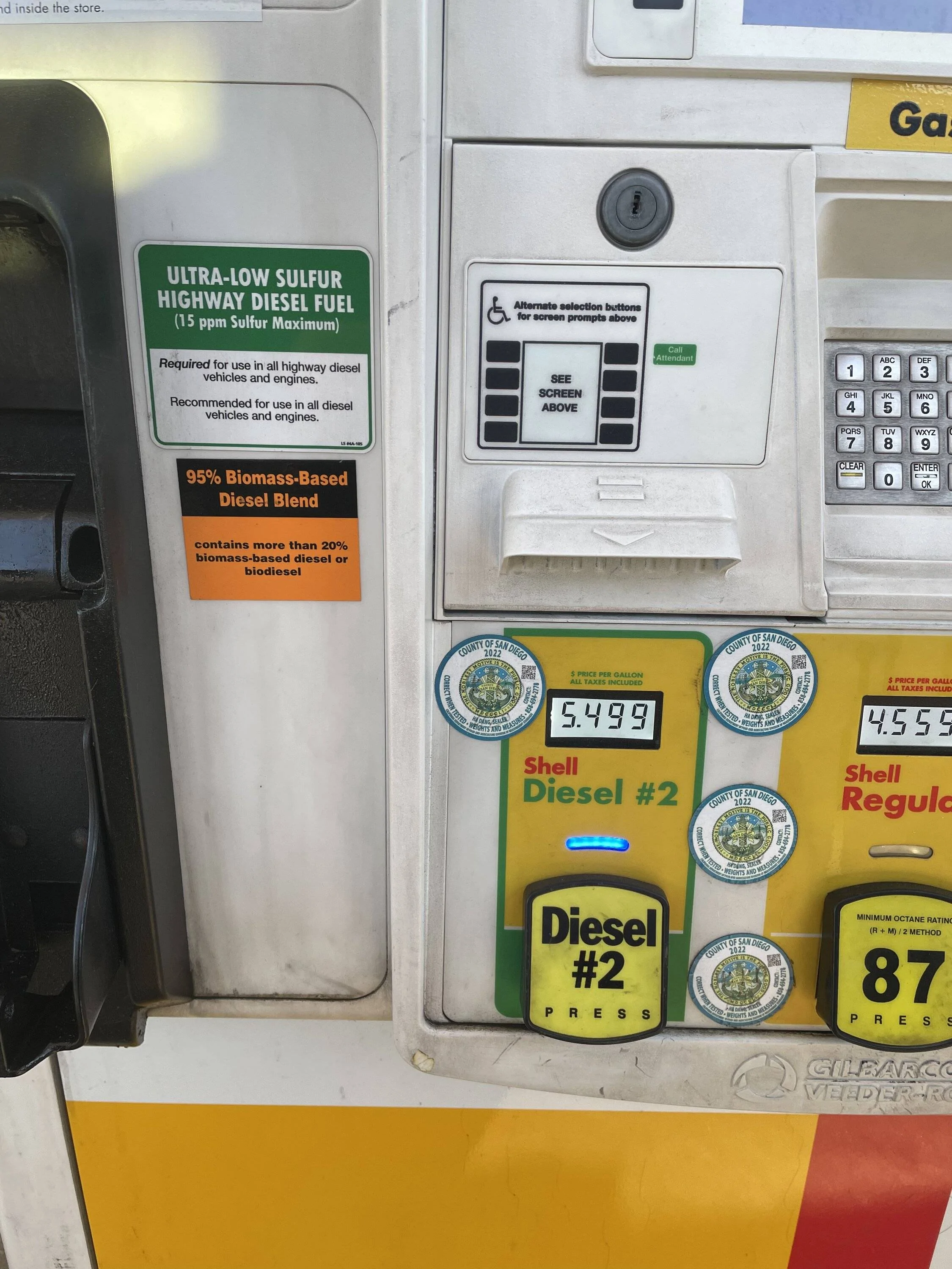

So I filled up at a Shell station advertising #2 and while I was filling up I noticed this orange sign. So is this R99 or something else?

It probably is. It’s not labeled as such but my understanding is B100 is very, very rare so I doubt it’s sold there. You’d have to ask the owner or Shell what it is specifically but that same exact label is at the 76 where I see R99 at.

Haha. Then I guess the testing has begun. I don’t usually go to this station. I’ll have to look more closely at my usual spots I thought I was getting #2 at and see if that same sticker is there.
