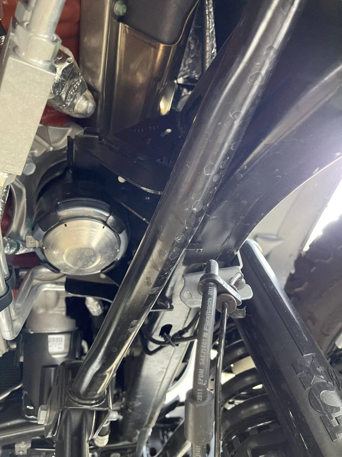

Today I attempted to install my engine /transmission skid plate that I ran on my 2020. Much to my dismay I discovered that my new 2021 has completely different engine mounts. Needless to say my skid is a no go.
has anyone else encountered this scenario?
this sucks.

Not sure what brand you have, but if they are Metalcloak, you should give them a call because I’m sure they can help. They have new arms for their skids for the 2021s...
If I remember right, I was told that the 2021s use the same motor mounts as the Gladiators.

The 2021 wranglers now use hydraulic motor mounts

Update.
I received a set of updated mounting brackets from Asfir. They bolted right up. The only thing I’ll have to do is drill 2 new mounting holes in the skid. The updated brackets mount further back on the frame. No big deal.
im very pleased to have my engine and transmission protection back.

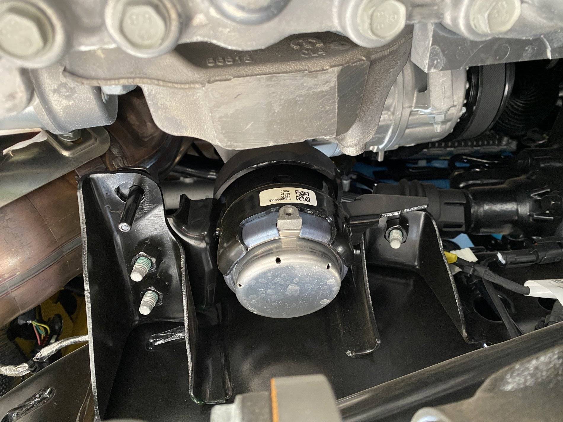

I thought that was 6.4 v8 Specific, but glad they trying to improve NVH. Hydraulic motor mount definitely smooth out vibration.

Are the nuts welded to the motor mount bracket? I'm trying to install the Next Venture 7000 skid on my 2025 3.6L and couldn't get the nuts to move with a 1/2" impact.

Yes, have to remove the bolts from the top.
