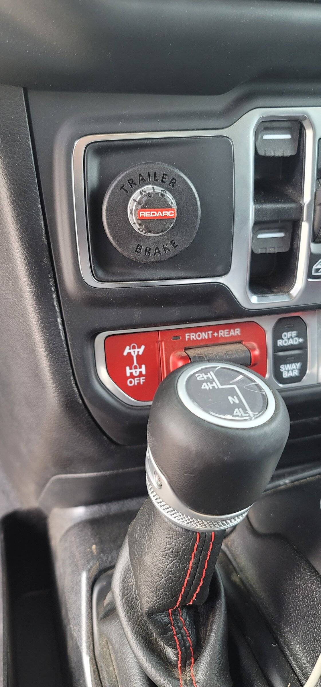

Thanks for the tips! I will probably use the universal circle mount and just drill a hole. I need as many 12v outlets as I can get. We have a rear view camera behind the camper that needs power, and our Samsung phones don't like taking charge from low powered USB outlets :(
Skyvet
Jack
Jul 6, 2021
98
150
Bakersfield CA
2002 HD fatboy, 2003 Road King, 2021 JLU, 2024 392
You might try this location just in front of the cupholder. I saw this on another thread in this forum. The second pic is the 12v location
Jeep Wrangler JL Redarc Tow-Pro Elite Installation Updates 20190126_193939
Jeep Wrangler JL Redarc Tow-Pro Elite Installation Updates 20220315_161233
