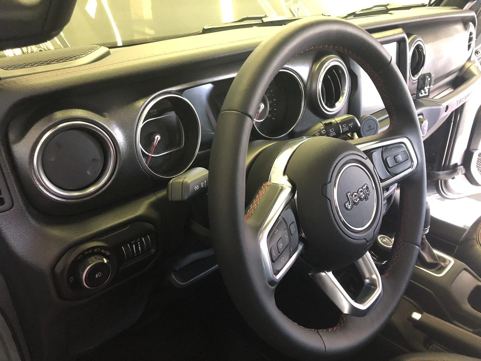

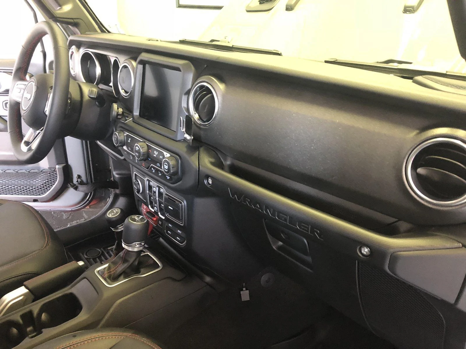

When I picked mine up it had the grey dash. Mojito Rubicon with grey dash from the factory. Funny I have been wondering what it would have looked like and now that I've seen one. Pretty happy with the grey...

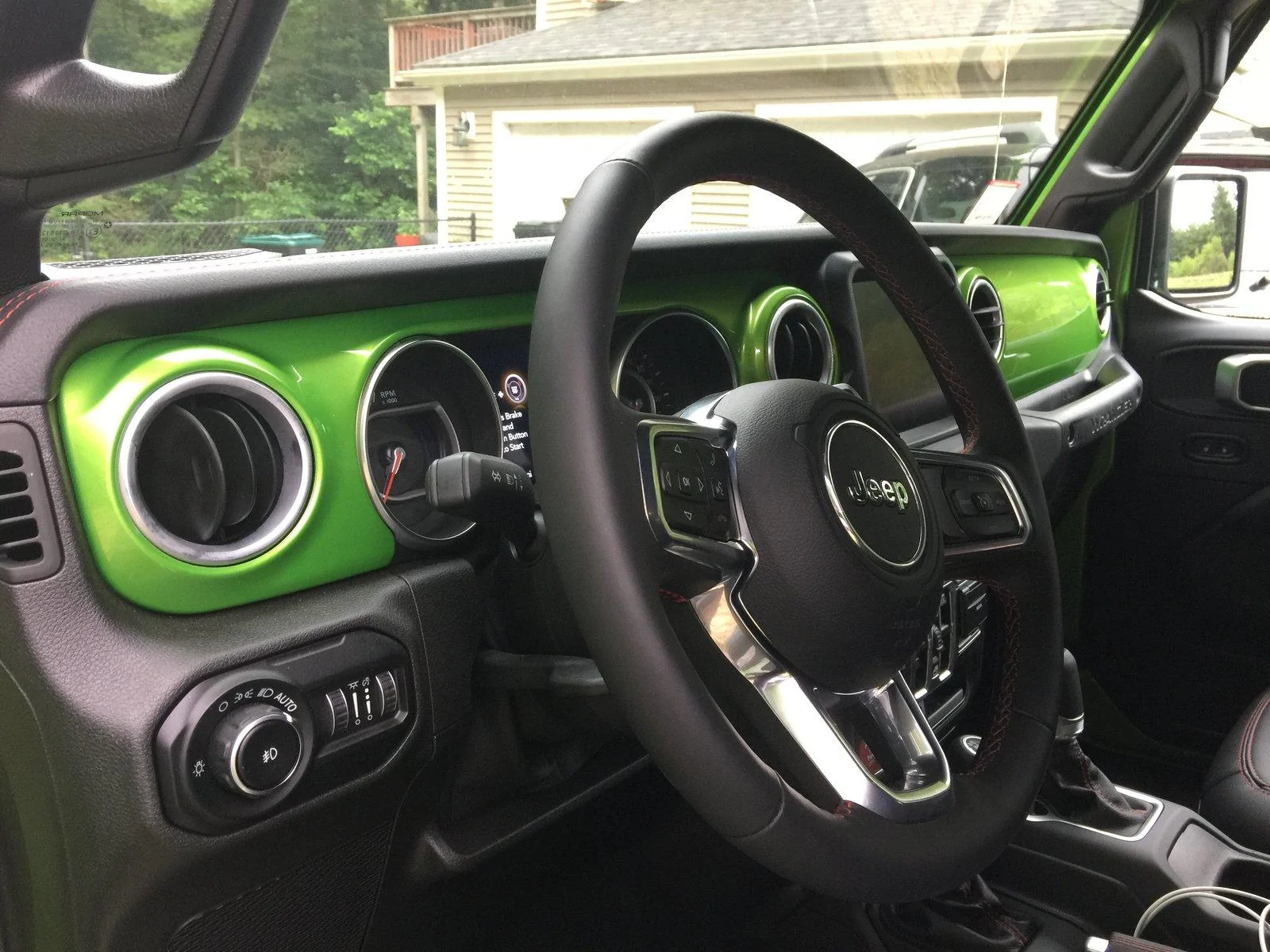

Had mine painted to match and absolutely love it.
where did you have it painted?
