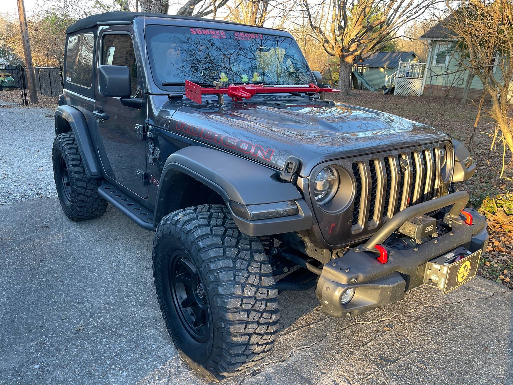

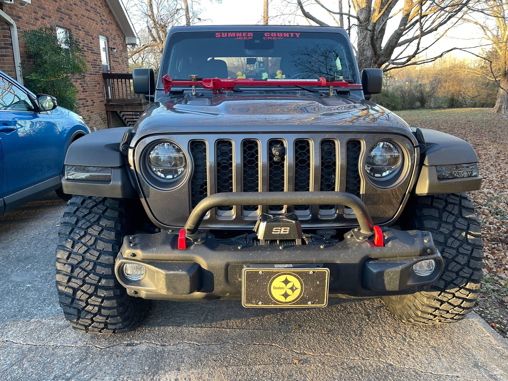

I’m running factory steel bumper on my ‘22 Rubicon. Aftermarket front hoop. Hit a deer in Tennessee (10pt!) at 70 mph and it just damaged the right fender. You can still see the right side plastic near the fog light has deer fur/abraision.
Jeep Wrangler JL Recommendations for crash bars? IMG_8702
Jeep Wrangler JL Recommendations for crash bars? IMG_8701

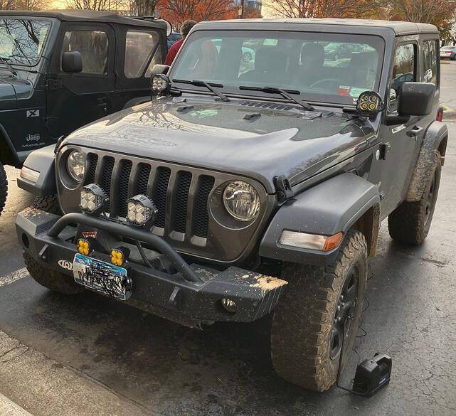

i have the lod mid width signature steel bumper. been tested a few times from deer, etc. lod makes a few different style bumpers and comes in full width. they are well built and made in the usa.
That looks like it might work nicely. Doesnt fold back into the grill on impact?

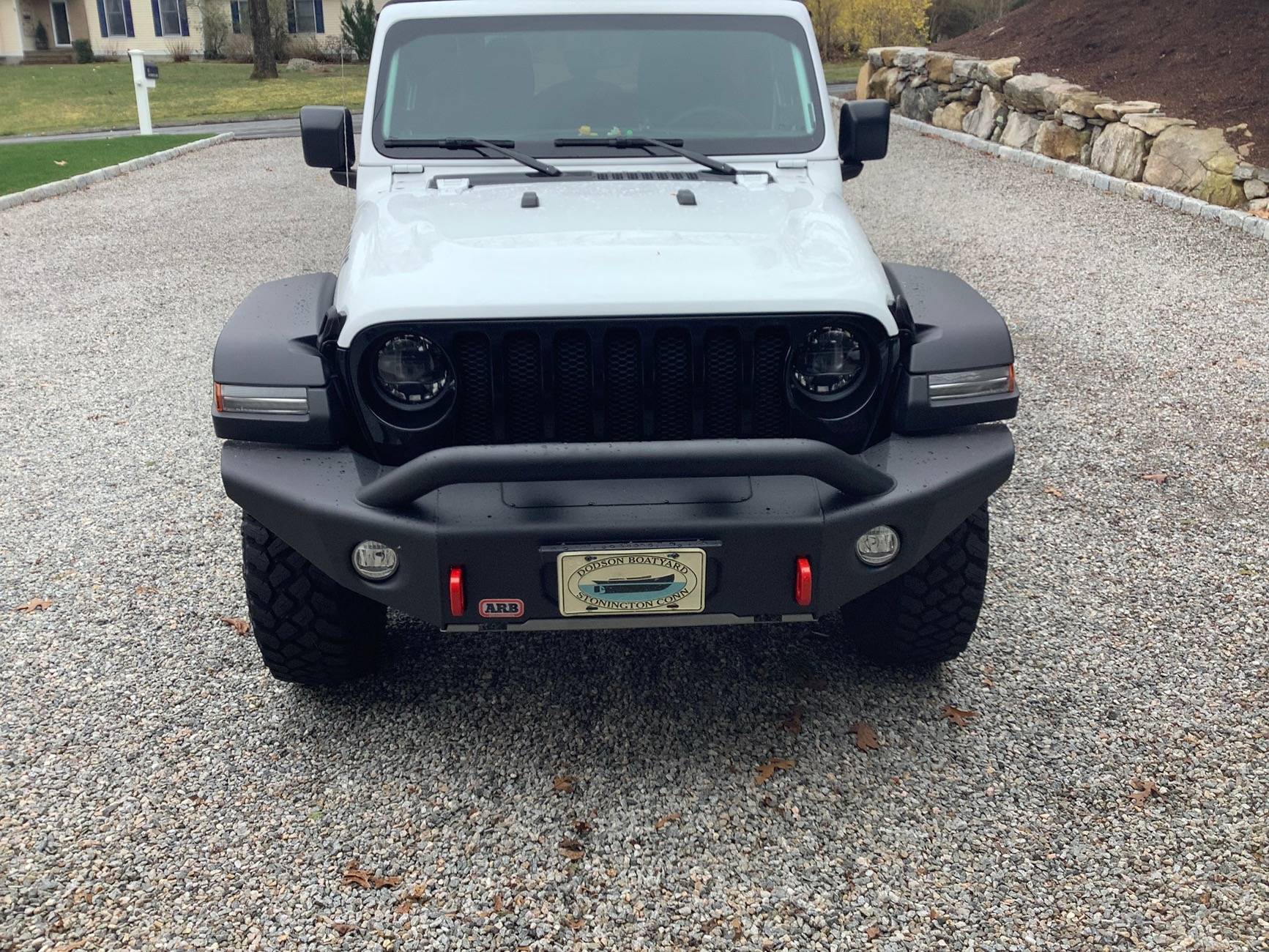

ARB Bondi full width for comparison.
no. this bumper have saved me a few times from body damage from the deer or 2. without that bumper i would of had at least grill and fender damage. also had a few close calls from idiots pulling into a parking spot or backing out of a parking spot while i was parked. again i would of left with scratches vs body damage. i would defiantly get another one. the bumper is a thick steel, fully welded set up. if i recall, the one i have weights 68 lbs. i didnt have any sag even with the winch. if there was, maybe a 1/4 inch. but its not noticeable. its well worth it and a piece of mind.
