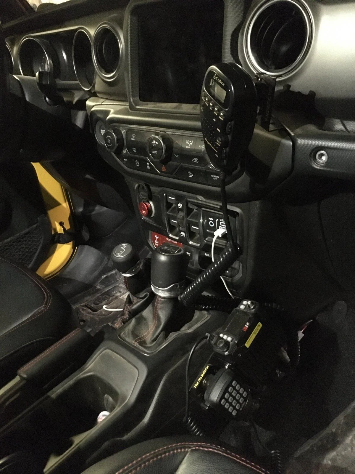

I'm running both ham radio and CB. My ham radio also gets used for GMRS when needed (not technically in compliance with the regulations, but I follow all of the other rules and I'm licensed for both services). My club uses CBs, and it's nice to have every option available should I decide to join up with a random group when traveling.
My CB radio is a Cobra 75 WSXT, which works great for the Jeep. I'm using the Topsy Products dash mic bracket with a Magnetic Mic for quick and easy access. My antenna is a 4' Firestik FireFly antenna mounted on a Rebel Off Road Multi-Purpose Mount. I originally started with a Cooltech antenna mount, but found that the Rebel mount worked better with my 35" spare on the back.
My ham radio is a BTECH 25x4. The radio works great outside of urban areas, but for anyone considering a radio for use in the city, I'd recommend a higher quality radio since it blasts noise every time I go past a hospital or other facility with a pager transmitter. Since I use mine for mostly trail communications and the radio is cheap enough that I'm not going to freak out if it's stolen when I have the doors off, it works well for my needs.
To mount my second radio, I used the Quadratec universal quick disconnect radio mount designed for the JL. Since this particular radio is small enough, I was able to mount another Magnetic Mic mount next to it on the Quadratec bracket and the mic sits right next to the radio. I have the antenna coax running behind the center stack to the drivers side, where it exits the hole where a clutch should be into the engine bay. My antenna mount is a Topsy Products JL Fender Mount NMO Antenna Bracket.
The ham radio antenna itself is a hybrid between a Nagoya TB-320A tri-band antenna and a STI-CO VHF Flexi-Whip antenna. The antenna hits my garage door frame, so I replaced the stiff top section of the Nagoya with the STI-CO antenna, after trimming it to the right length. STI-CO Flexi-Whip antennas are made of Nitinol, so it just bends easily out of the way when I hit things and then pops right back up.
Here's a shot of my radios in my very dirty jeep:

Thank you for the reply!! Your setup looks great.
What Mic mount are you using for the Cobra mic if you don’t mind me asking?
This one:
https://topsyproducts.com/products/universal-cb-mic-mount-jl
You can use that with the clip that comes with the Cobra CB, but it’s hard to hang the mic back up when you’re driving down a rough trail. The Magnetic Mic mount makes it super easy - you just get the mic close by and it jumps right into place. You can find those on Amazon:

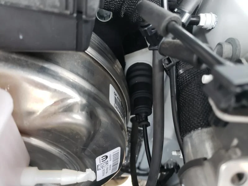

if you have an auto trans get yourself one of these grommets..
Jeep Wrangler JL Recommendations for CB/VHF Radio? zOQomhl
made my life pretty easy getting thru the firewall
