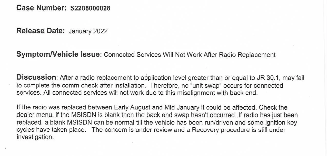

The 8" Infotainment system on my 2018 JLUR started acting up so I took it in to my dealer. I have a Jeep extended warranty so my warranty is for 5 years and 65,000 miles.
The dealer determined the unit needed to be replaced and replaced the unit with a new one. I have subscription services for all the available services on the Jeep. After the radio replacement none of the connected services would operate...not the SOS system, Uconnect...the SiriusXM...nothing.
I took the Jeep back to my dealer and they found a service TSB dating back to August of last year. Apparently there are known issues with the Infotainment system and Uconnect and other connected services. There is no known fix at this time. We actually used those systems and some like the SOS are safety features.
Anyone else having the same issues. I've been back and forth with Jeep and they tell me they don't have a fix and don't know when one will be available. I did a search and now there are multiple class action lawsuits against Jeep and Chrysler for this related issue.

None of the connected services are functional. The SOS and Assistance features are dead, they don't even light up. The Uconnect features are gone. The hotspot no longer functions. The SiriusXM features don't work.
This is a new infotainment unit they installed. I had subscription services for all these features. They no longer function and there is no word from Jeep when or if they will be fixed.
I'm not the only one affected. It is a widespread issue and is across the Chrysler FCA company.

Failure of all uConnect / SirusXM Guardian services after replacing the [8.4"] uConnect Radio.
All connected apps experiencing one of the following three issues:
1. Icon no longer present
2. Icon present but is greyed out (non-functional)
3. Icon present and will load, but application does not function properly

Someone posted a similar issue and resolution. I know I added the upgraded setup from 7 to 8.4" uConnect and I cannot get those services as they are not added from the factory. It's the dumbest thing I've ever heard that you can't add a VIN and associated radio ID information to a database and SiriusXM gets to make money...
Going off memory, for you, the first step is getting the dealership or Jeep Cares to get AT&T to provision the cell card in your radio. Some link is sent to you, all the appropriate information is plugged in, and off you go. Next, is the dealership associates that new radio ID to your VIN (this is a critical step), and a ticket goes to the SiriusXM Guardian group. Then you call and restart or start your services. That's the short version from memory.

Had mine replaced (again) in December and my SiriusXM and Uconnect Guardaiin services stoped working. Apparently they reman the units and since mine came out of and is registered to a 2020 wrangler there is nothing they can do because of the security features ?
