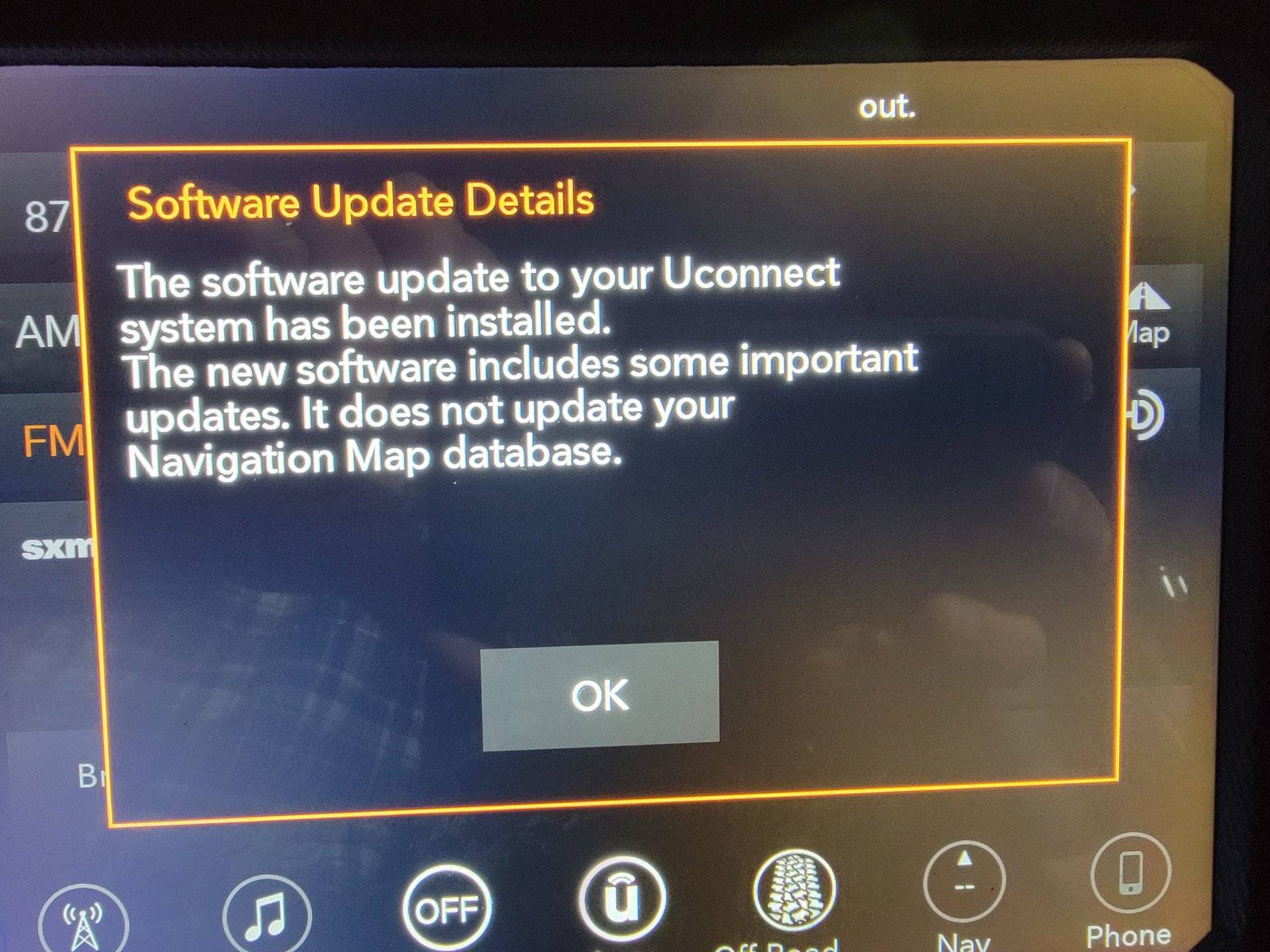

Received Uconnect update message. Anyone know details?

The update info screen didn't have much info on it about what was in the update...
Jeep Wrangler JL Received Uconnect update message. Anyone know details? 20210224_190959

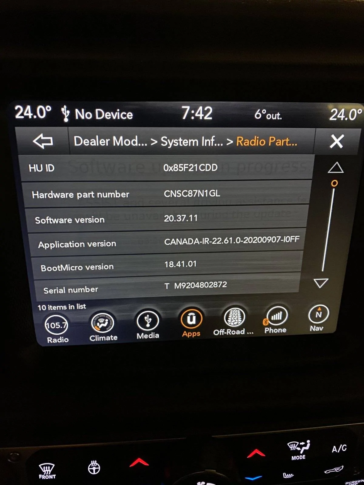

I'm pretty sure this was an update to fix all of the freezing, restart issues that have been happening over the last few months. My dealer replaced my entire radio a couple weeks ago. because.... they couldn't figure out what was wrong.
I hope you’re right, but I doubt it. They have replaced my radio twice, and I opened an extensive case with @JeepCares a couple years ago. I had videos of the issue, but they couldn’t receive them, and didn’t seem to care. I demanded to speak directly with a UConnect engineer, and they refused. There was an update in 2019 that they manually installed at the dealership, that seemed to reduce the frequency of the issues I was having, but not completely. I lost all controls a few weeks ago and pulled over, rebooted using the F97 fuse. Usually I have to restart the Jeep twice to get th system back to normal, but this time, the Jeep had to sit for hours before it came back. During that time, I had no satellite radio, and fan blower speed was all or nothing. The theme of the UConnect system was different, too.
My daughter had a UConnect issue in December where the system kept rebooting, even when the Jeep was off. It actually drained her battery. We couldn’t get the system to reboot and stay on. Jeep said there was a TSB that said an update was required, but the dealership wasn’t allowed to do it, they had to replace the radio. While I love the UConnect System, it has horrible stability issues, and Jeep doesn’t seem to care about regular software updates to fix issues. I guess that’s why they are rewriting the system now.
I had my 8.4" replaced back in the fall of '19 after it rebooted randomly and frequently. A large data set encompassing when I reversed briefly and the rear camera turned on. After it crashed and wouldn't reboot during a 600KM drive they finally replaced the unit. I've only had it reboot maybe six times since then. This is the most flaky of the Uconnect systems I've owned. Every other one was rock solid. I'm beginning to suspect the hardware might be part of the culprit, either not enough RAM or the CPU is taxed and overheating causes a panic.
