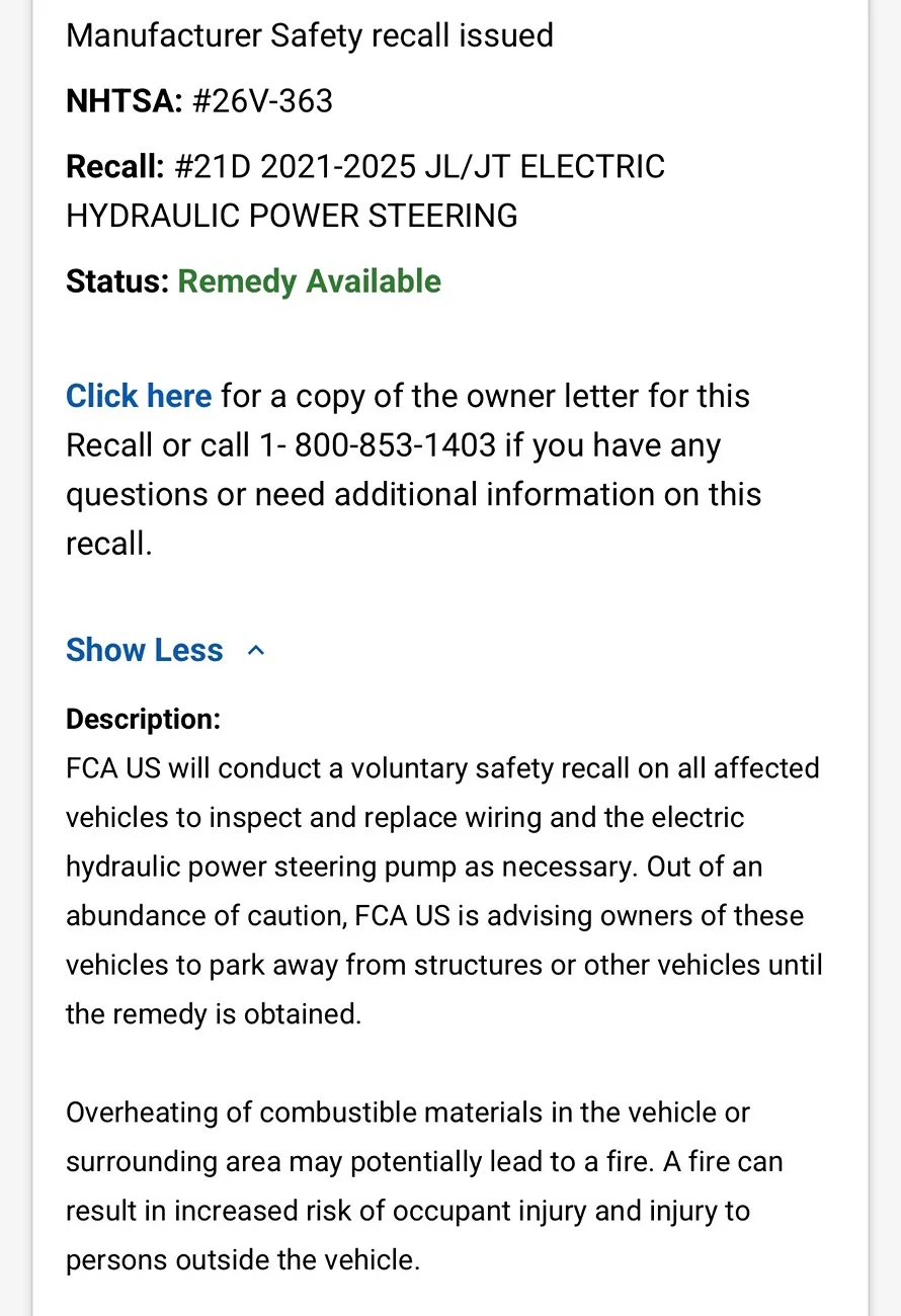

had mine inspected yesterday and no issues found,,, was told it’s not actually the power steering pump but the connector on the pump and the module for the connector,,, the thought of somebody trying to improve something that’s been perfected by removing the power steering pump from the serpentine belt and making it electronic is just insane to me lol,,,
So their inspection consist of a diagnostics on the power steering pump module and the connector, if the module doesn’t go to sleep with the rest of the Jeep it supplies power to the connector, and if the connector is loose that creates resistance and resistance creates heat and that heat will burn your wires thus starting a fire,,,

You can always go to the NHTSA website and enter your VIN, or call your local dealership and give them the last eight of your Vin, and they will let you know,,, I actually checked mine with a thermal gun, got up early one morning, and the power steering pump is actually under the air box so I crawled underneath and aimed my thermal at it to see if it was producing any heat, and it was not,,, but still, I’d rather have them sign off on it and have a little relief then worry about it all the time lol!
I also had to unmarry my taser and remove my catch can because I didn’t wanna void any warranty, I know it’s a pain to remove the taser, but you also get a chance to plug it in and see if there’s any updates, and every time I reinstall mine, I find something new,,, plus they put a scan tool on my jeep and read the information from the module, but for me it’s worth it because even though they said every one they’ve inspected in the last week has came back ok you really never know, what I heard was out of the million Jeeps that they’re recalling there’s only been maybe 50 to 70 fires,,, but for my peace of mind, I got a piece of paper from the dealership saying that mineā€˜s OK, so if something happens in the future, it’s on them!
