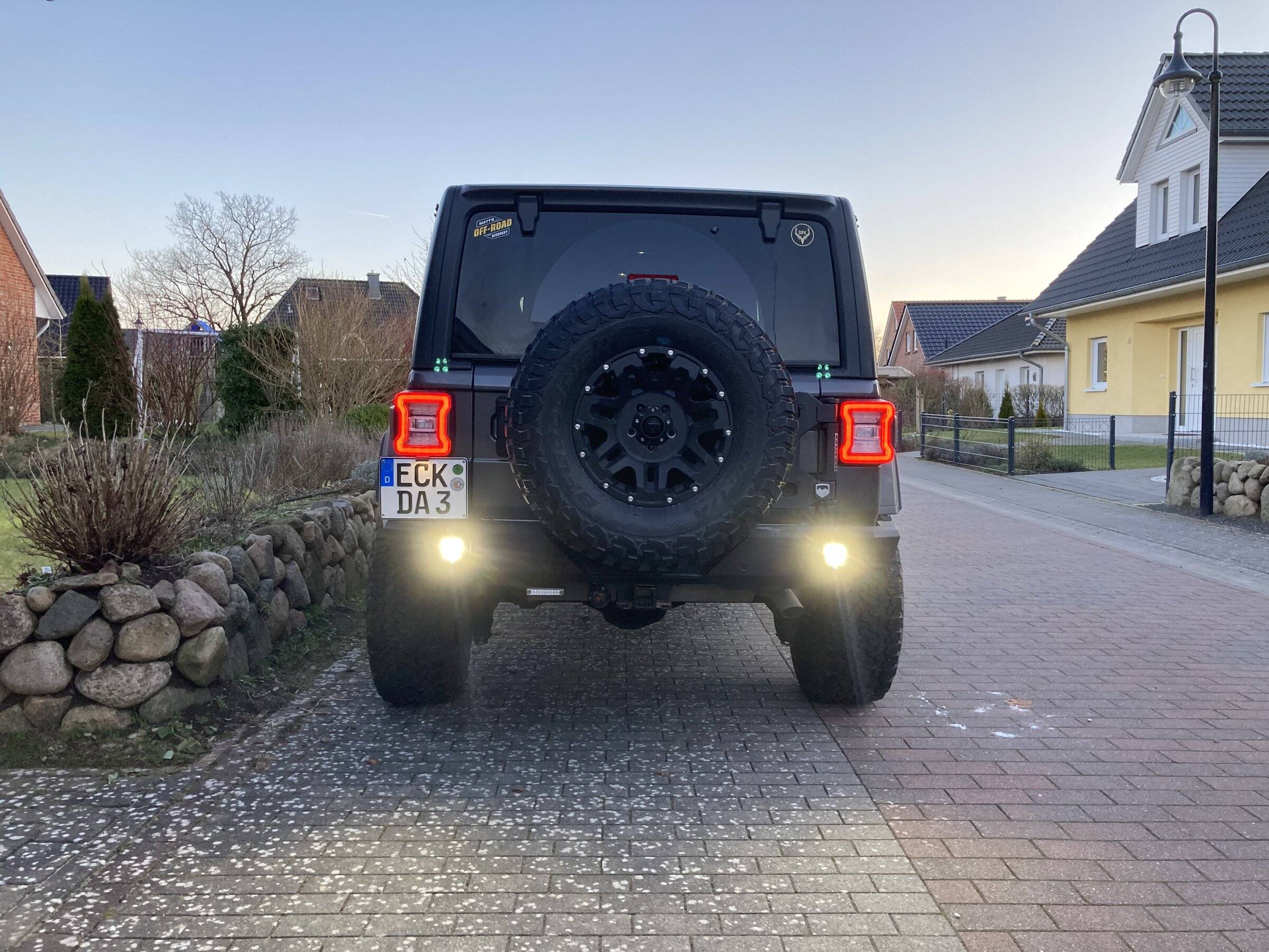

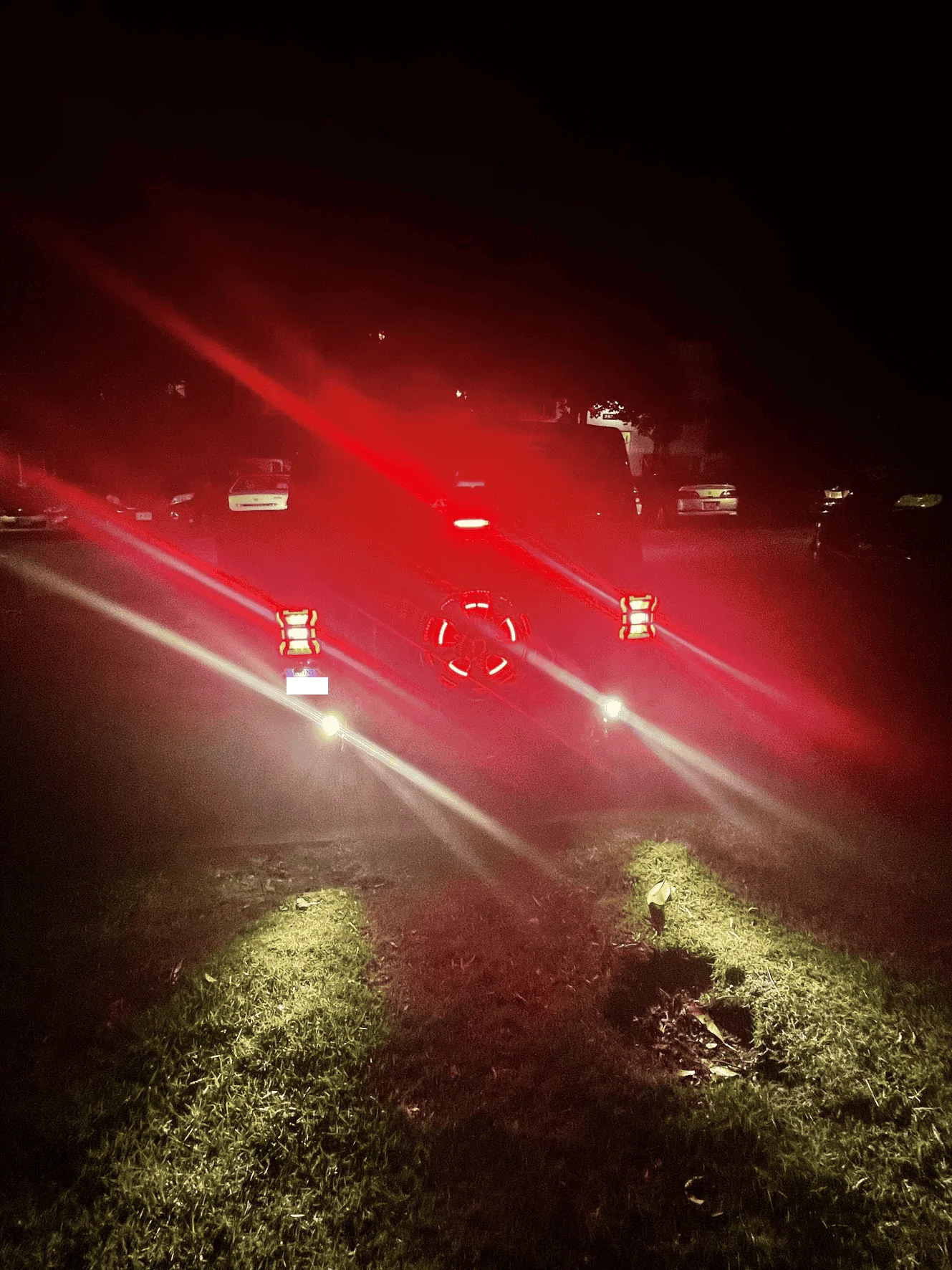

Dear all,
I just did this and thought it might interest others using the Rugged Ridge HD rear bumper.
Wanted rear facing work lights without them being too flashy. Also, with the huge german license plate, space on the rear end is limited.
These are cheap Hella worklights, mounted into the openings for high lift jacking. Since I don‘t have a high lift, the place was perfect for me.
I wired them to the Aux 2 outlet under the hood and ran the cable on top of the right hand side frame rail.
Really bright when backing up, the camera picture is like in day light.

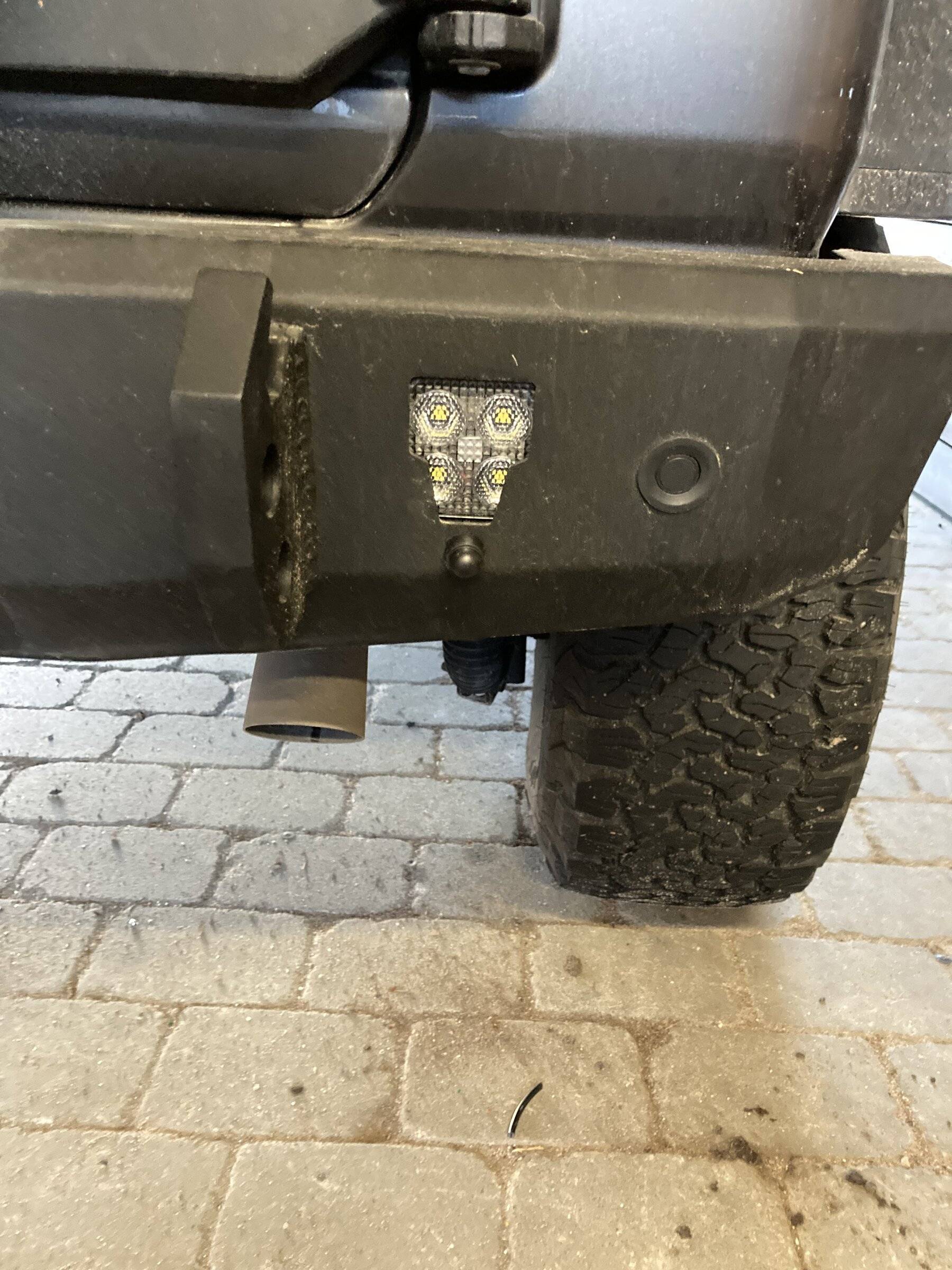

Hello Billy,

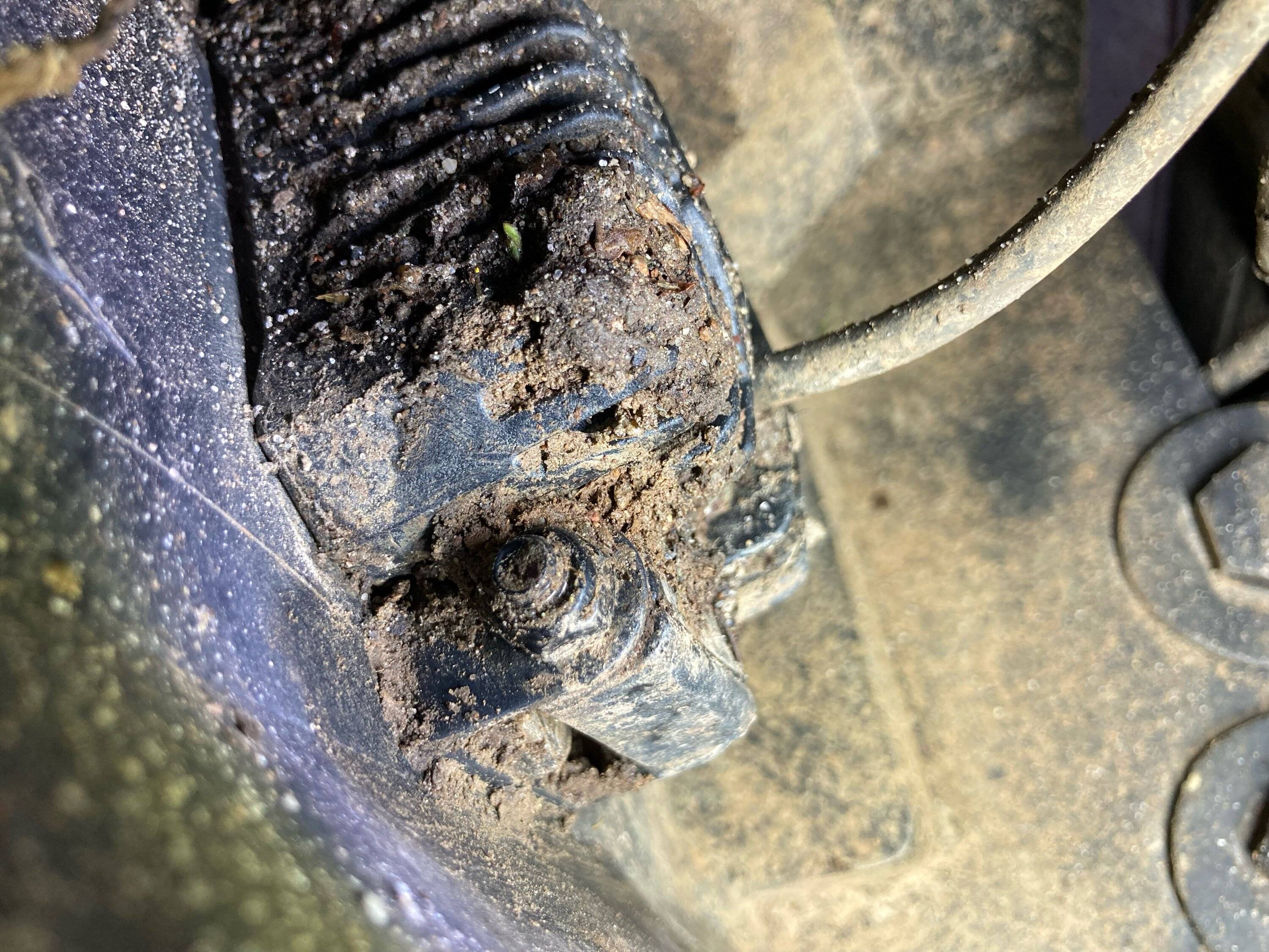

I simply drilled a hole below the opening and bolted them on. The lights I used are cheap Hella LEDs, picked for their size, and for their attachment bracket. I hope you can see it in the picture, they are a bit muddy due to the species-appropriate keeping of my Jeep...

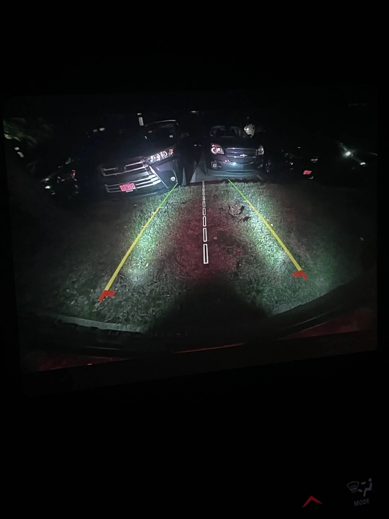

From the camera:
Jeep Wrangler JL Rear LED worklights for RR HD Bumper IMG_3568
Detailed in another thread but I bought the plug and play wiring harness and had to adjust it for it work correctly. Happy not to have to splice though, and they automatically come on every time I go into reverse.
