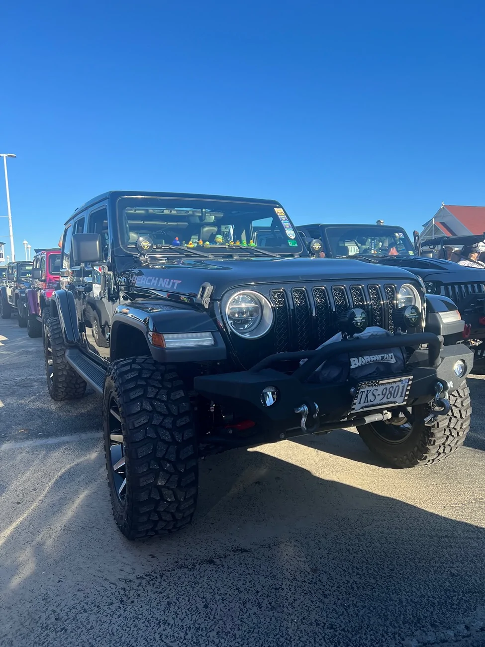

The bumper was super easy…I do however have the LED light package on my Jeep. I have the Volswitch grab handle light controller…THAT was a bear…my winch is direct to battery with a On/Off switch. Wiring is a PITA…and usually takes me hours. I have 2 sets of fog/driving lights, 2 back up lights and rock lights…that’s 4. Why 8? Best of luck with the mods!
Appreciate it. Jeep looks great. Might have been rhetorical but that's me. I'm like, what if I get a 6 and needed 7. I best get 8.
That said, I was given a set of brand new 4" fog/driving lights (forgot to mention originally) I plan to mount on the hood like yours. They are 6 way. So it will take 2 switches to operate. I live out in the stix, literally. Lots of farm land, winding roads, dirt roads, etc.
