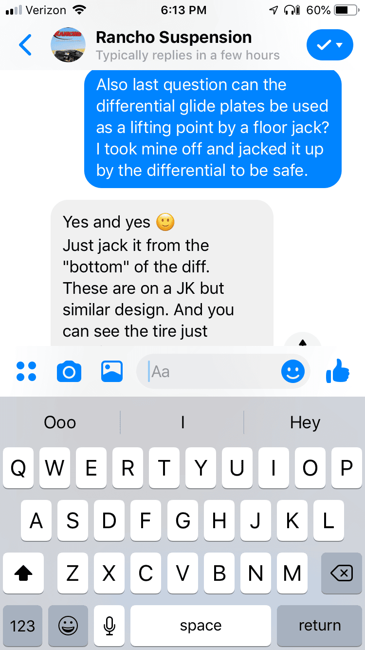

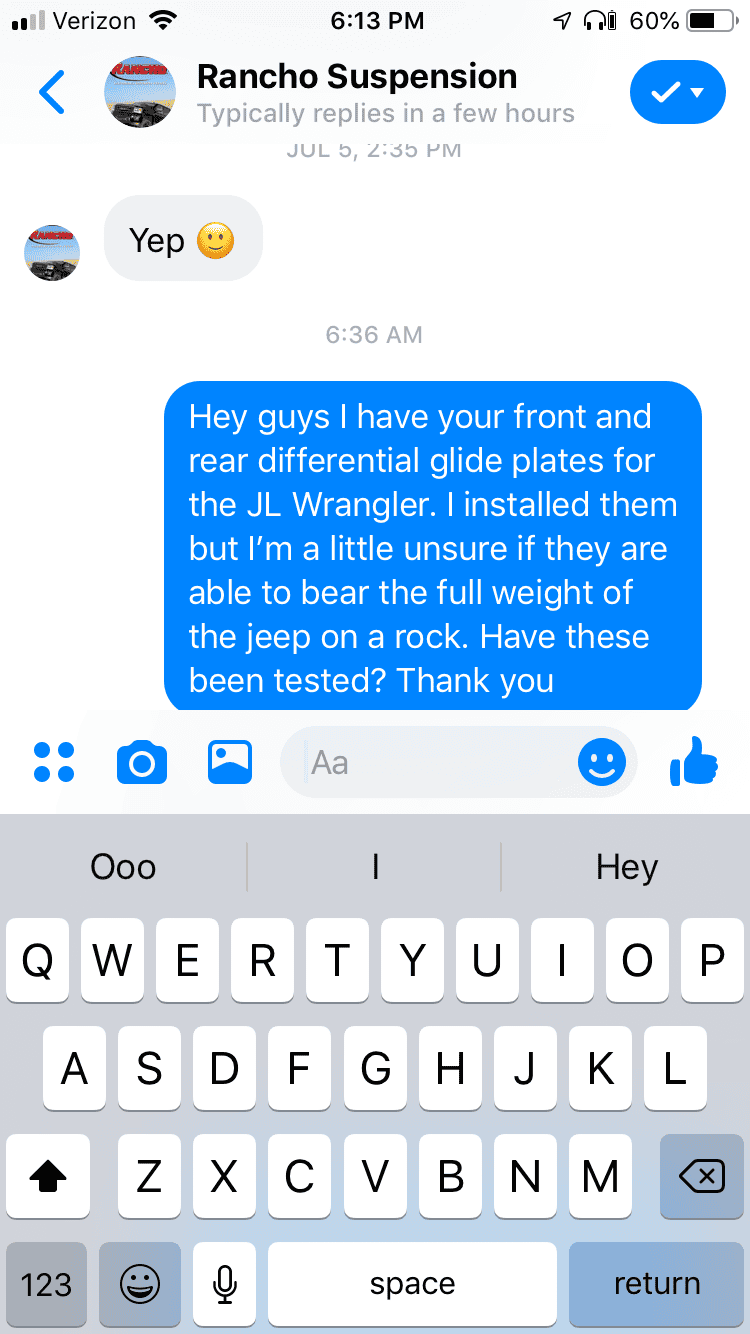

I specifically asked rancho this. They said it can bear the weight of the jeep. And it’s been tested on their jeeps.
I still have the same concerns though given the glide plate doesn’t actually rest on the bottom of the differential. The weight is distributed on the 4- 10.9 grade bolts and three small points where it meets the yoke end of the differential.
