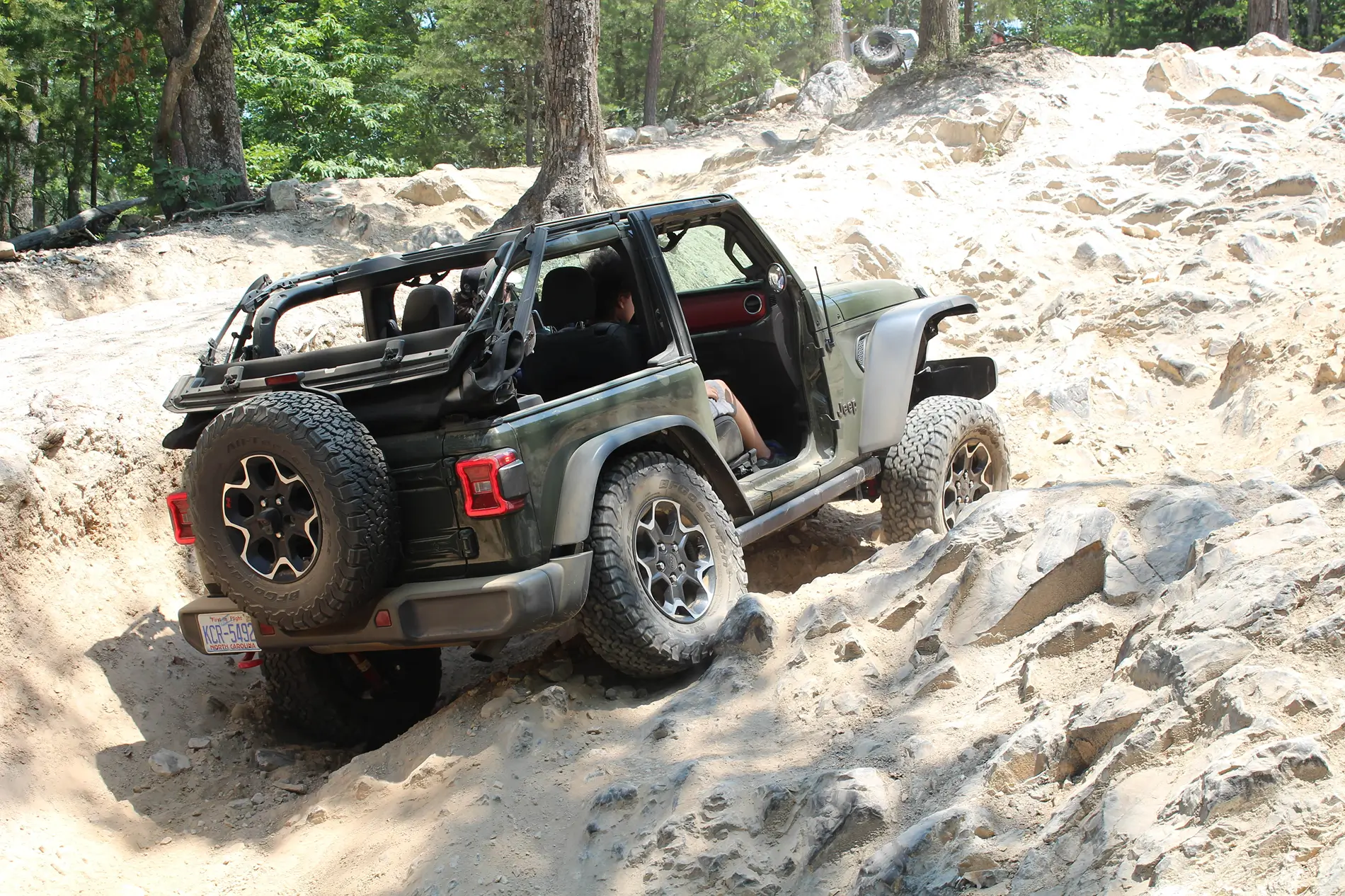

I use 35x11.5r17 Toyos on my 2020 Wrangler Rubicon. They have taken me everywhere effortlessly and do not rub.
I took this photo in the middle of switching from 33s to 35s. You can tell the difference.
Jeep Wrangler JL Question about 35 inch tires and stuff!! i-zrLnHJQ-X2
