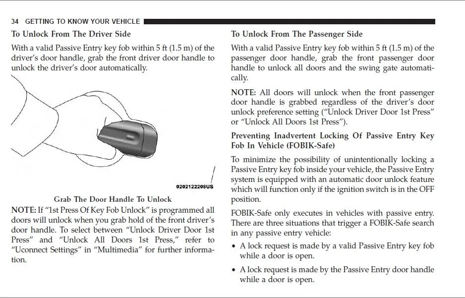

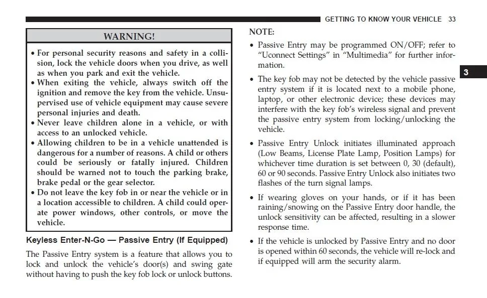

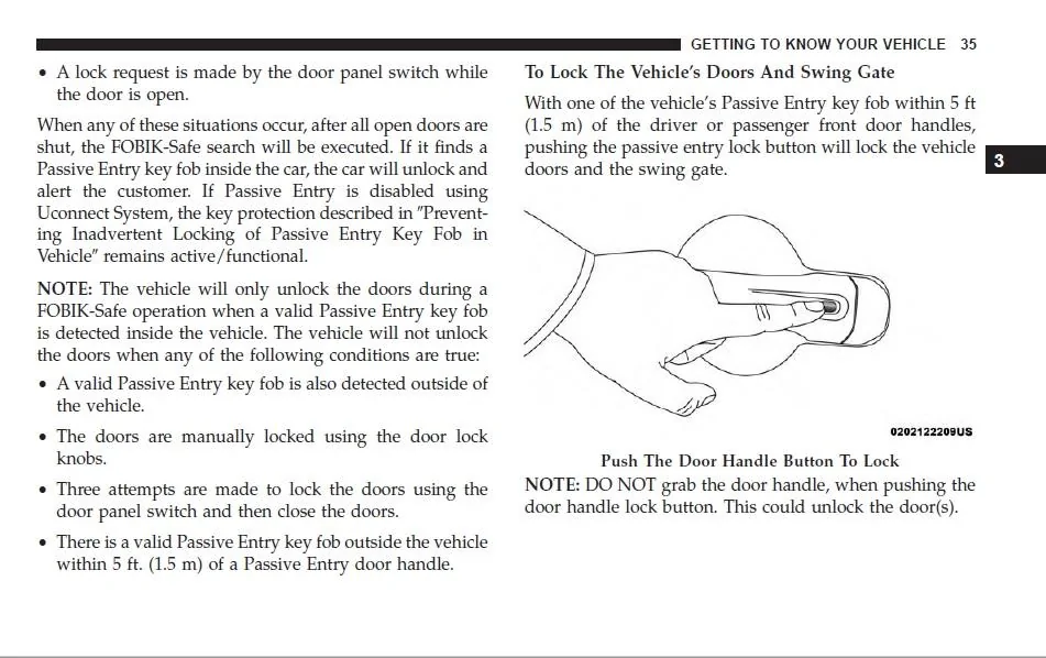

Just thinking will the proximity access be able to be disabled in the Uconnect menu? If you are overlanding or just camping near, or on top of the vehicle the door would unlock if someone grabbed the handle. This would be a potential safety risk… When GM introduce a version of this in the 90s there was a switch on the key fob itself to turn this off I wonder how will this work on the JL.
