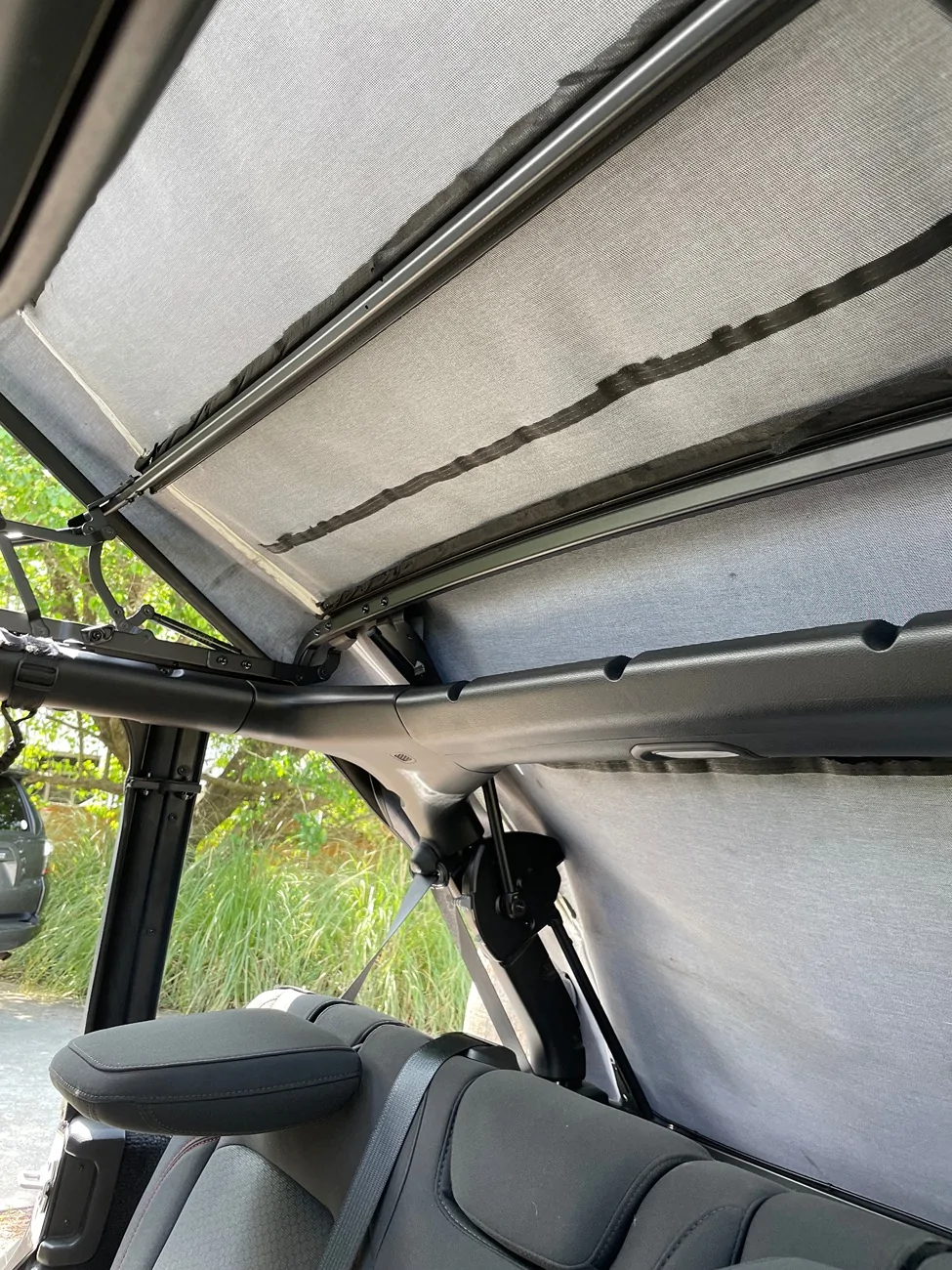

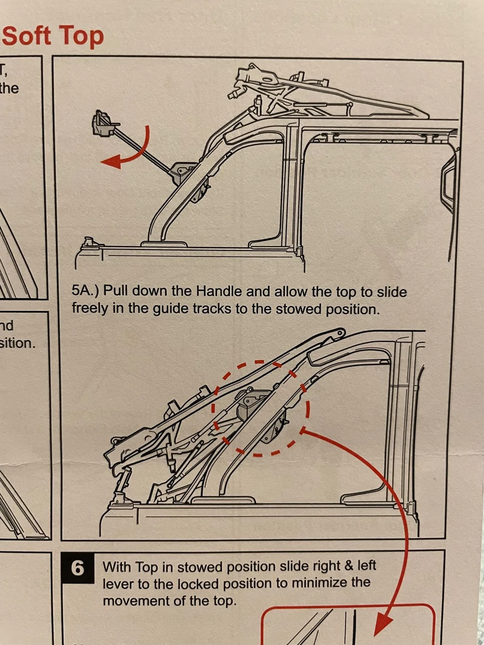

After pulling the lever in step 5A, the frame DOES NOT slide freely in the guide tracks to the stowed position, as it should. Does anyone know why it’s stuck up there?
Jeep Wrangler JL Problem Folding Soft-Top on 4-Door JL IMG_7896

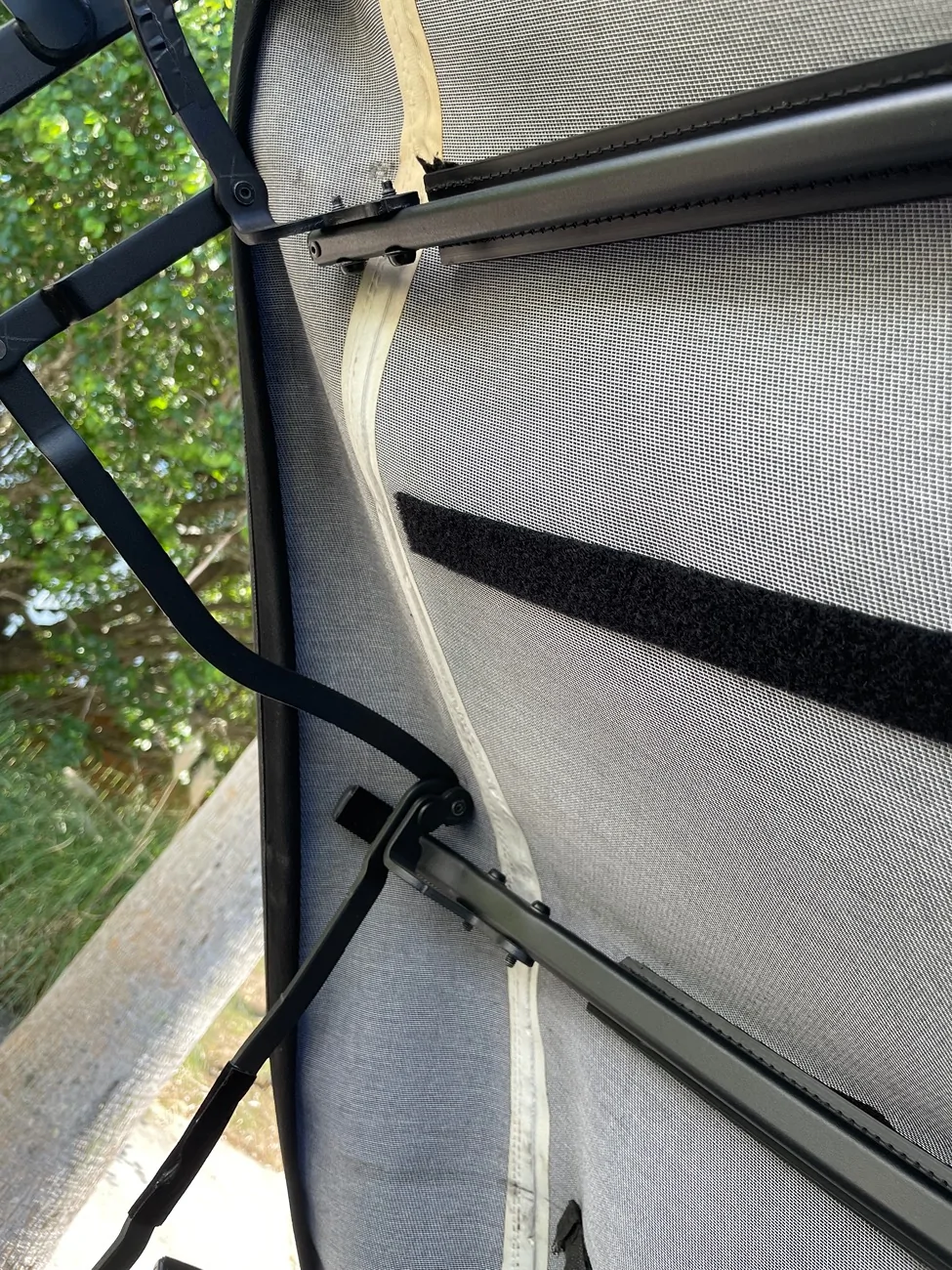

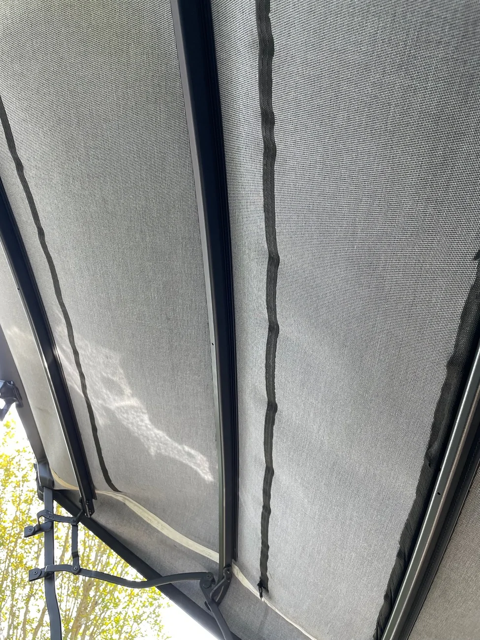

THAT is what is causing this problem.
The bows have torn from the fabric top,
Cheap fabric was between the bows and top fabric, that fabric is so brittle now I can pull it apart with just fingers.

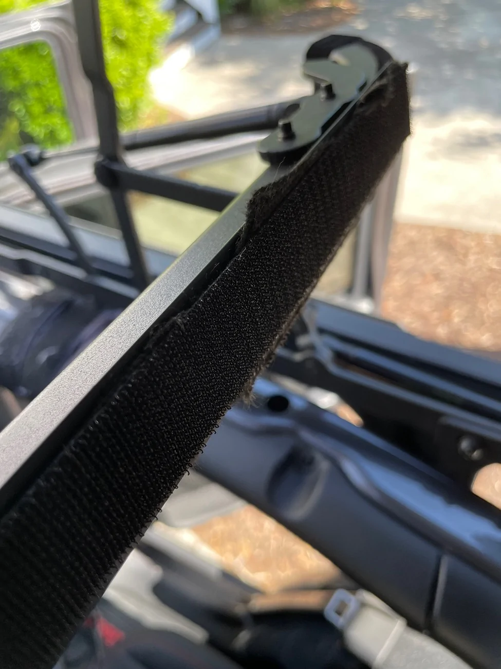

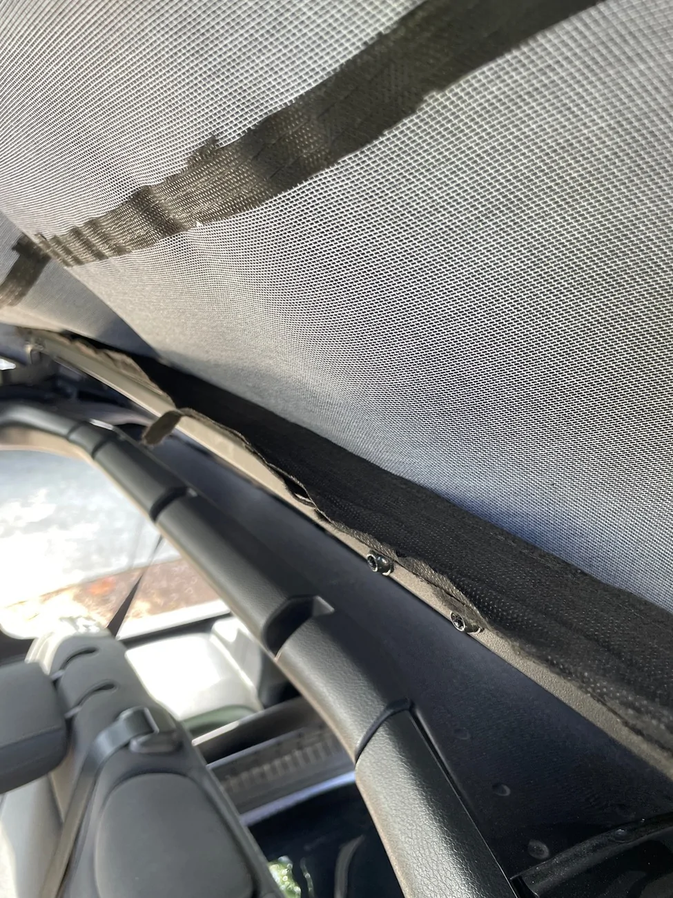

I have secured the top with heavy/duty Velcro. Cut if the torn fabric connector, and replaced with 1 inch Velcro with hook on bows. Holding so far, will update if it fails and k try something else.
