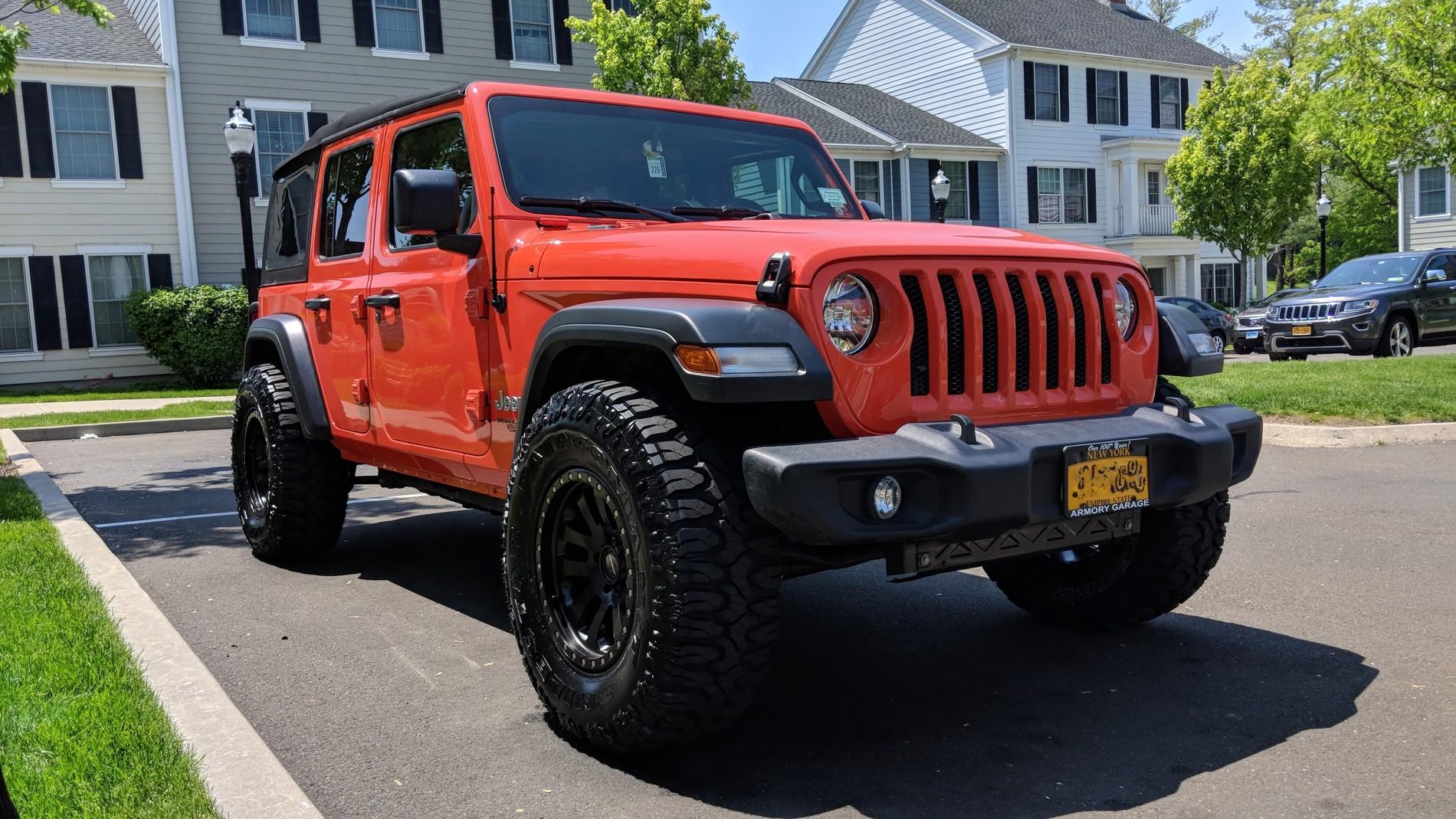

Thanks dude, the predators are 4.75 BS with a 0 offset and 17x8.5, should be about .5 inch less poke

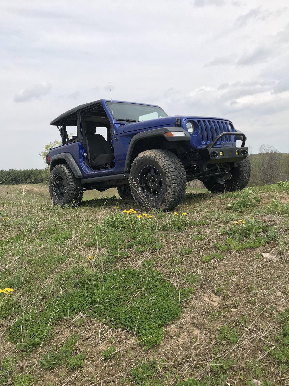

Called the predator i think. They must be discontinued or will be because they keep getting cheaper and cheaper.
17x8.5 0offset 315/70r17
Painted the lip to match jeep
Does your jeep drive closer to stock with the zero offset wheels? Why didnt you go for a -6 or -12 offset other than the poke ? Just curious.

I don’t know what stock feels like anymore haha. Only drove it for 1000km then 35s, then lift a little after then regear after that.
Umm, they were a good price so i got what fit the jeep and they only are offered in that size for jeep. The less backspacing needed the better. -12 puts it further out of the fender, more stress on the driving components etc.
Im on the look for some JK AEV wheels, perfect offset for the JL imo

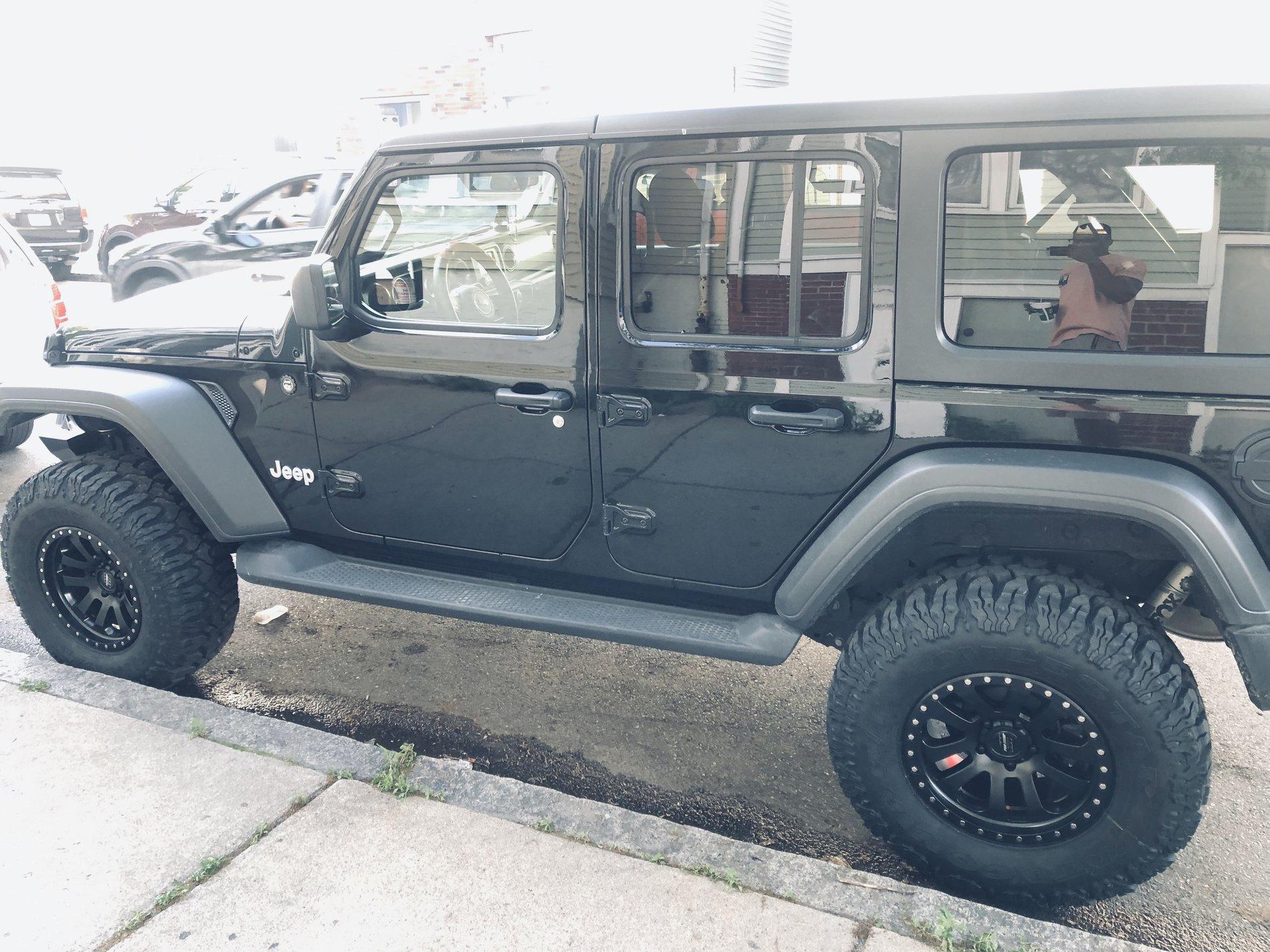

Pro Comp Prodigy Wheels with Milestar Patagonia Tires 315/70r17 - no rubbing without a lift while on terribly paved roads. Will be installing 2.5 inch lift to be able to offroad properly though.
Looking to get the same set up. What offset are these ? Thanks

-6 offset
Im about to pull the trigger on these from 4wheelparts. How is the drive quality? Would you buy them again? Can you post a couple more pics please. Thanks!

I have a few more pics in the garage section of my profile that you can take a look at. I like them a lot! I would absolutely buy them again especially at the price point I got them. Make sure to buy the bolts with the wheels though since the factory ones do not fit. I learned that the hard way and had to wait a few extra days which is no fun.

Finally got a chance to throw these on
