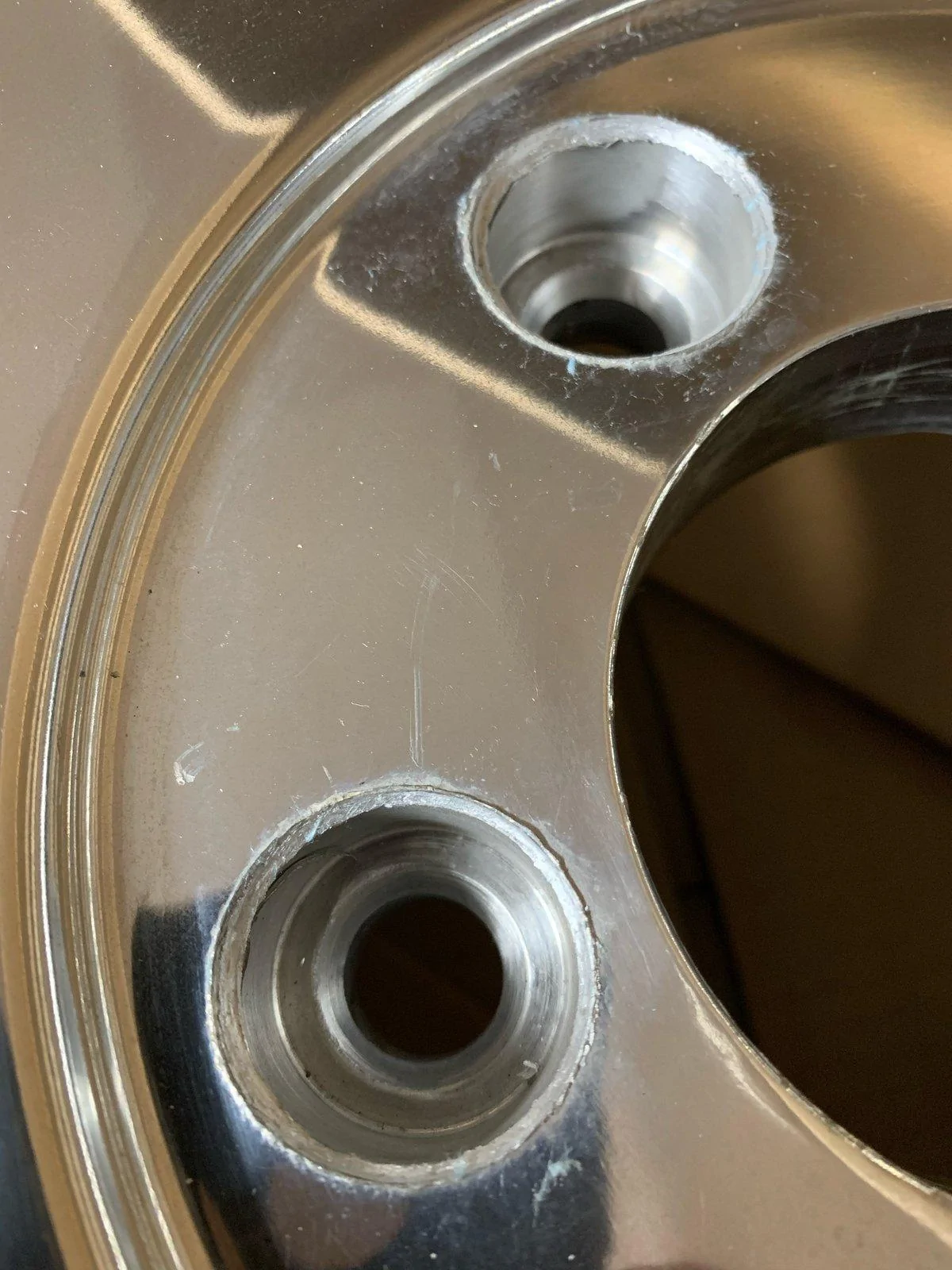

Nope. The stock JL lugs absolutely do not fit. They're too wide. Tore up my rims quite a bit, which is why I went with the quadratec ones.
I had Goodyear put these rims on back in the spring. I had no idea they didn't fit until recently when I took them off to put winter wheels on. I'm actually going to file a claim with Goodyear because they never should've put them on and should've told me I needed different lugs. This was totally unsafe. I'm lucky nothing happened.
Looks like they let the new guy put your wheels on. Sheesh. I’d be surprised if they make it right or didn’t blame you, sadly.

Right. I still can't comprehend how they thought this was ok. The stock lugs were barely holding on.
Yeah, I doubt I'll get any compensation for the rims, but it doesn't hurt to try.
