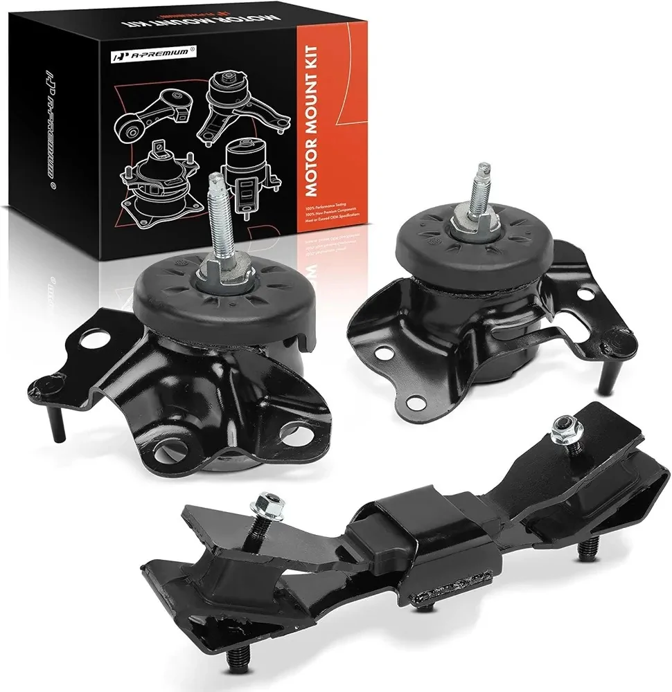

Those are some interesting Engine/Motor Mounts. I've only known hard rubber for engine mounts. Is it a 3.6??

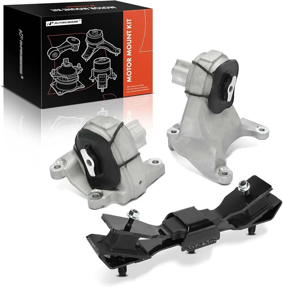

The actual 2021 3.6l mounts look like the 2.0l mounts in your other picture. Oddly enough the AllDataDIY service manual shows this style but mine are definitely the 2.0 style. They have a fluid in them that adds more damping effect but it appears that they are prone to leaking.

Hydraulic engine mounts have been around a long time. The 3.6 has used them since its release. A leak on its own isn’t a major concern if you’re having to pay out of pocket and consider it too big a job to DIY. replace when it wears out.
