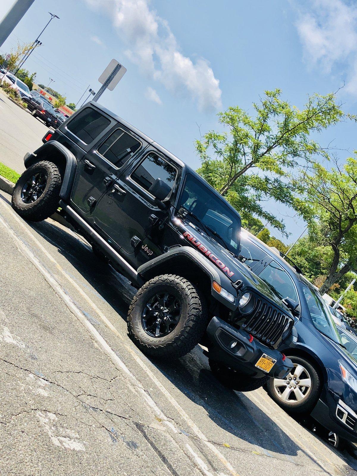

Hey ya’ll,
I just got my rubicon rims powder coated black to match my Jeep. After I got my rims back I noticed the tires and rims wouldn’t stand up straight and when I drove it I noticed alot of wobble. I got it balanced and the guy said either the tires are out of shape or rims are bent. Rims are brand new only a few miles on them. Anyone know what might have happened or how I can fix it?

Many wheel companies do not recommend powder coating alloy wheels. Heat can damage them. Some wheel companies use a lower temp oven when they powder coat wheels which is supposed to be better. It's very possible the aluminum rims got warped if the oven was too hot. Some wheel repair companies can true up and repair wheels, maybe ask them to talk a look. Or it's possible the tires are difficult to balance? Maybe see if you can track down a company that has a Hunter Road Force Elite balancing machine. I'd also ask the company you used if they will cover the damage if it was something they did. Good Luck.

Many wheel companies do not recommend powder coating alloy wheels. Heat can damage them. Some wheel companies use a lower temp oven when they powder coat wheels which is supposed to be better. It's very possible the aluminum rims got warped if the oven was too hot. Some wheel repair companies can true up and repair wheels, maybe ask them to talk a look. Or it's possible the tires are difficult to balance? Maybe see if you can track down a company that has a Hunter Road Force Elite balancing machine. I'd also ask the company you used if they will cover the damage. Good Luck.
Thank you for the advise! I appreciate it!

I am betting it's a tire balance issue. Just make sure the shop has a Hunter Road Force Elite balancing machine. Let us know how things turn out. The wheels look great all black by the way! Good luck.

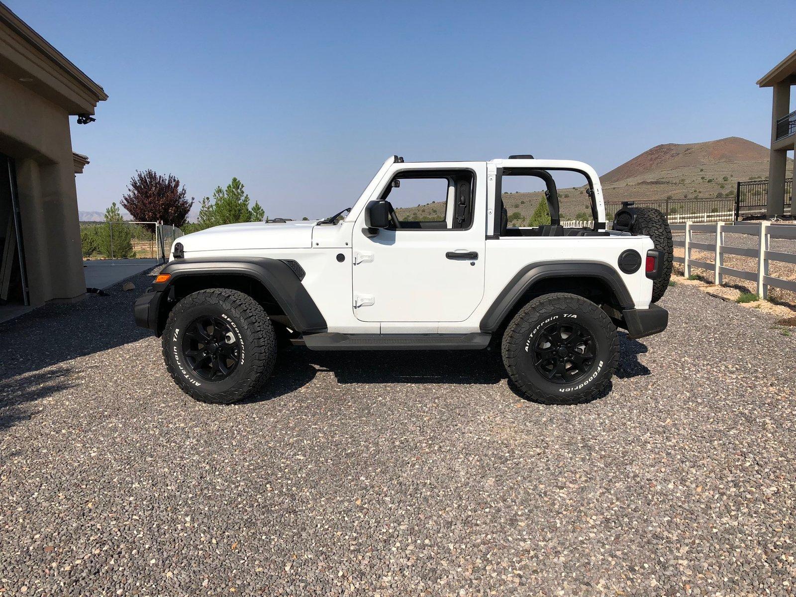

I powder coating mine and have 1,000 miles on them with zero issues.

Good luck and keep us posted! There are a lot of us out here planning to powder coat our Rubicon rims! :)

Looks great, hopefully I can figure out the issue. Right now I have over 9oz in weights on my rims
