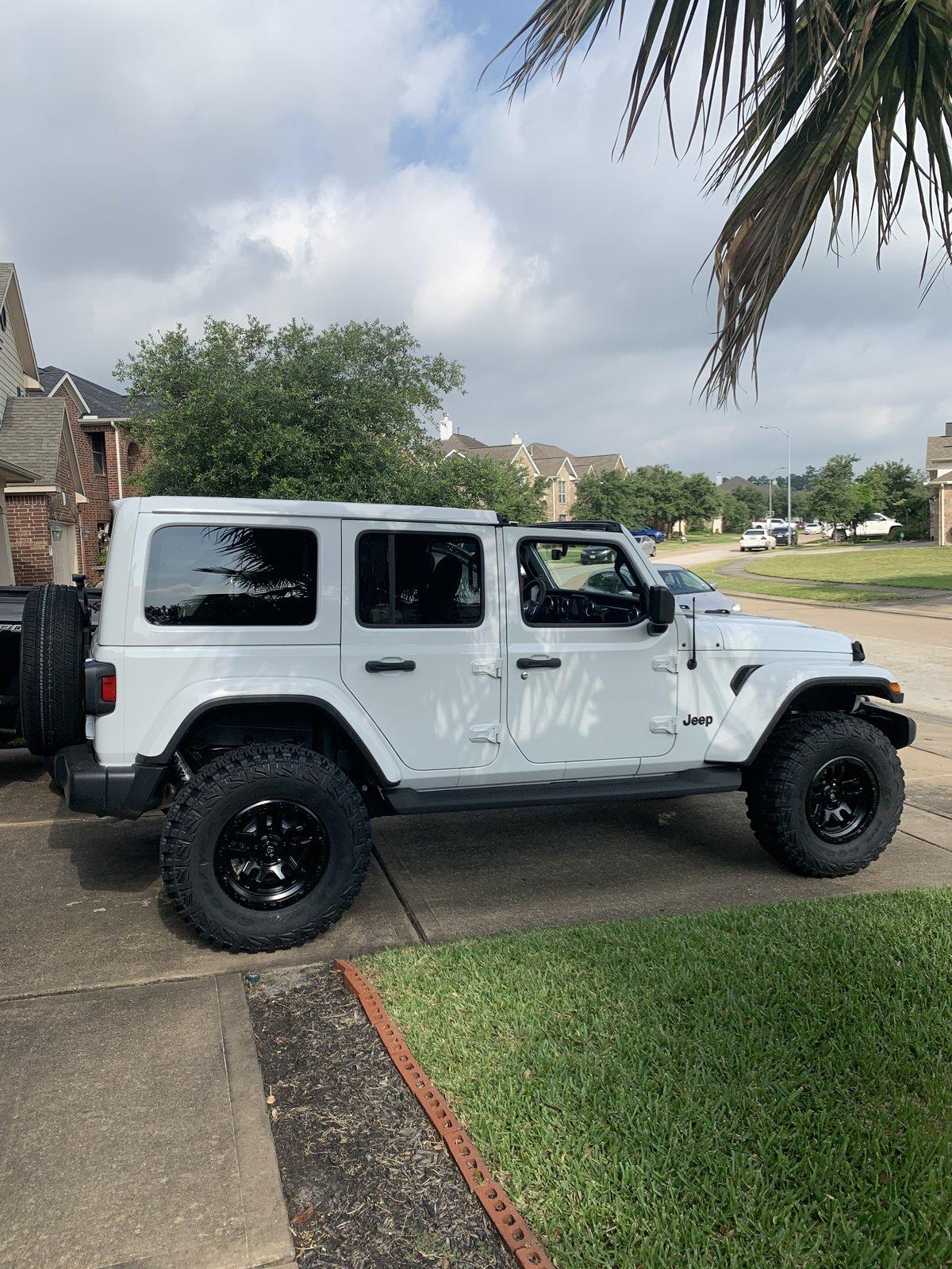

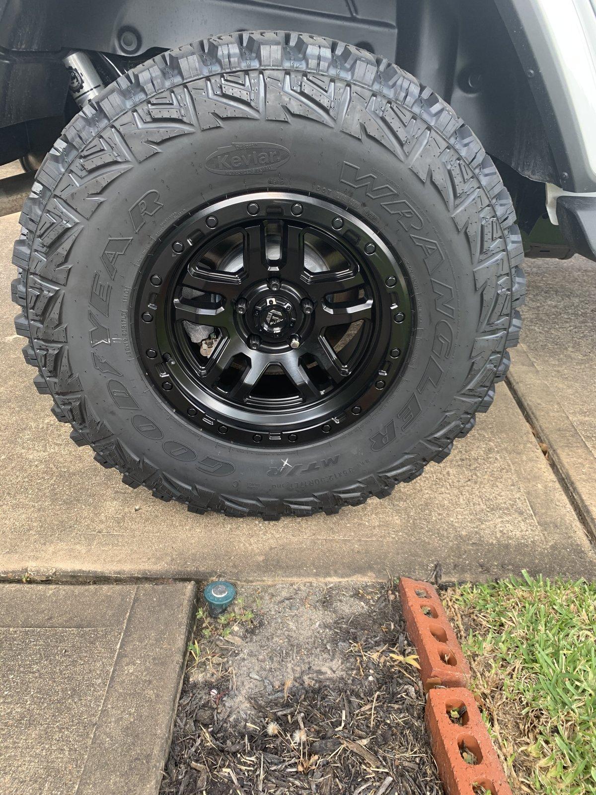

I just put new wheels and tires on my Jeep. I sent a picture to a friend who pointed out the tire says “‘This side inboard” on the outside and explained to me why the tires are mounted incorrectly. I went back to Discount Tire who then said the tires are fine. Are they ok? Are they not? Can someone shed light on this for me? I know nothing about this subject to talk intelligently on it.
Note: the front facing picture is the right side if you are looking directly at it

Ya I need to double check mine but I'm positive it's backwards. It should be the individual lug on the inside chassis side while the longer lug section is aimed outboard

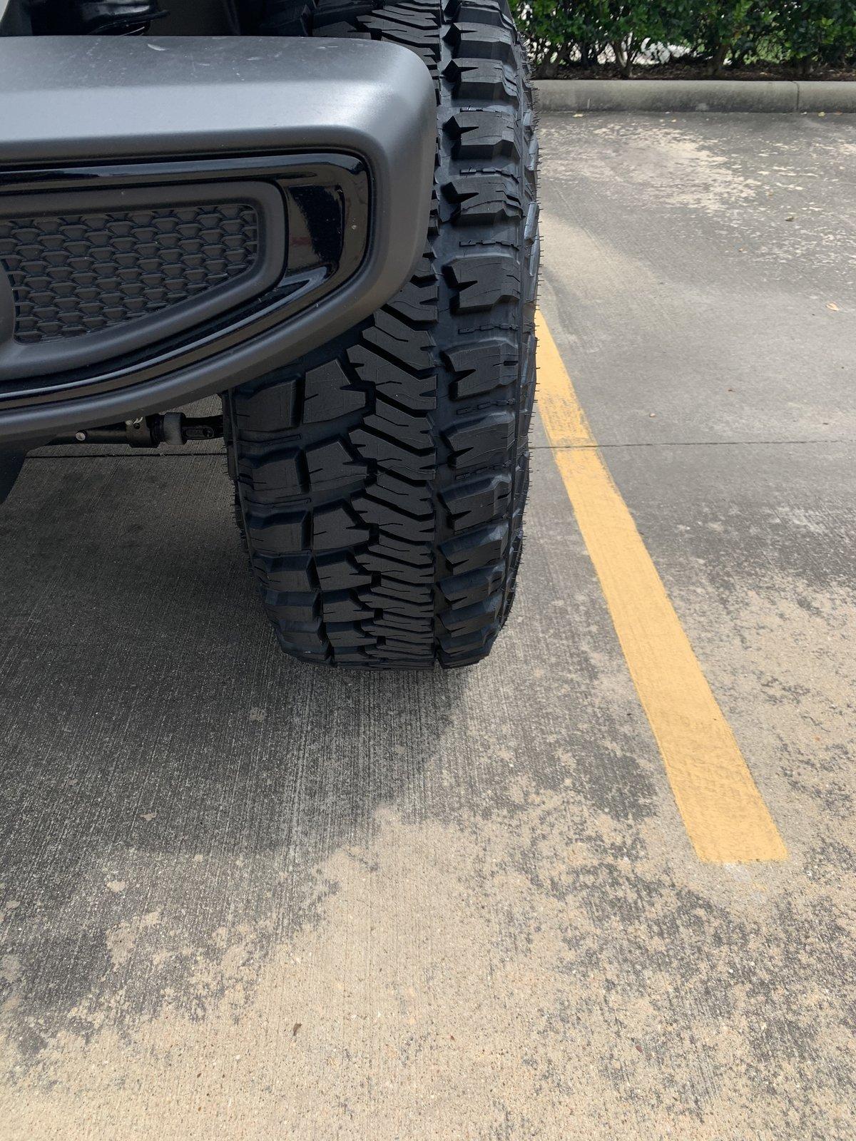

Just by looking at them, the tread blocks look backwards of what i've seen before.
Yup that is opposite of mine. Funny thing is, it clearly states "This side inboard" so I asked why would they put that on the tire if it didn't matter? He didn't really have an answer except for stating that Goodyear is different than all the rest and they do weird things. I was just like oooookay
