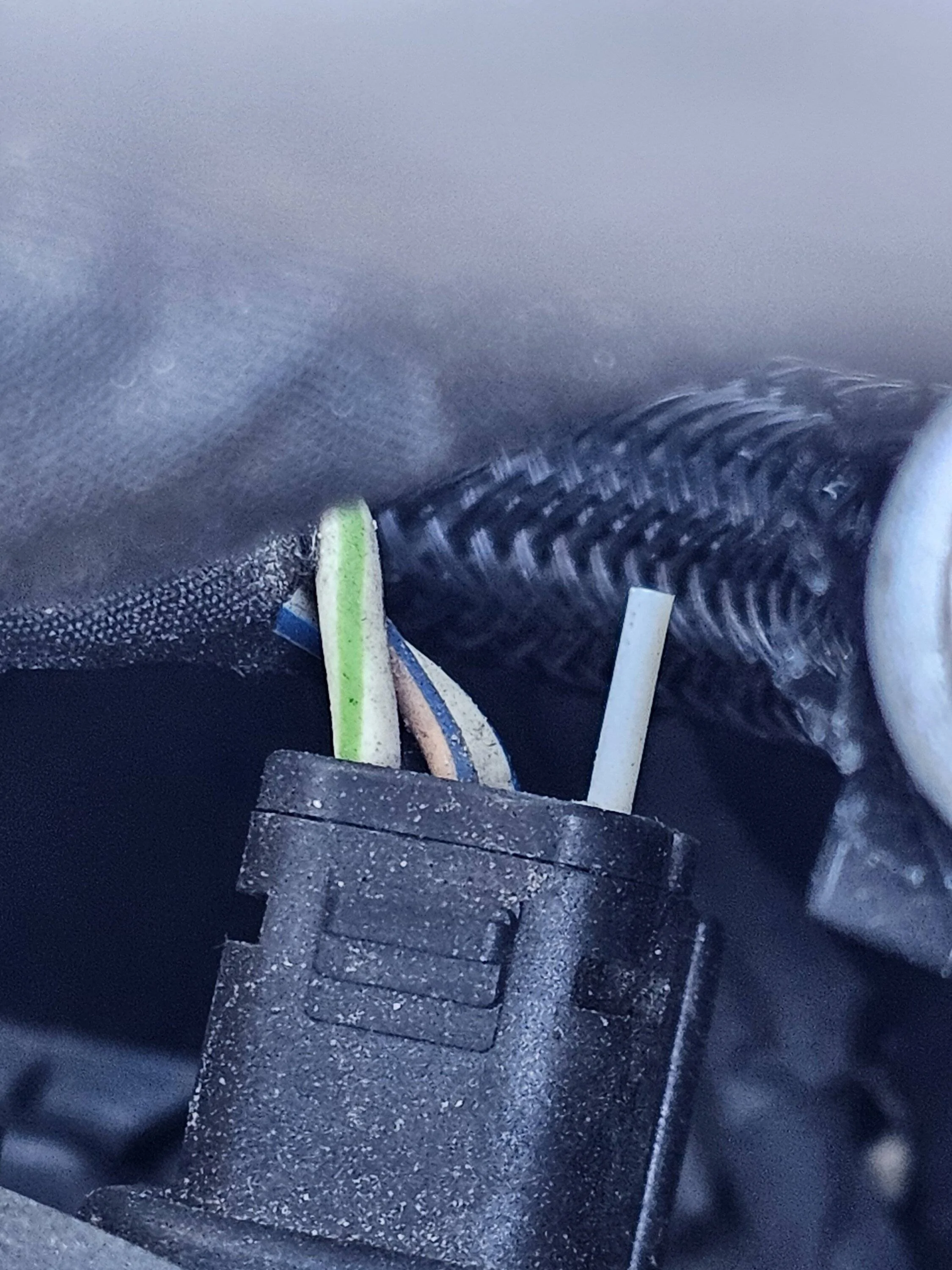

Hi there. I'm hooking up Hella driving lights right now and I noticed this white plastic pin sticking out of the drivers side headlight connector. What is it for, any idea?
Jeep Wrangler JL Plastic pin in the headlight connector. 20241016_144816

They are in a lot of connectors that are below the water fording depth or out of the cabin for weather proofing.

around 2015 + on GM and Chrysler vehicles, they started to pin the empty slots for protection , from weather conditions and etc.
