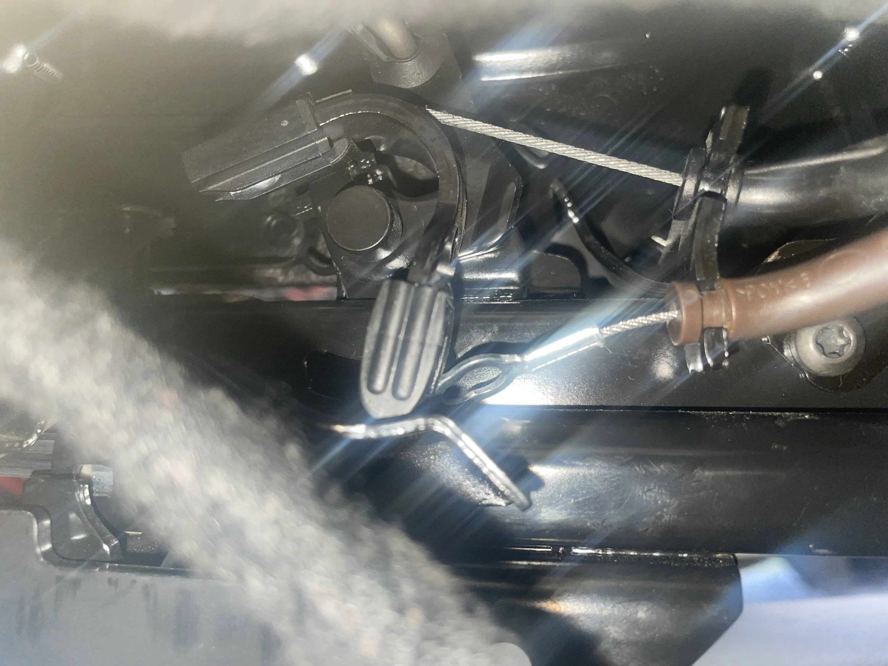

Anyone know where this cable connects to

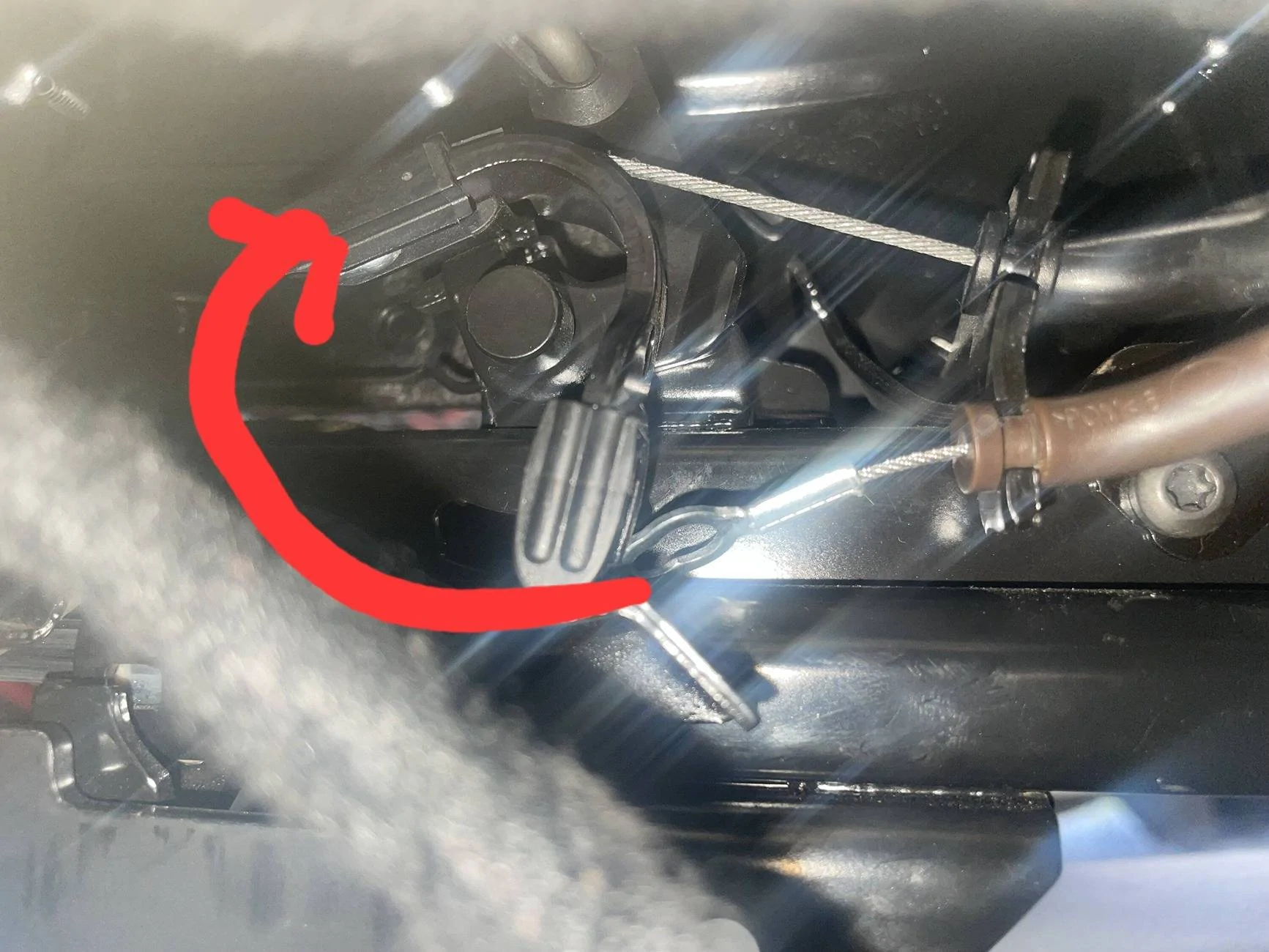

Im just guessing here, do you think maybe it goes in here? 👇

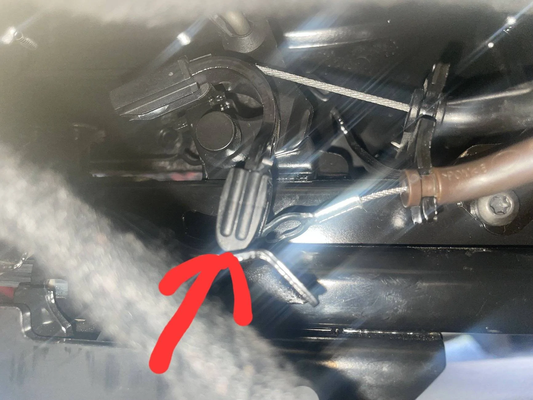

I'm just brainstorming here.
I wonder if that cable wraps under the lower tab and back up to connect with the upper tab. One cable pulls it one way, the other cable pulls it back tbe opposite direction.

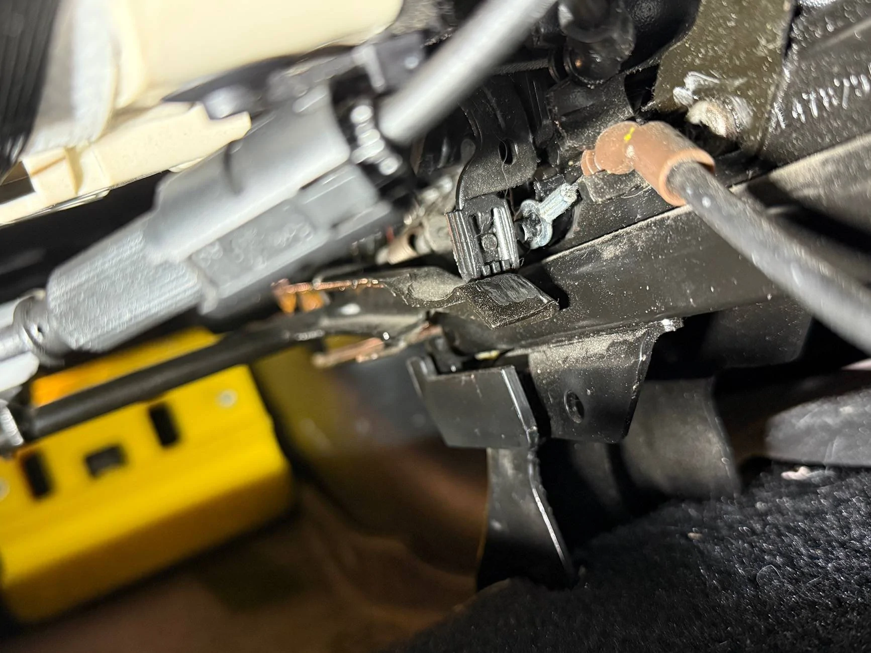

Its tight under there, heres a photo from my manual driver seat but Im not sure this is the same location.
