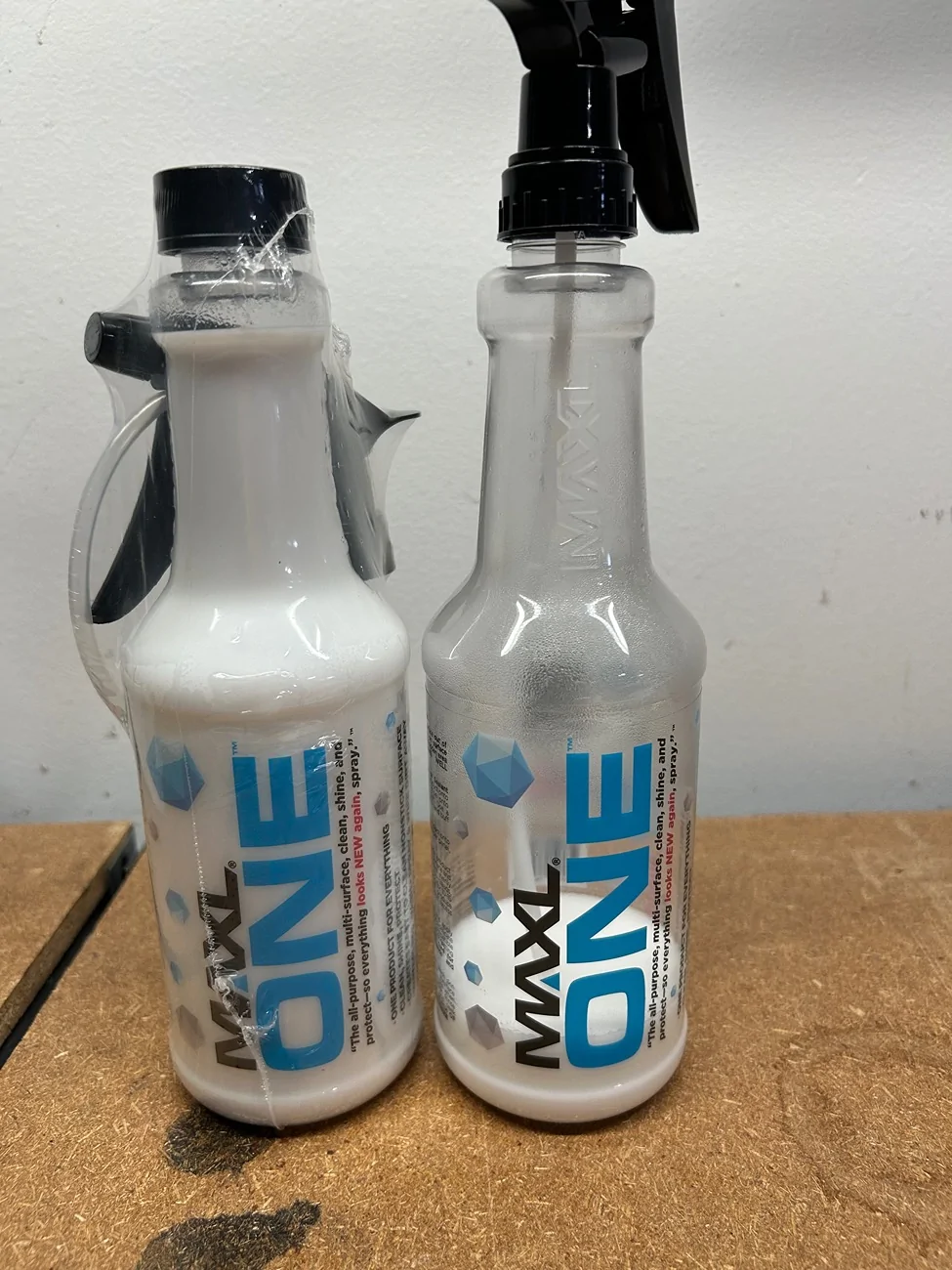

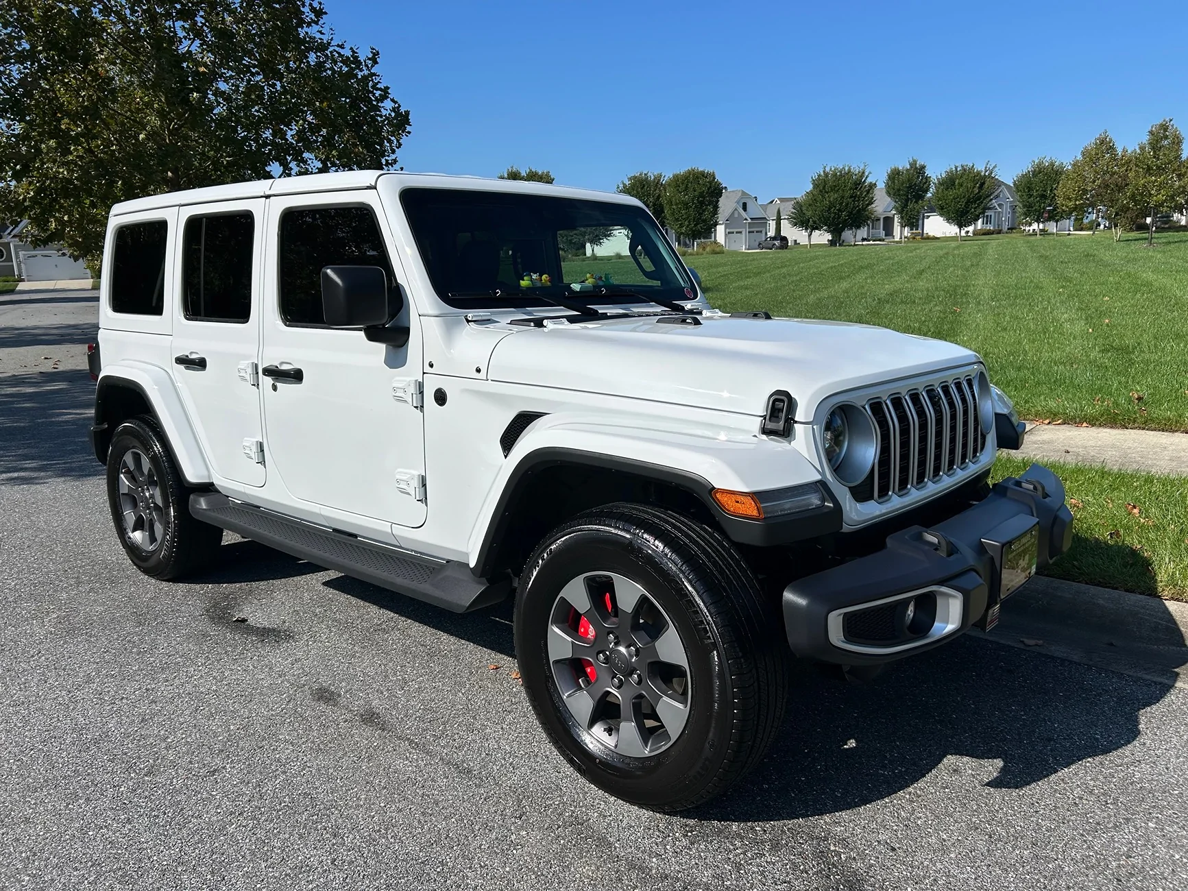

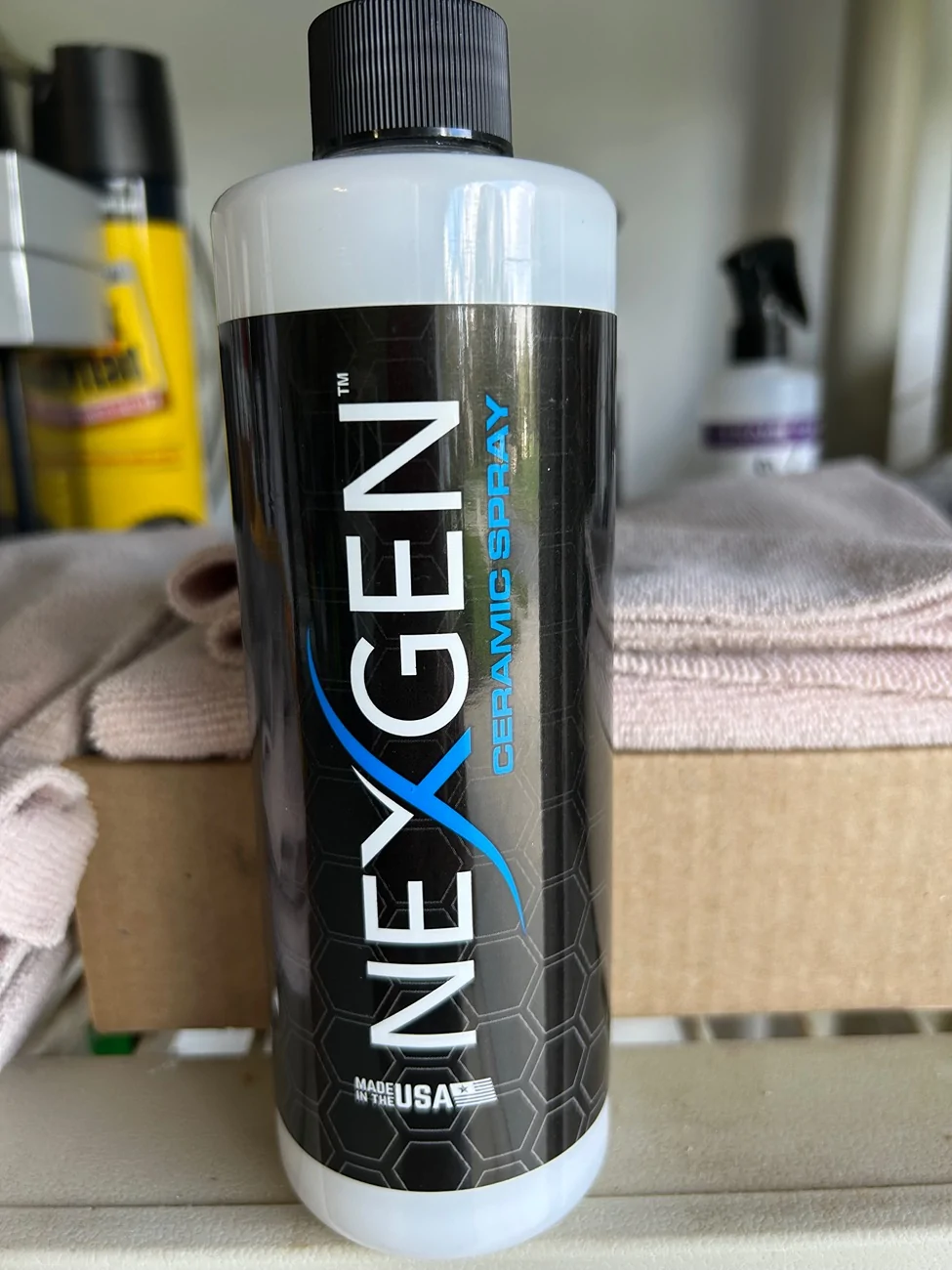

I had good success for years using NexGen ceramic spray. Easy to apply and the protection seemed to last a good 6 months between refresh.

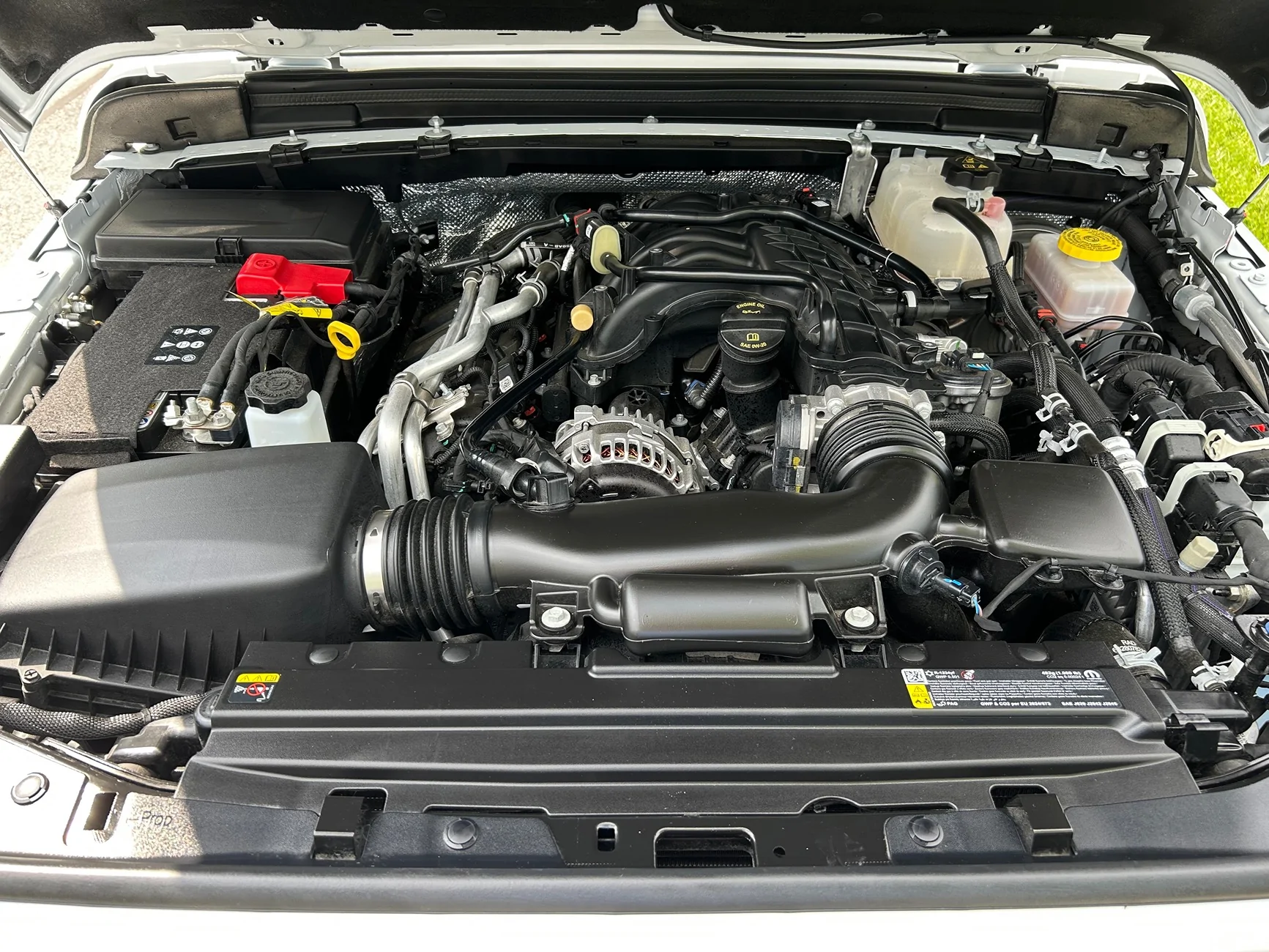

About 9 months ago I started using MaxlONE which like NexGen is a spray on, wipe off product. The difference is that MaxlONE can be used after a car wash without drying the vehicle first. Use it on the paint, glass, rubber, plastic... every surface, and yes even under the hood.
Spray it on, wipe it off, then come back later with a clean dry microfiber and buff of any residual film on the windows and the protection lasts a long time. I even do the door jambs with stay clean in between washes. Im liking this product.

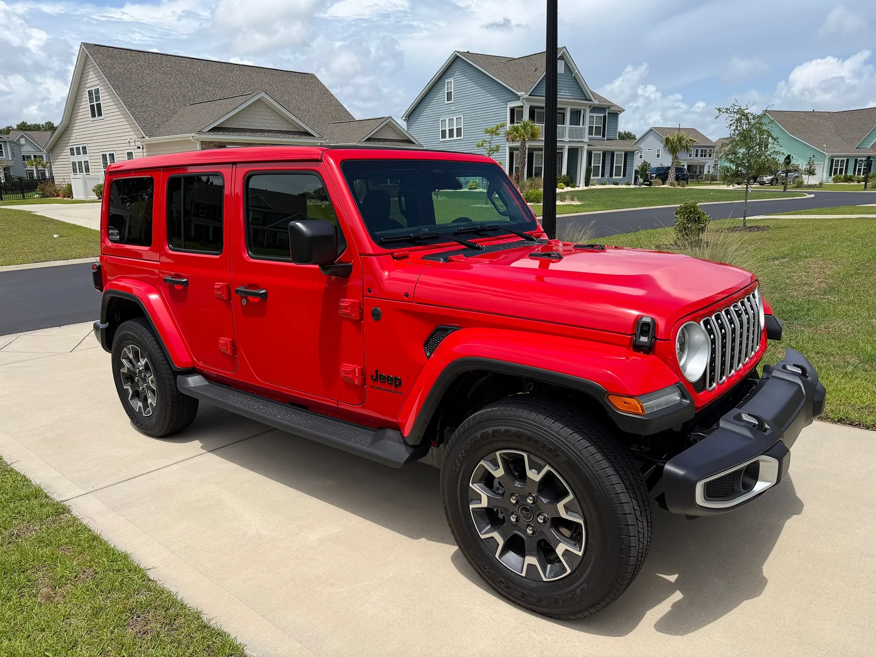

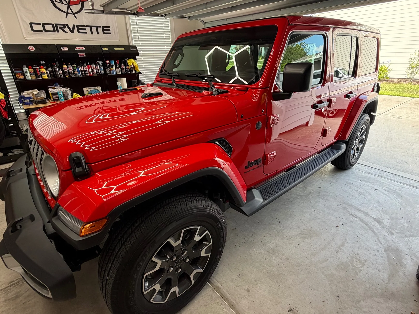

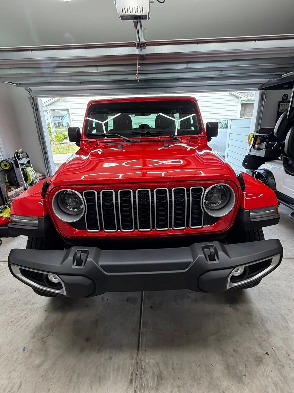

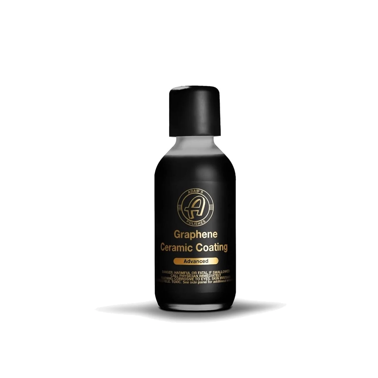

Did my 2026 Sahara with Adams Graphene (not the spray coating) and it came out awesome! Can't believe how the firecracker red shines with this coating! Pretty simple application process as well. You can use this on the bumpers and plastic parts as well.

My paint was in good shape, jeep had 13 miles when I picked it up. I did use Adams car wash/strip wash, light clay bar, one step polish on panels, one final strip wash and wipe down with surface prep then applied the coating. If you don't care about having some light surface scratches or swirls you can skip the polish step but honestly it's better to do it. Either way you need to follow the strip wash, clay, surface prep before applying or risk the coating not lasting. Keep out of car washes as they can cause the coating to fail early as well. It's definitely a whole day or 6-8 hours to do it right but remember how much time you save not waxing your car every 3-4 months.

Holy God that engine bay. I don't think mine looked that clean even new.
