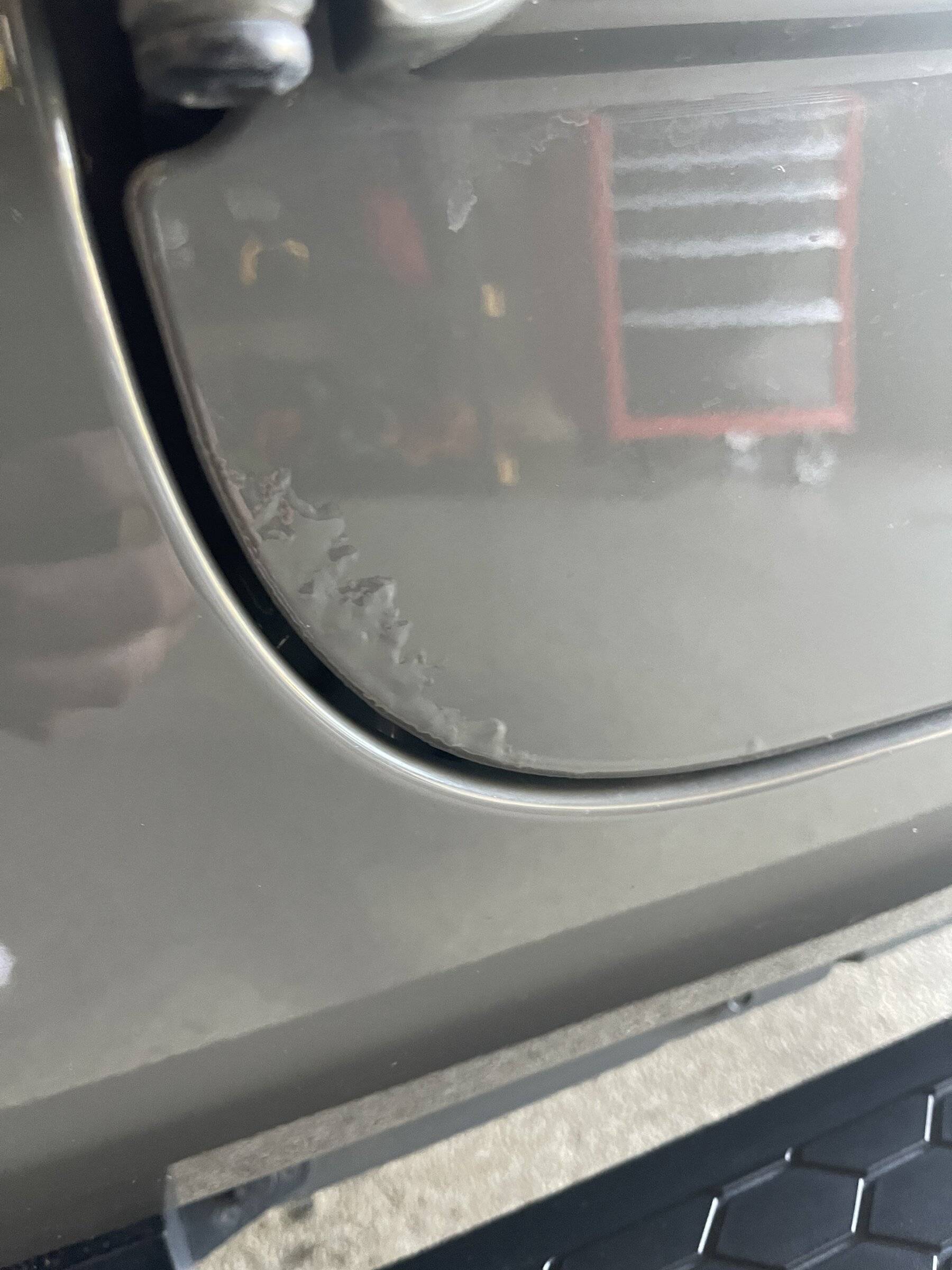

Well it has been confirmed. Dealer& Service Mgr. saw my one (pic) and felt 2 others..... No issues.. Setting it up for (4) doors and surround panels to be painted.. He was well aware and said they have seen too many. Difference between door material and the hinge. (1 week out of service and a loaner).
I was impressed with the dealer I went to the second time. Not only did they look over the spots I found and marked but the service manager went over the whole Jeep himself and logged a couple more spots that I didn't notice.
