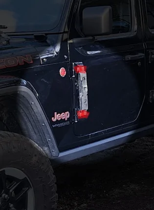

I just purchased a 2021 JLUR and it had these temu special door hinge steps. I got 3 off but the one on drivers side is being difficult. I can get the top 2 loose but the bottom 2 are an issue. One is super tight, and i have yet to try heat and persuasion method. But one of the feels stripped. I am assuming it is a cage nut and was wondering if it is accessible from the inside. I took the door panel off but there is a plastic shield in the way and it holds the door glass regulator. Has anyone else replaced the nuts in the door? I don't want to take the entire thing apart only to be defeated.
