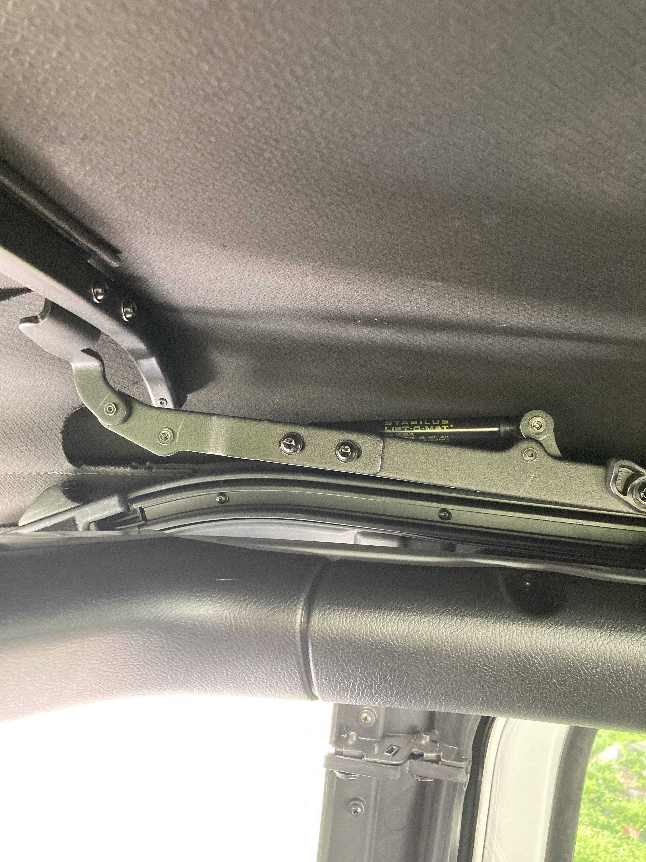

My Soft top adjustment is off a bit such that the Passenger side has a bigger gap compared to the driver’s side and is harder to close. This is worse when it is cold but still is off when it is warm out.
I found that there are some torx bolts on the soft top frame and they allow for adjustment of the frame. The frame is slotted so that there is about a half inch of adjustment room. I was wondering if anyone knew how to set the bolts in the correct position? I couldn’t find anything on the forums about these adjustment bolts.
Pic below to show the bolts I am talking about

Probably want to loosen the pass side and push the bracket back a bit to move the frame forward on that side. I am going to have to check her Trek Top ultra next spring to see if that is on her's. The drivers side latch is not as tight as the pass side on hers. Thanks for sending the pic.

Yeah I ended up doing that and it worked well. I adjusted the drivers side a bit too.
