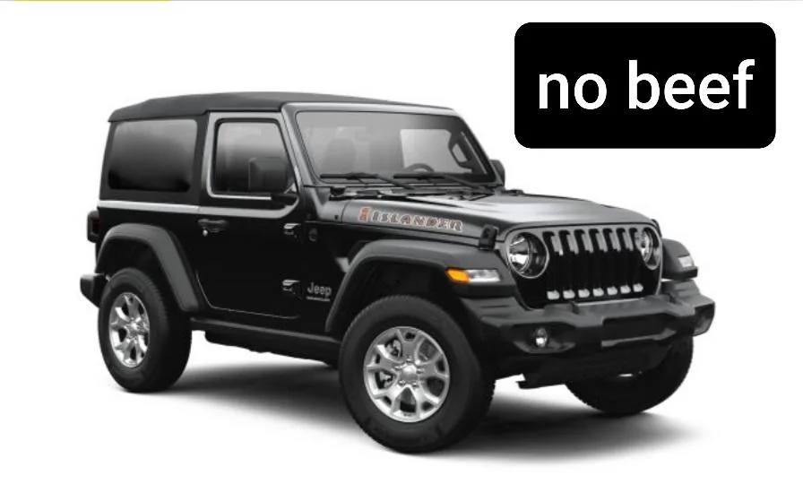

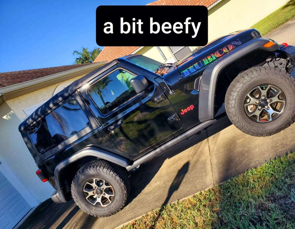

In theory I would like to start beginner off roading... trails. But this will be wrangler #8 for me and my off roading experience consists of the beach and cutting traffic over curbs and medians... I have/had rubicons, recons, and saharas so far. In my mind, I just like the dana rear ends ect that I can get on the rubicon. If Im buying a jeep, I want it to atleast be able to do light off road ( or get out of a sticky beach situation ) if I want to. I wont add a winch, I have no reason to. I have gone down the path with lifts and 37s on a 2018 jlu rubi, but the steering ( no matter what I did to help it ) was the reason I traded it in for my 2020 jl, so Im not doing anymore lift kits. My current rubi has the best steering I have ever had! All I want from the islander, is the seats, non red dash ( im so over the red dash ) and islander package of goodies. I dont really want to start a tear down as soon as I get the new jeep and if Im going to be handling the customizing, then I rather start w the rubi and just switch out the seats and dash but I doubt these parts will be available alone. As I said, I have a 2020 jl black rubi, ( I havent even changed out the wheels/tires ) so ordering the exact same thing but with half doors seems pointless. I am getting another jeep bc Im giving my current one to my daughter when she turns 15 and she likes the set up as is...
So I guess...
1. I keep my rubi, do not give it to daughter, and hope to buy islander seats and half doors and dash - then switch them out with my rubicon parts. ( And then buy girlie her own new jeep which will be a black rubi, so maybe I could steal her half doors if possible).
2. Order me a rubi, but still have to switch it all out to an islander
Either way I cant order it exactly as I want from jeep... atleast thats what I'm being told and the islander stuff and half doors arent available for purchase.
Whatever happened to ordering a jeep completely custom, and not being stuck with model limitations????
Thanks for any recommendations!

Fantastic post @Jjirish !
Most people don't understand how capable a Sport Wrangler is off road, you definitely don't need a Rubicon for what you plan to do.
I suggest you order your black 2-door Islander with whatever options you like, plus the following:
Anti-spin rear differential
Trailer Tow and HD Electrical
Islander plus package (gotta' have the Tiki Bob tire cover!)
The anti-spin rear axle will be a big help in the sand and on easy-moderate trails. This is similar in strength to the Rubicon rear axle, but is not as good on hard trails.
The trailer tow package provides an easy upgrade path if you find you need more traction. You can order a set of Rubicon axles and use two of the Aux buttons to control them. Not as seamless as a Rubicon and won't have the swaybar disconnect, but this will future proof your Islander.
If it were my Jeep I would do the following modifications:
1) Get Rubicon size tires (285/70R17), this will help you "float" on the sand. Still need to air down.
2) Keep an eye out for a set of Rubicon springs/shocks from a 2-door soft top. This will make it look "right" but not cause the steering issues you had before.
