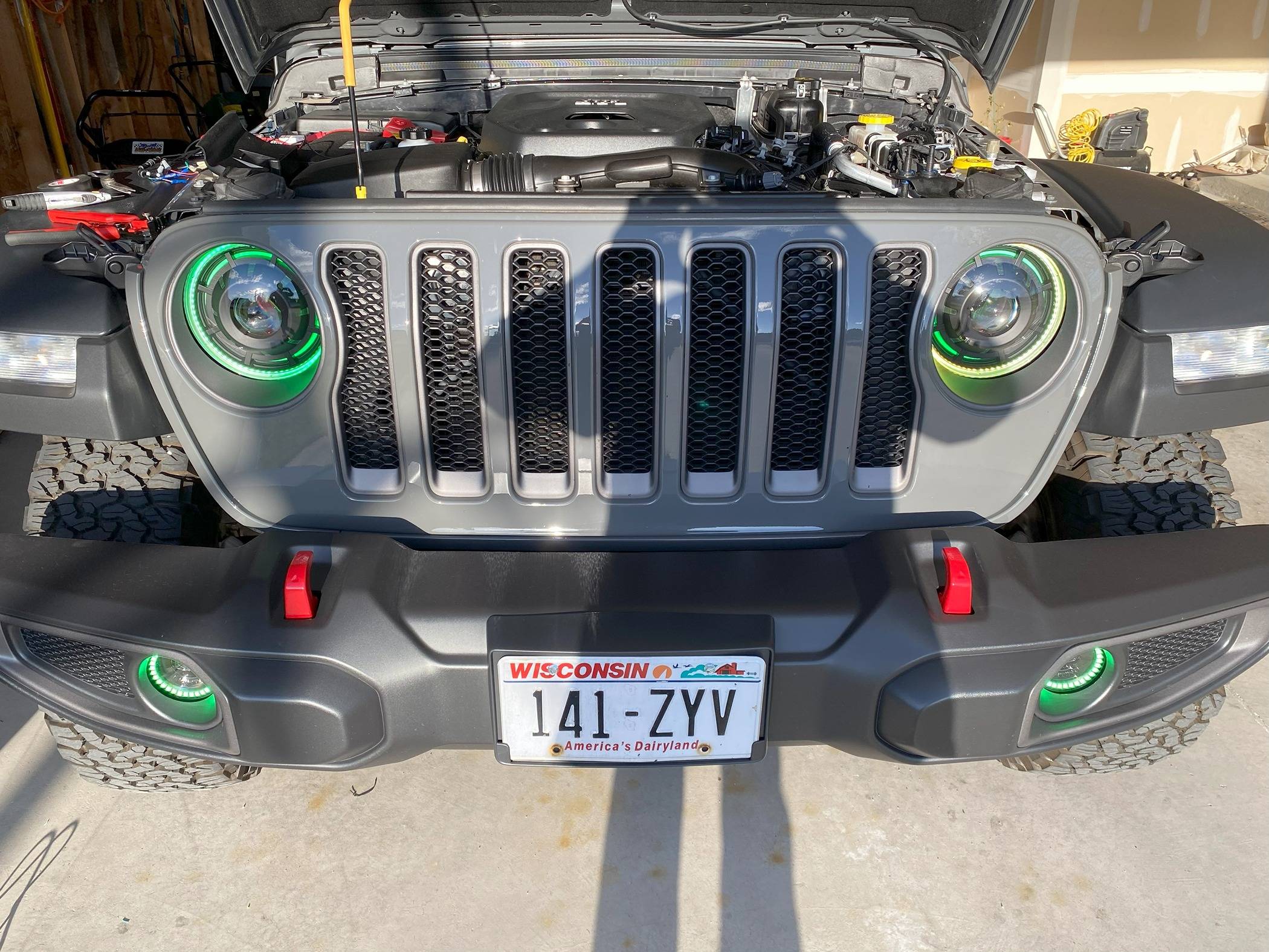

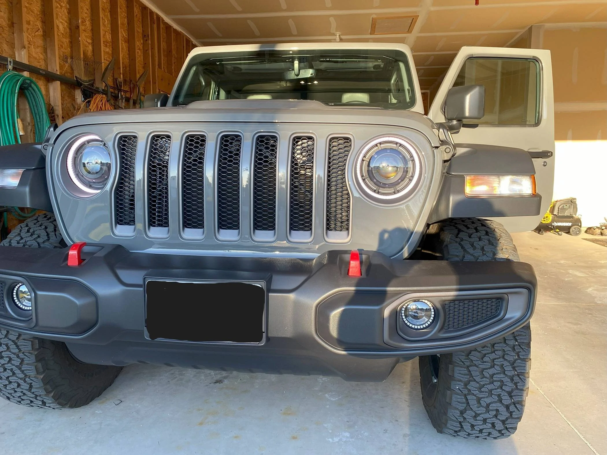

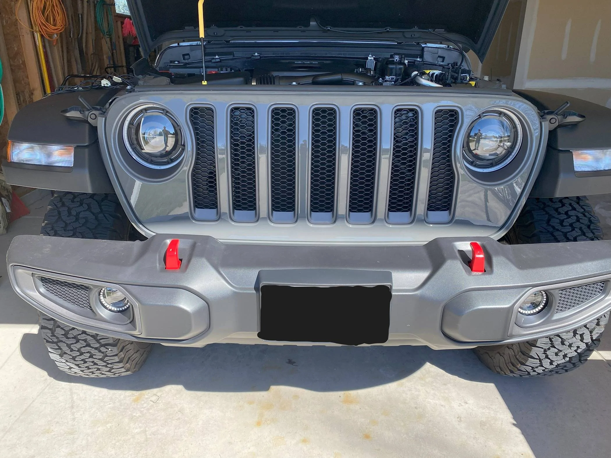

Got'em in. Was more an all day thing, but I tend to work slow.....and there's a LOT of wires to strip and connect. Still working out some kinks with the ColorShift part. One of the BC-1's just showed a broken link in the app and blew the fuse. Haven't had time to get a new one yet. Hoping it's not defective. Will post more picks once that's up and running. Now I need to replace the bulbs in the fenders with LED's so they match the intensity of the halo's. Pleased with the light output at night. I have basic Quadratec LED headlights in my 2010 and these are definitely an upgrade from that. My only disappointment would be if I can't get the ColorShift part to work correctly.

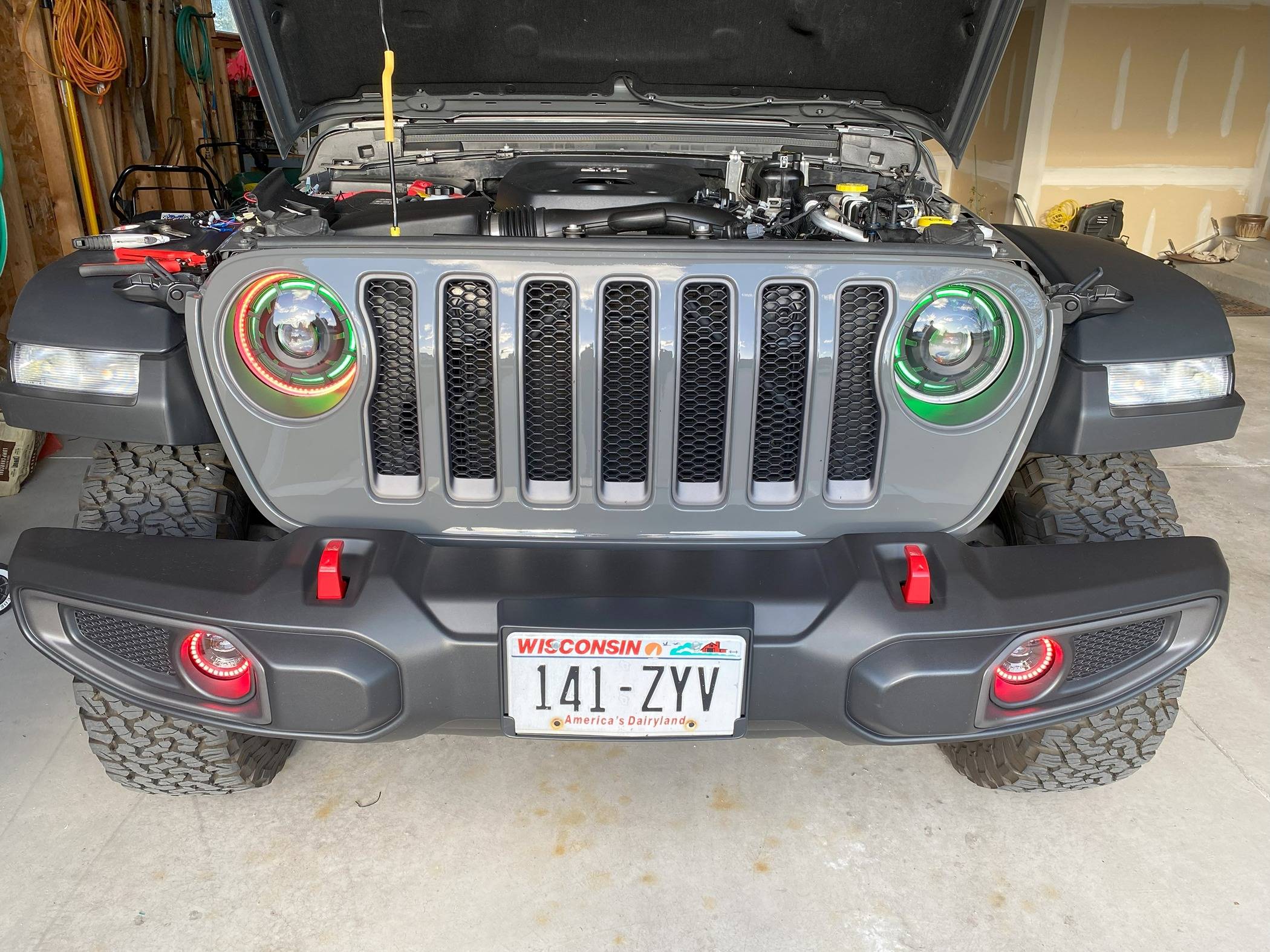

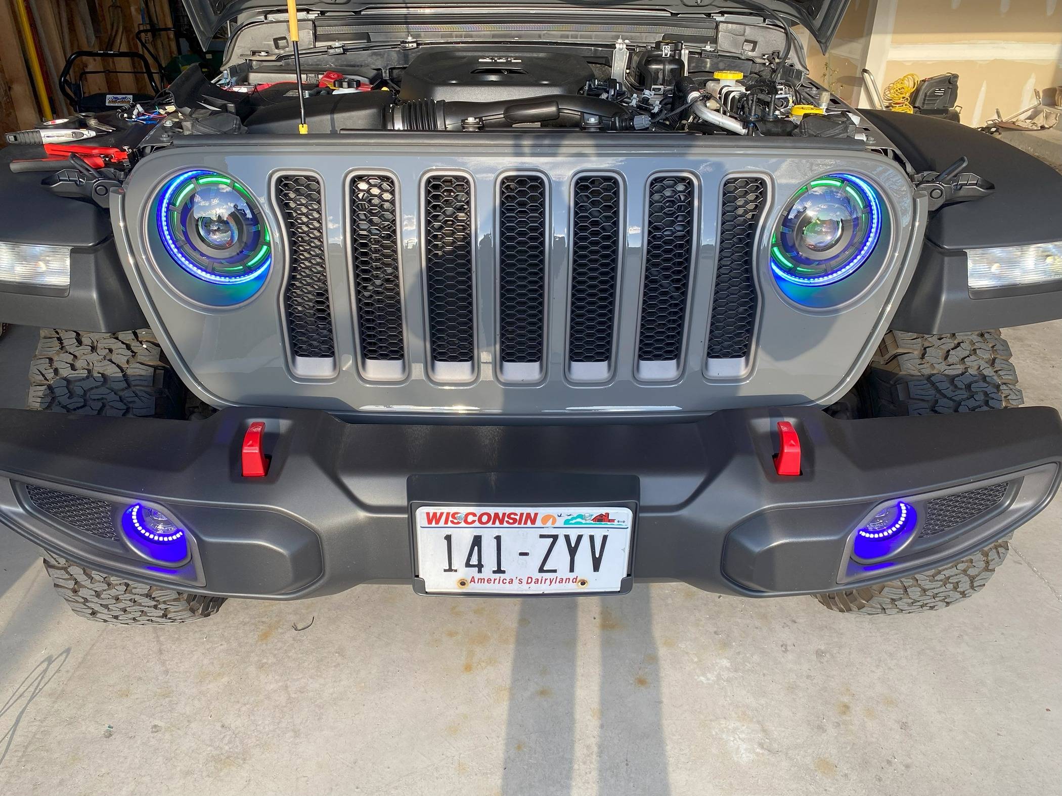

Welp - got my last bc-1 and wired it all up. Looks really great but I think the RED LED on the driver's side outer halo is defective. I swapped controllers and cables and narrowed it down to that being the only possibility. all the others show red but as soon as I connect the red to red wires for that headlight they all change to yellow. See first and third photo. Contacting Oracle for a solution.
