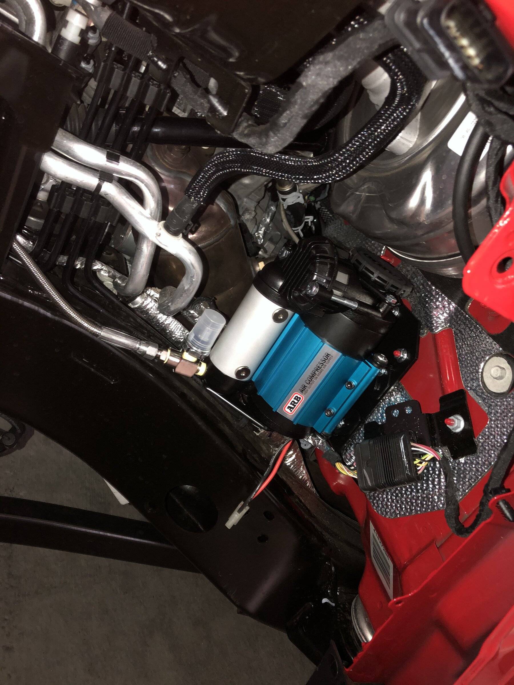

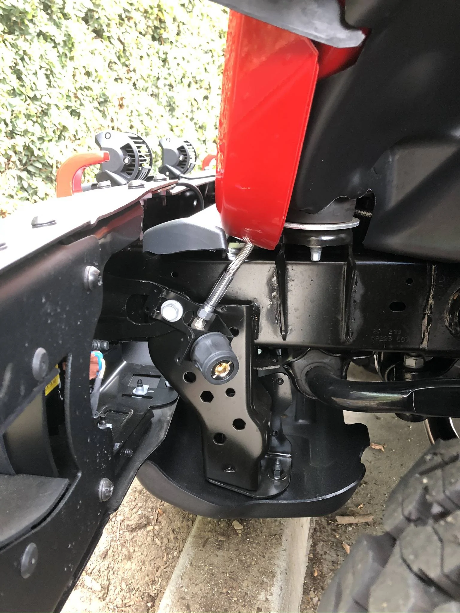

If you don’t need the dual, the single arb mounts behind the driver front fender under the brake booster with a simple bracket, in a place that seems like it was meant for it. I extended the connector so I plug my air hose behind my bumper. I also got a rubber cover made by arb for the quick connect after these photos were taken since these shots are over a year old. I’ll post a current photo in a bit.
i’ve had it for about 15 months and use it regularly and I’ve had no issues yet.

I mounted mine under the hood. It is under the brake booster and then plumbed the air outlet to the front bumper. I ran the air inlet up to the top of the engine compartment.
It was a no go for me to mount it inside the jeep. My wife sits in there while I air up and did not want her to have to listen to it run.

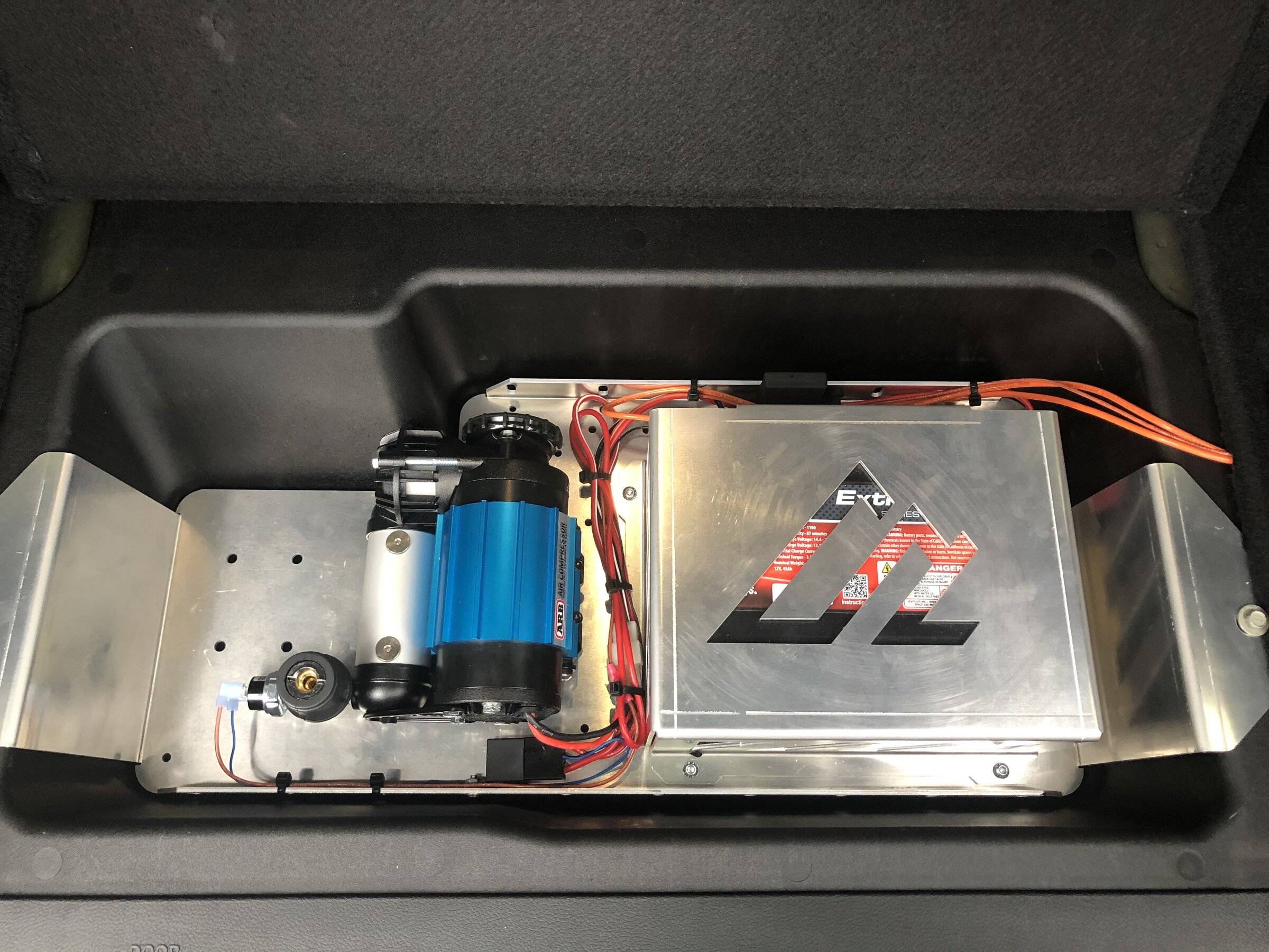

ARB Single with Aux Battery.
